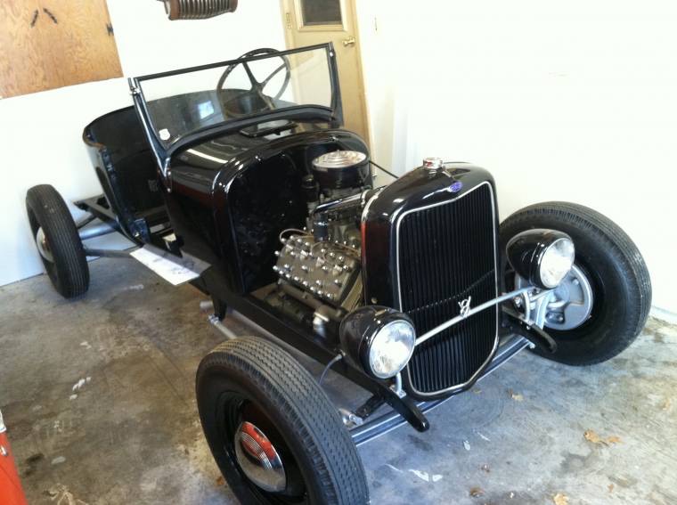

    This 27 is built on a pretty much stock A frame. How close is this to what you want as far as frame/body esthetics? KISS seems like a good plan to me. Buy a stock mint frame and you are half way there.

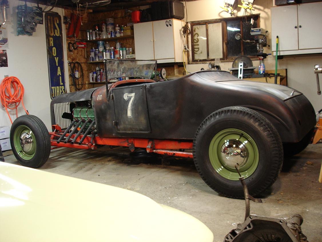

    I guess I could just put it on the real nice stock Model A frame I've got sittin in the corner like this T roadster is...

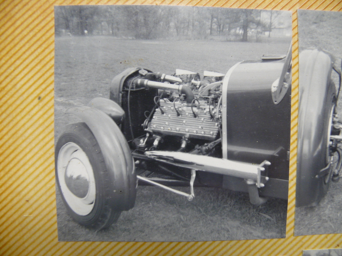

    Larry, I didn't read through your entire thread on the history and finding and purchasing the car. So, even though the frame is gone I don't know if anybody knows exactly how the frame was constructed.
    But by looking at this photo, it looks like maybe an entire Model 'A' frame was used front to rear with some modifications made to fit the 'T', and maybe the portion of the 'frame' that follows the contour of the body is just more of a separate piece welded onto the sides of the 'A' frame rails.
    You could have a simple 'A' frame built to fit your needs. That would be much quicker and cheaper than a one-off custom frame. Then, mount the body & bed and have a thinner gauge (easier to bend) sheet metal 'cap' made to match your body. Have it welded on and blend the welds where it shows, and you'd have exactly (in appearance) what the original Hot Rod had.

    The frame on this T on an A frame, is among other things Z'ed in the rear. Deuce frame rails would not require a Z......just saying.
