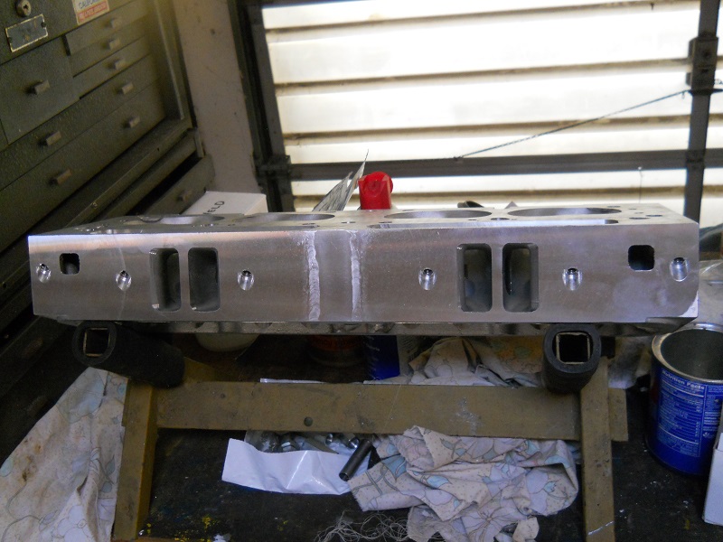

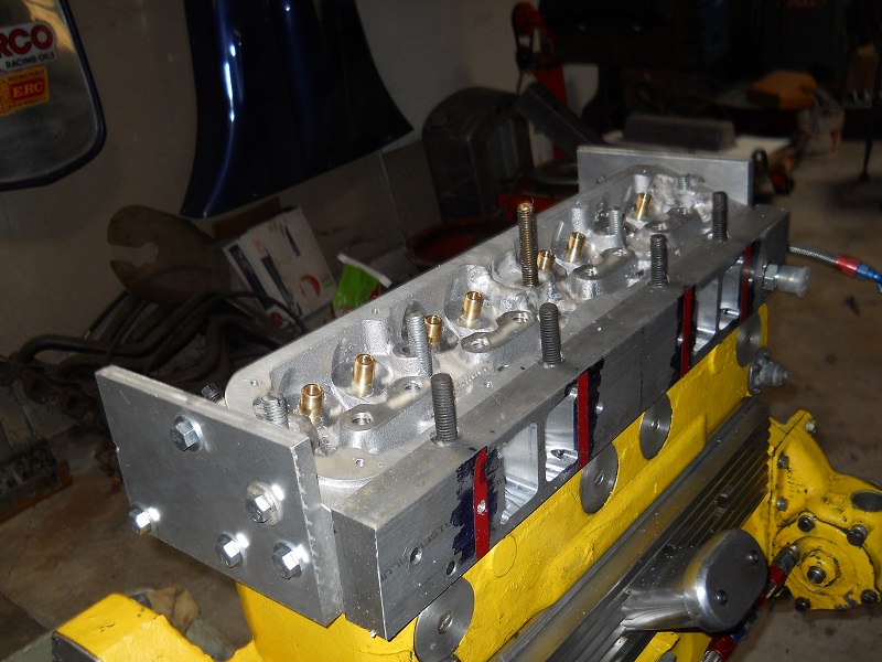

    I can't find any pictures of either the Stude or the Pontiac that I did. However here is a somewhat representative picture of a port plate put on an aluminum 318 MoPar type head to allow the use of the W heads injectors and to facilitate using the later head on a 1926 Dodge Bros. engine. The first picture is the head without the adapter plate. You can see the spacer welded into the head to stretch it to fit the 26 bore spacing. cat dodge bros .JPG ontheblock.JPG linkage.jpg 001.JPG

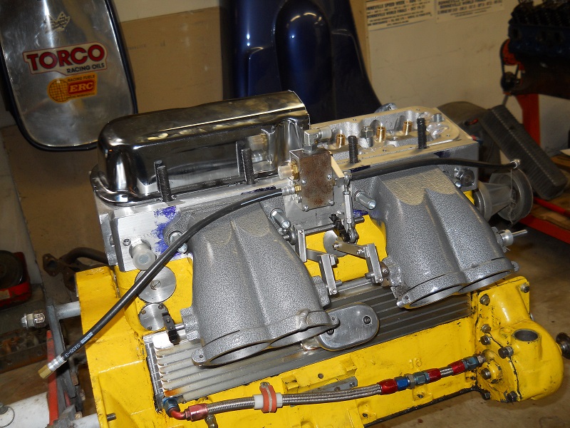

    I have had some health setbacks that slow me down, a lot. The Dodge Bros. project still needs work. And i just finished adapting SBC stack injection to a Y block Lincoln. Destroker 368 to be legal for the SCTA C/AIR class.
