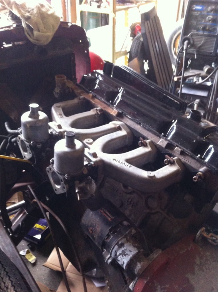

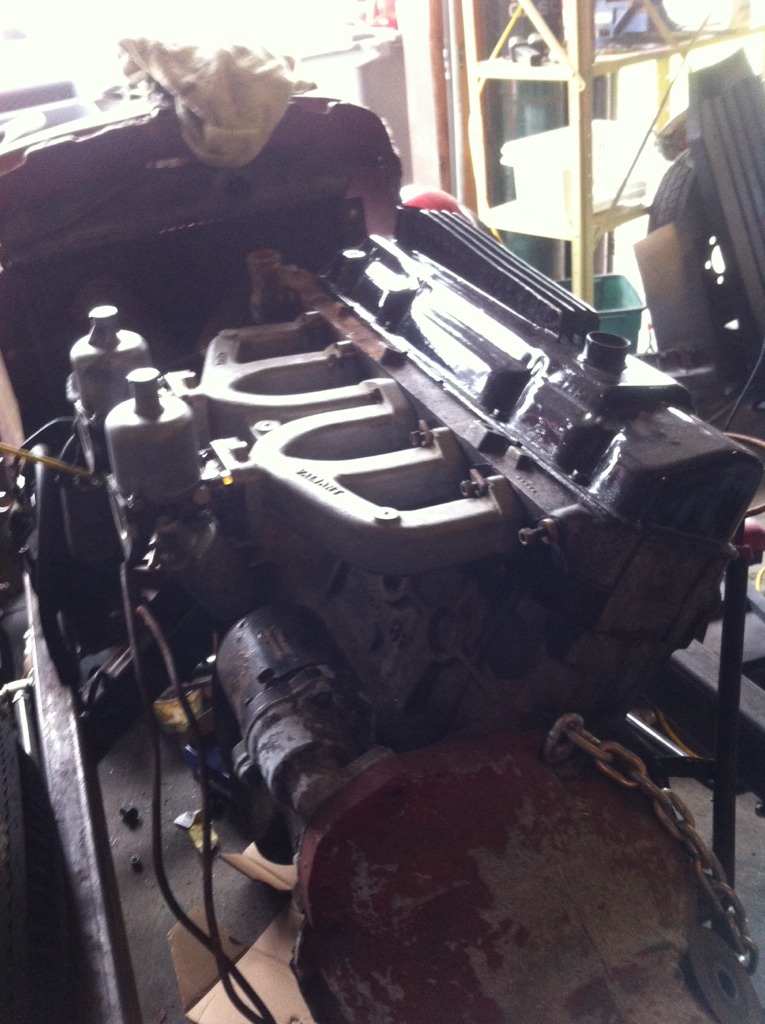

  5. Got my lynx off eBay Australia . Shipping was huge but it is in nice shape and I've never seen one in person. Scored a pair of S.U. 's locally fairly cheap so it all evened out... At least the way I justify things in my mind it did! I shudder to think what you had to pay for that hilborn.... ImageUploadedByH.A.M.B.1393040438.018754.jpg

  16. It's a lynx intake from Australia with SU hs6 carbs
  17. Dam!! thats one sexy instake set up! whats the comp ratio, did you cut the heads for bigger valves? Shave the deck to bump up the comp ratio?

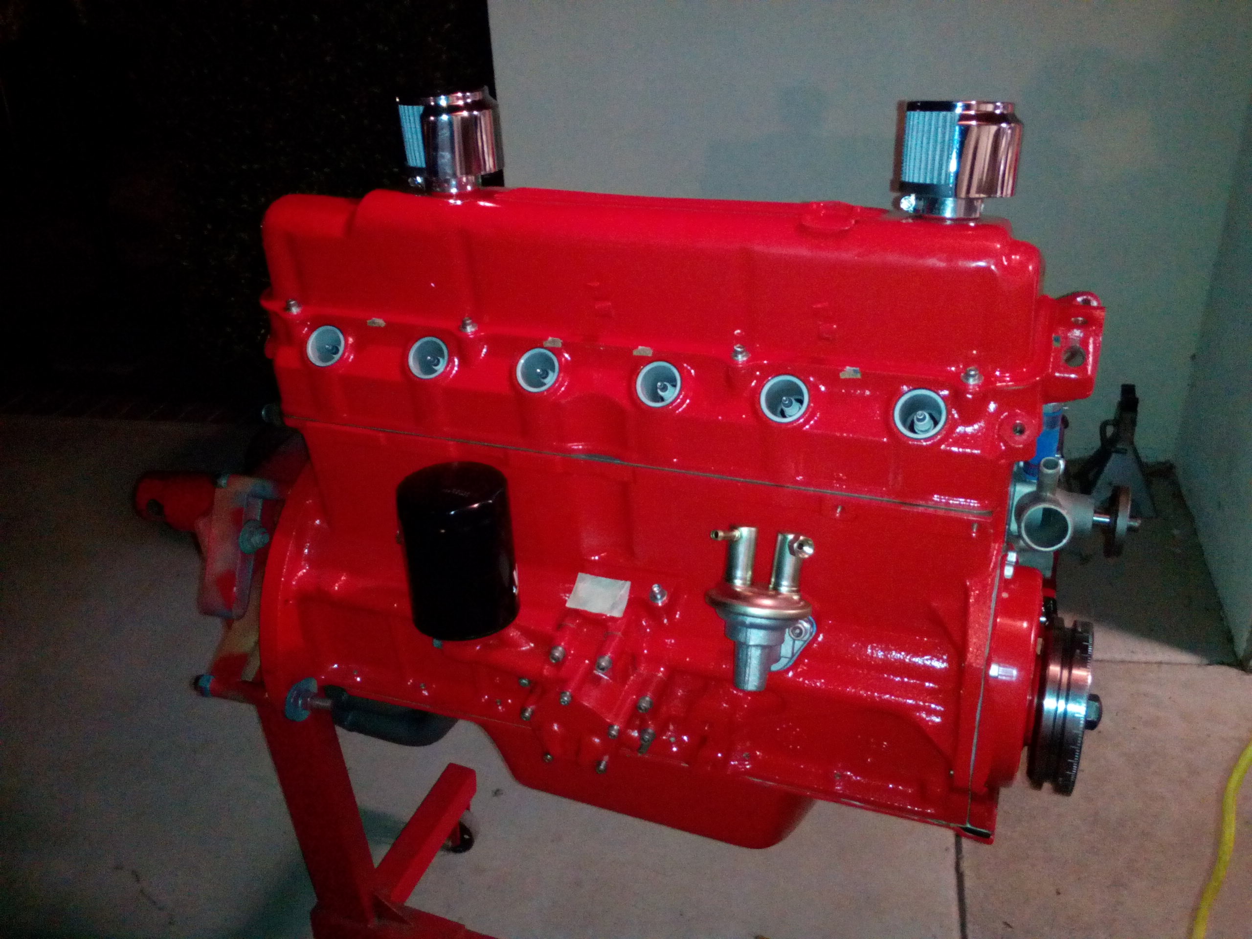

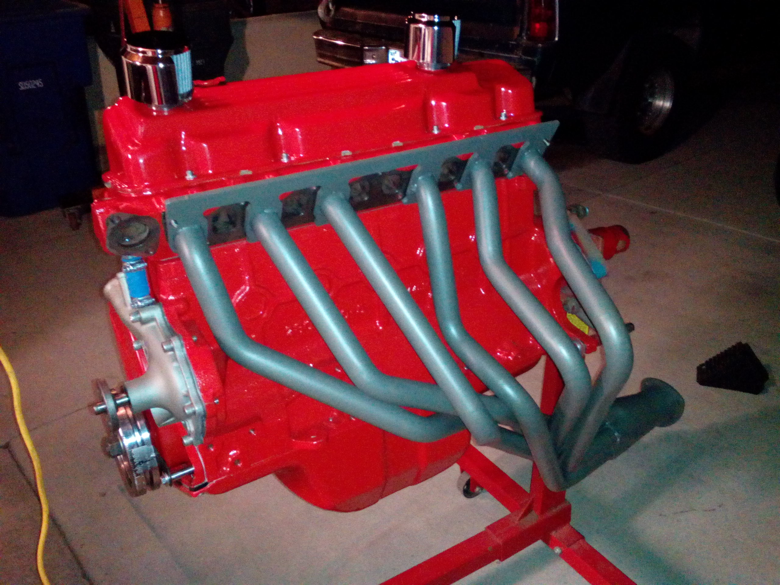

  18. Here is the latest on my 225 slant 6 00202_9YsgmqjTSWD_600x450.jpg IMG_20140927_211413.jpg IMG_20140926_114437.jpg My slant 225 6 into1 header.jpg IMG_20140926_121035.jpg
