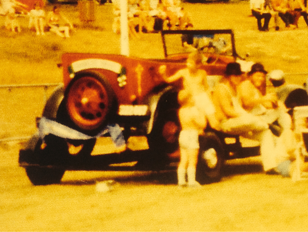

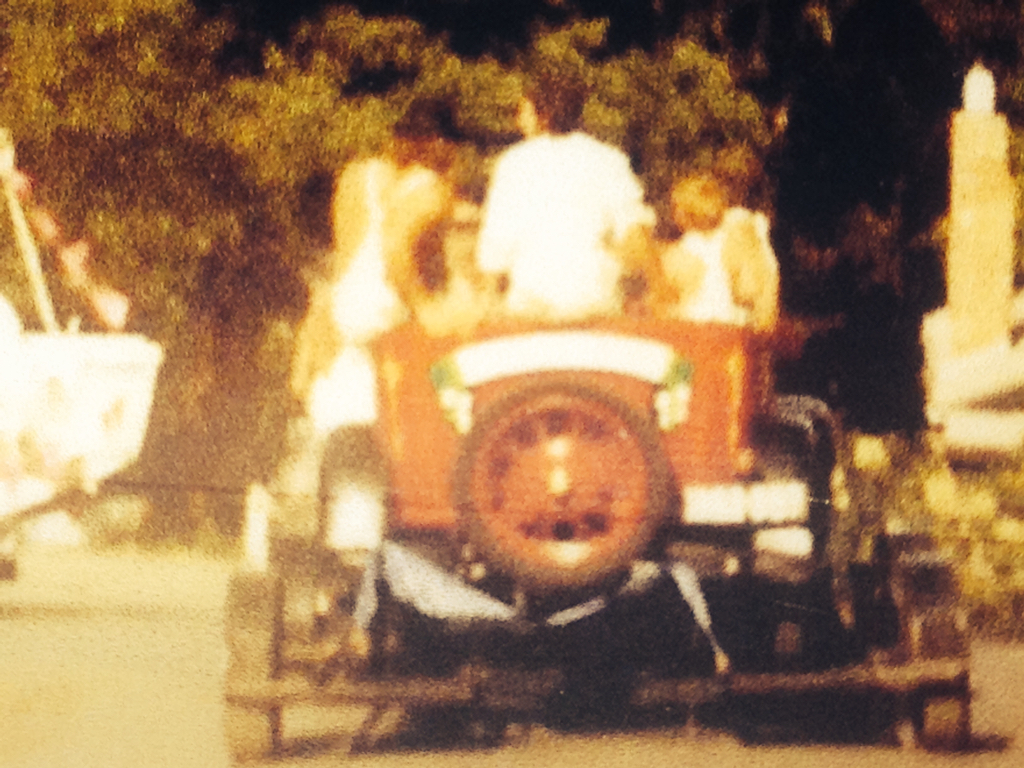

    Hey Mason,Here's your Tub 40 yrs ago Melb Aus
    ImageUploadedByH.A.M.B.1422409701.226931.jpg ImageUploadedByH.A.M.B.1422409759.575791.jpg
    Cheers Mark
    mason-d likes this.
  24. mason-d
    Joined: Jul 22, 2009
    Posts: 146
    mason-d
    from san diego
    thats awesome! You can kind of see the orig. color in these photos too. There are some areas of really bright purple that I am guessing was the original color. The lettering on that body is nothing short of amazing.
