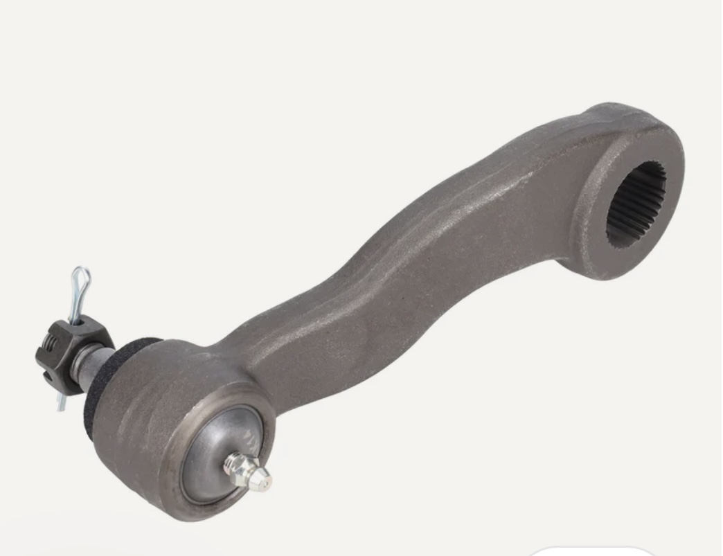

    Here’s a photo, although it doesn’t show a lot, but I think you have to change the pitman arm when changing a standard steering ‘63 Impala to PS. The std. steering pitman has the tapered ball stud integral with the pitman, whereas the PS pitman has a tapered eye that accepts a tapered ball stud that will be on the PS control valve.
    IMG_4381.jpeg The control valve is in back of the two hoses at the bottom.
    Also the control valve will require a different center link, the valve screws onto the center link at the left end of the control valve.
    This photo shows the control valve, to the left there is an internal thread, (NF, maybe 3/4-20, I’m not sure) where the center link screws in and you can also see the tapered stud that goes into the PS pitman.
    I think your manual steering pitman looks like this ^
    If I’m all wet with this advice don’t be afraid to call me out, I’m going from memory on a ‘67 Nova with PS that I had decades ago.
