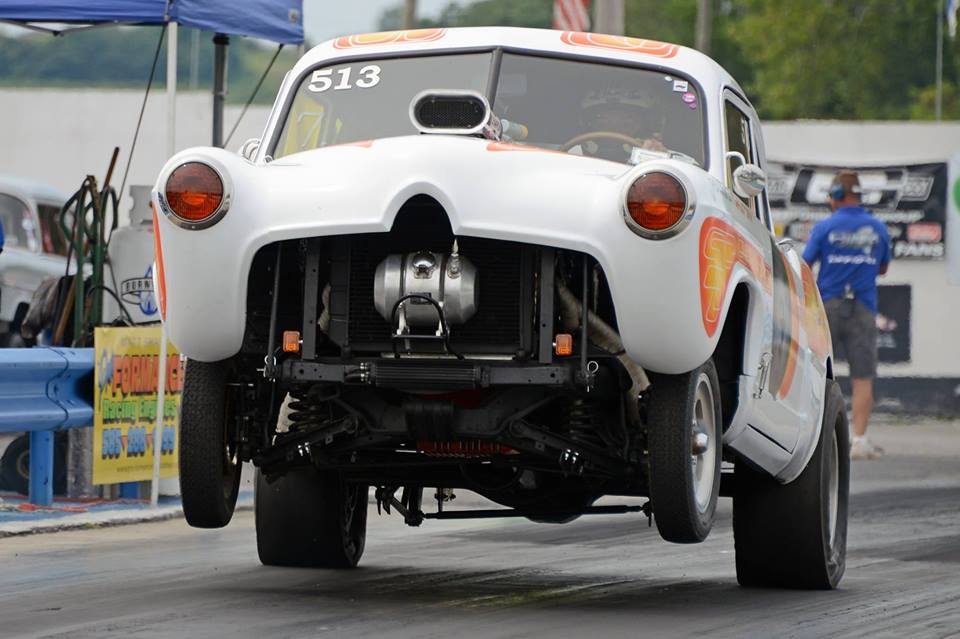

  15. In the past I've posted several articles and dyno tests with multiple brand engines showing and proving that tunnel rams increase torque over single fours and also showing that the hp difference is negligible.
    I ran a tunnel ram just as you intend to do, albeit with closer to 50/50 racing to street duty, and never had issues.
    My setup was 383 sbc, 538 lift, 10.5 compression, aluminum heads, TR1X with 450's, full MSD ignition, 3500 stall, th350, 4.11 and 4.57 gears, 2600 lbs with me.
    I live in the city so plenty of stop light to stop light driving, worked 45 minutes away which was out of the city so 60 mph driving in stretches. The car pulled the wheels every pass foot braking at the track on 93 octane pump gas.
    The new pump gas 489 will also get a tunnel ram on it, if you were closer I'd let you borrow a spare tunnel ram I have to see if you like it or not. Badmoondeadon.jpg

    Your input has really influenced me greatly. After sitting down and thinking about it the tunnel ran is the way I want to go. Plus, now someone with real world experience with an engine similar to mine has said it works. That's enough convincing for me.
    However I think I'll still plan on really dialing the car in with the Torker II and single carb. I'll do it just to make it easier on myself, and not face so many possibilities at once. Luckily enough I'll have a good to hide it hahaha.
    By the way, your coupe is awesome.

    Thanks for the kind words.... it's far from awesome but it would be hard to have more fun in a heap like that!!! Build it, beat on it, then make it better! Good luck and please share your experiences. Real world stuff is what we all learn from!!!!
