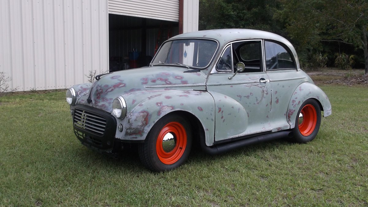

    My Morris Minor has a 87 inch wheelbase. I had a pro street version that I drove every day . Took it on trips and it drove fine. 5.0 Ford with AOD . DSCF0954.JPG

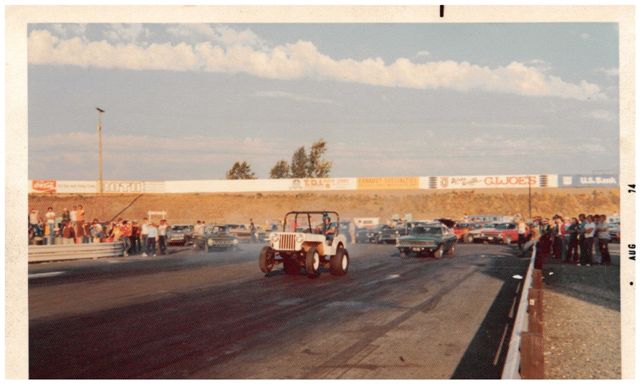

    I ran this Jeep, 82" WB, 11.41 @ 117 in the quarter. Get a load of my race uniform, a blue "T" shirt, and a $16.00 Pip helmet. Times were different back then. Jeep 1.jpg

  28. DDDenny
    Posts: 21,663
    Portland International Raceway.
    There's a real good chance I'm in this shot.
    If not, I was on my way from the pits to watch Marty and his crazy wheelie machine.
