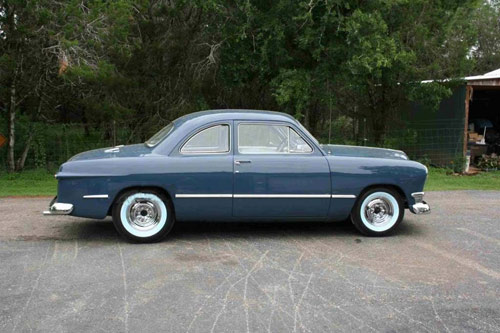

    Long story but my choice of rear axle is slightly too wide. There are not rims available with more offset. I don't want to spend the money on custom rims or axles.
    I have seen pics of shoeboxes with radiused openings and let's say I've been unimpressed with the look.
    So I did a little photoshop on a similar looking car with an apology to the car owner. But the look is growing on me. Any opinions? or technical difficulties with this job?
  2. I think it looks good.Lots of people like the low look but I like a car that sits up.

    Look for a 70's comet or maverick rear end. It's almost bolt in. I'm not a fan of radius cut fenders on shoeboxes. They look a little better on cars that are sectioned but I still don't love them. The shoebox hot wheel car has them and I hate it. Seems it would be a lot easier to find a early mustang rear end or even a maverick/ comet rear end then to spend the time and money doing something you don't love and hope it grows on you.

    I like them lower and round radius rear wheel opening.
  8. If the rear end is too wide, cutting the wheel openings won't hide the fact.

    Already installed. I knew it would be close but once the weight of the car was on it the sidewall of the tire hits the flange and , I assume, the wheel house. Rolling the lip under or the slightest of flares may allow it to clear.

    I think the photoshop looks really good, but I don't like taildraggers, or fender skirts. That one looks like a hot rod. Is yours a coupe too?

    Look up the pinky shoebox build they undid rear wells that looked like the ones in your photoshop picture.

    Back in the day I cut wells on my 49 and thought it looked okay....I wouldn't do it today. The car ended just a racecar, but when you make the cut, it involves the inner as well, leaving a gap and a lot of work to make it right. With the tires hanging out, it exposes the paint to a lot of chipping
  15. Looks like someone tried to cut the rust out of the rear quaters.
    It works on a shoebox Chevy, not on a Ford.

    Sure it's a lot of work, and tires should not "stick out" but if done well, I think it looks good...even an improvement sometimes. The rear wheel wells on these 49-51 Fords looks like a design flaw to me.
    He said it's close enough that rolling the lip might do it, so the tires won't be sticking out.

    OK, here's another rendition. the first attempt I was transferring the shape the front opening to the rear. What if I just raised the rear opening up?

    If it's going to be radiused, it had better match the front. Maybe if you got two sets of 52-54 Ford front fender lips (or 55 Chevy) put one set on the front stock-height and the other set on the rear not quite as tall, but with the same profile, you could give it a bit of a 60's hot rod look.

    Another vote for radius rounding them.....they really stand out that way, and look totally cool in my opinion...
    This one ROCKS...perfect job.
