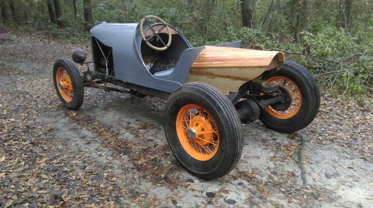

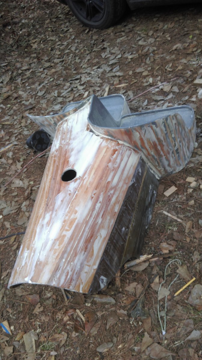

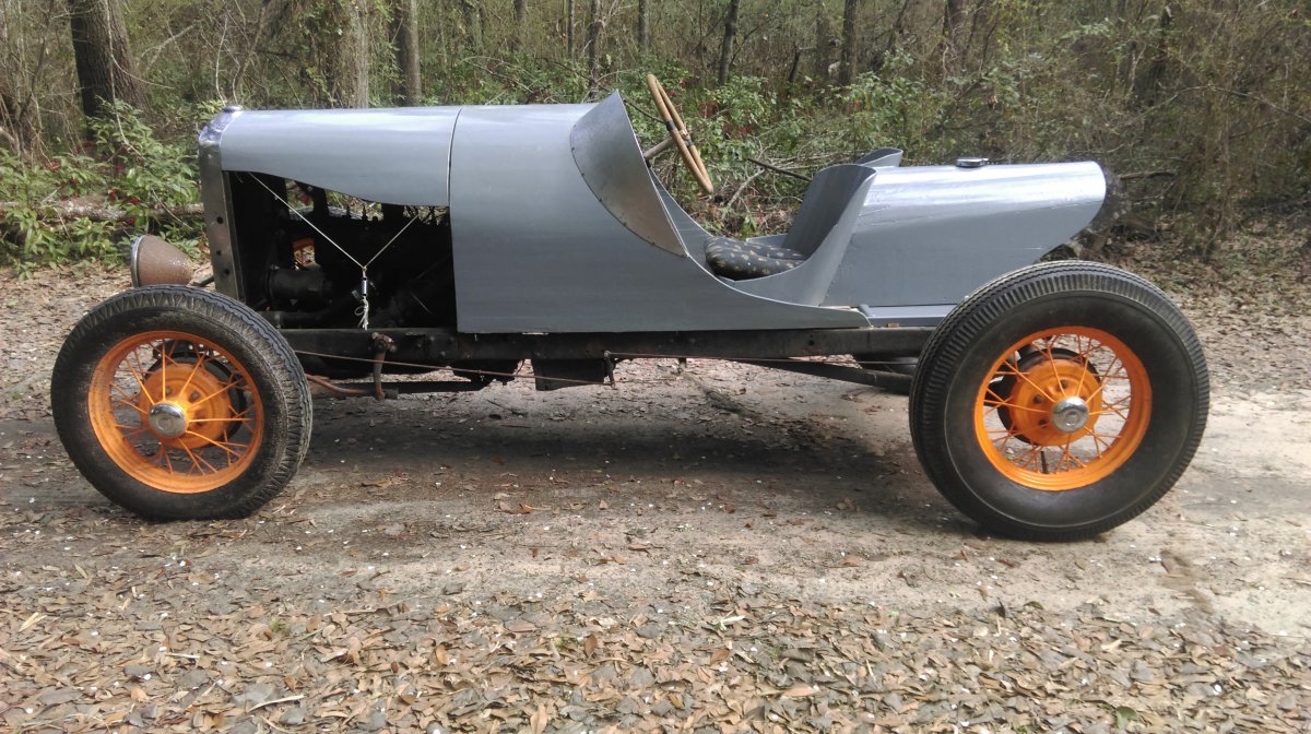

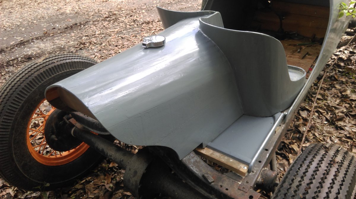

    Well, it's fixing to set in and rain all day here, so this will be it for this weekend. Yesterday afternoon I put the first coat of epoxy on the tail end. That made it stiff enough this morning to trim to shape with a jigsaw. Put the gas tank back on and toodled over to my picture spot, took the tank off (haven't cut a hole for the neck yet, so the new bodywork and tank can't be on at the same time) and slapped the new tail on so I could snap a few. I mainly take these so I can study them during the week, post them up here because why not? That angle between the Poplar and Juniper wood bothers me, but it will be covered by paint. It delineates where the different diameter half-circles start at each end. Running the strips at that angle cut down on the amount of twist each one had to take. The blue tape on the sides is the beginning of my puzzling out how to re-shape them. Anyway, it's all back under the tarp. Here are the pictures.

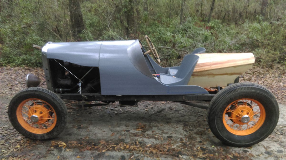

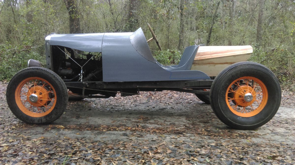

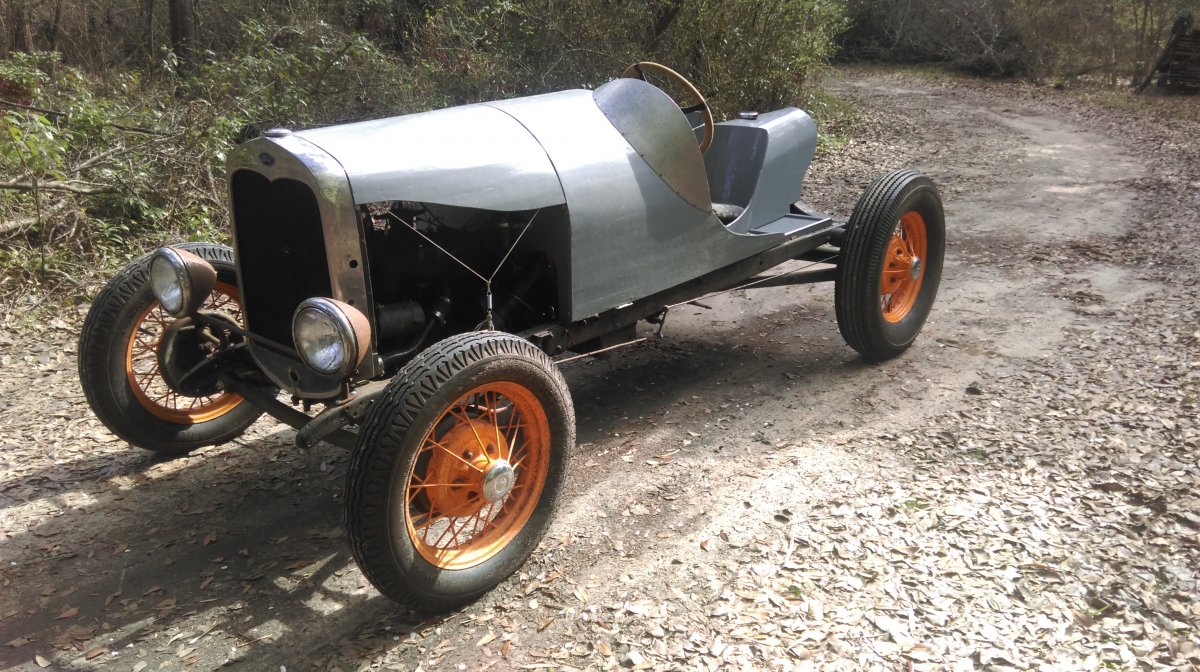

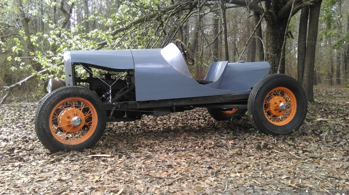

    Just for my own edification, and because I'm frustrated about the weather, I'm posting a timeline of profile shots. Most of these are re-posts, but I wanted to see them in order, and this is the most convenient format for me.

    Might be an illusion, but it appears to me that it runs uphill from the seats back. Is it too late to slope it down an inch or two so it looks level or down slope just a bit? Dunno, maybe this is what you're after. Cool stuff either way, thanks for sharing.

    Thank you. The projection behind the seat slopes very slightly down towards the rear, in relation to the frame. In other words, it is highest at the seat back, measured from the frame rails. That diagonal seam between the light and dark colored wood runs the opposite way, and maybe creates that impression in the pictures. I can adjust the final angle by controlling how splayed out the sides are front and rear before I attach it solidly, if that makes sense.

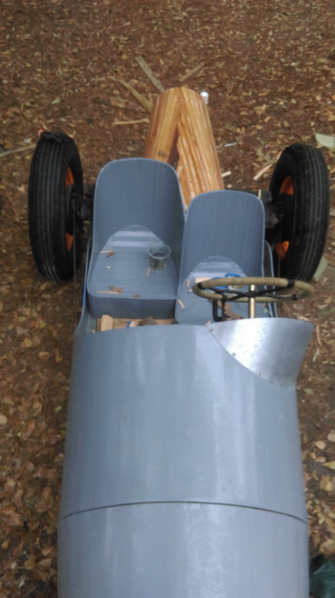

    Well, I did get enough of a break in the rain to dash out and trim the rear part of the main body. I had been staring at the pictures long enough to make up my mind. When it was bob-tailed with the old Jeep seat, I liked the way the body ran out parallel to the frame and rounded off, but with the seats and tail section, it was jarring to me. I like this taper better. Sorry I can't back off enough to get a full shot. I'll get back on the brakes eventually, and maybe some modest engine modifications.

    IMAG1482_1.jpg Have the day off, spent this morning filling in the empty spaces on either side of my rear body structure. This will all be permanently attached to the seats, so it comes off as a unit. Probably a little picture heavy, but I hope they are pretty self-explanatory. I still have a lot of gluing and sanding and fairing to do on all of this, so don't let the cracks and lines worry you.

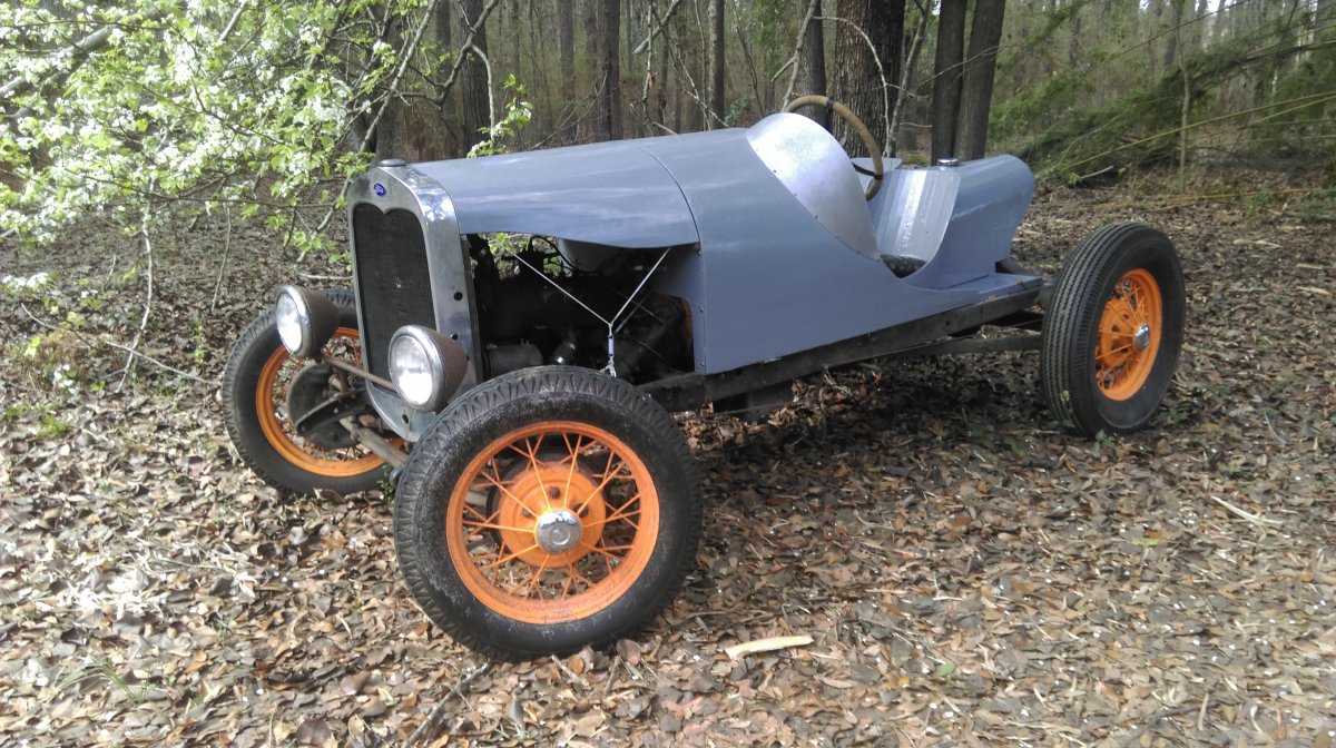

    Fairing, sanding, painting. This whole body is at a stage kind of equivalent to a metal body in primer. I'll eventually do more fairing, sanding, and painting (maybe?). If the rain holds off today, I should be able to get a couple of pictures of it all the same color and back together. As always, thank you for the looks and comments.

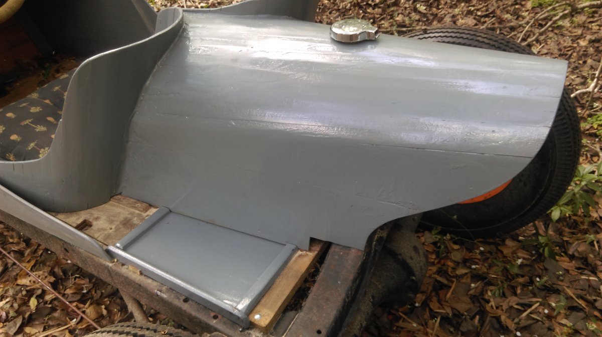

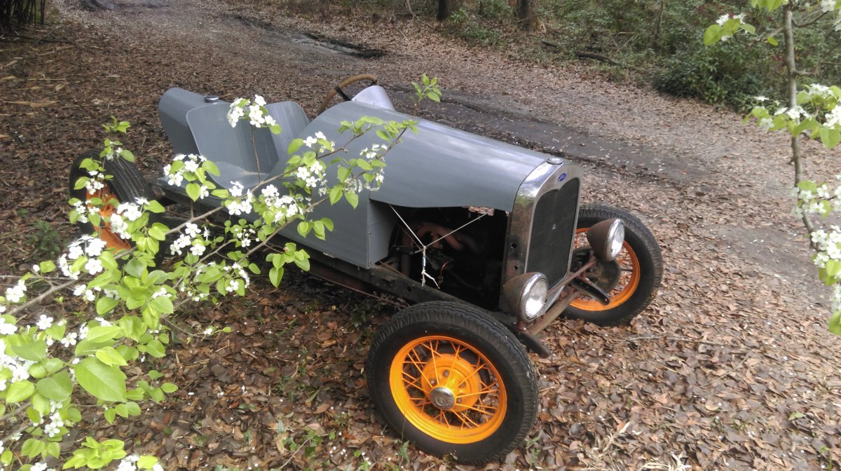

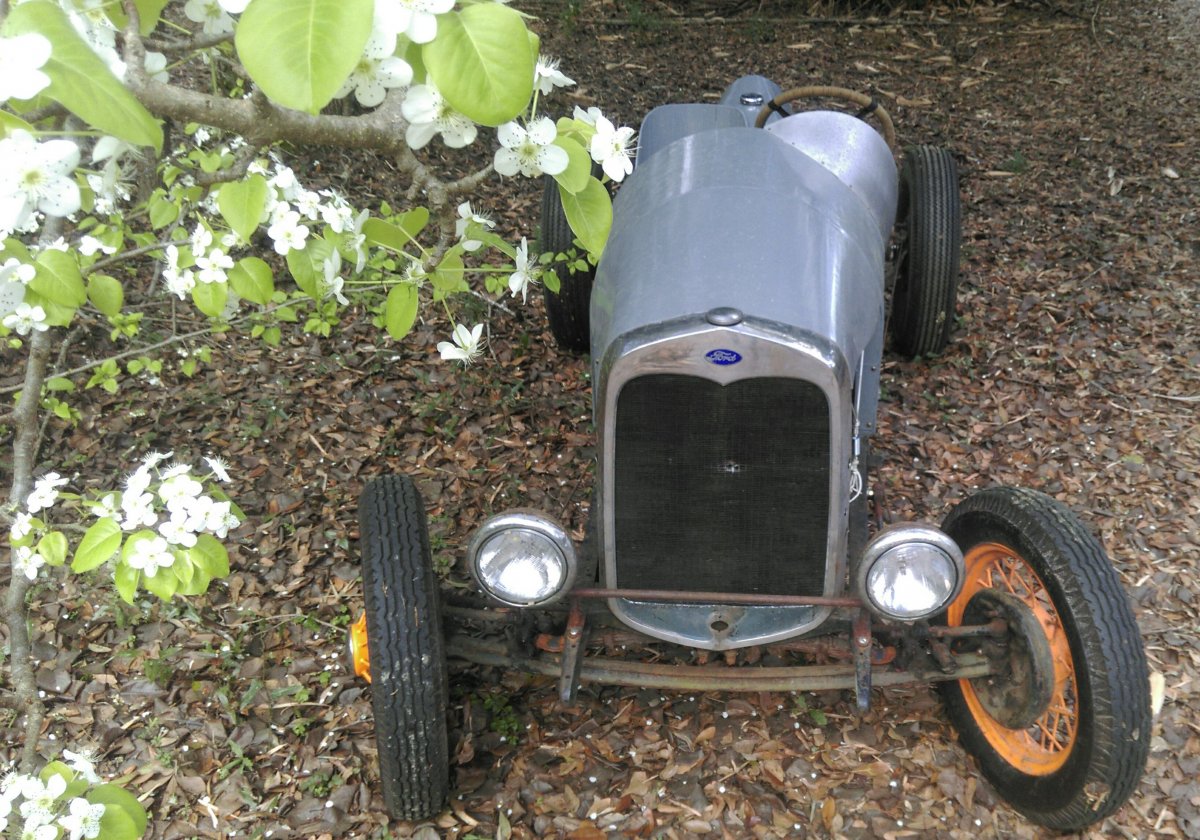

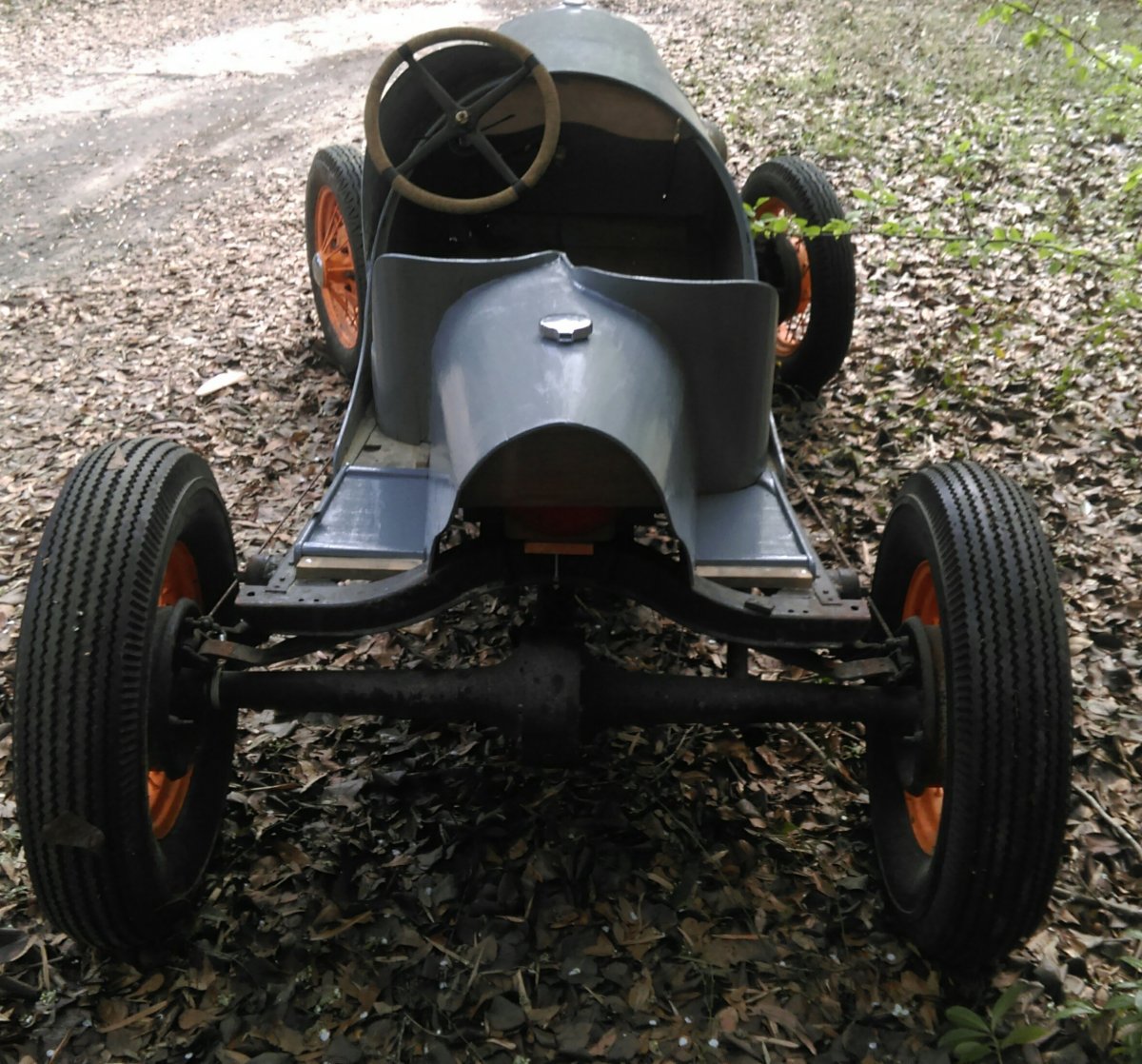

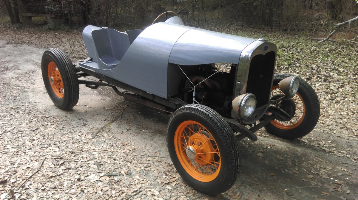

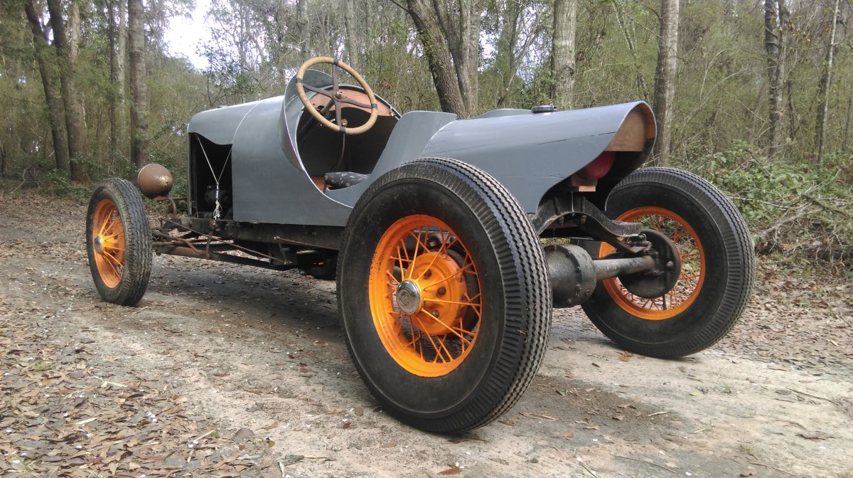

    Paint's still kind of wet, but I think the body construction is pretty much done. Lots of finesse work and detailing, I guess. Plus brakes, wiring, mild engine mods... Anyway, here are some pictures. You'll have to forgive me for getting a little artsy-fartsy at the end. The pear tree is blooming, and it was just too pretty to pass up. Hope we don't have a late freeze this year.

    Actually, I'm thinking maybe some saddle bags or panniers slung over in front of that gas cap. Time will tell. Right now, I kind of like the flat spots. I put a little ridge around them so if I leave a wrench there accidentally, maybe it won't rattle off. Ha.
