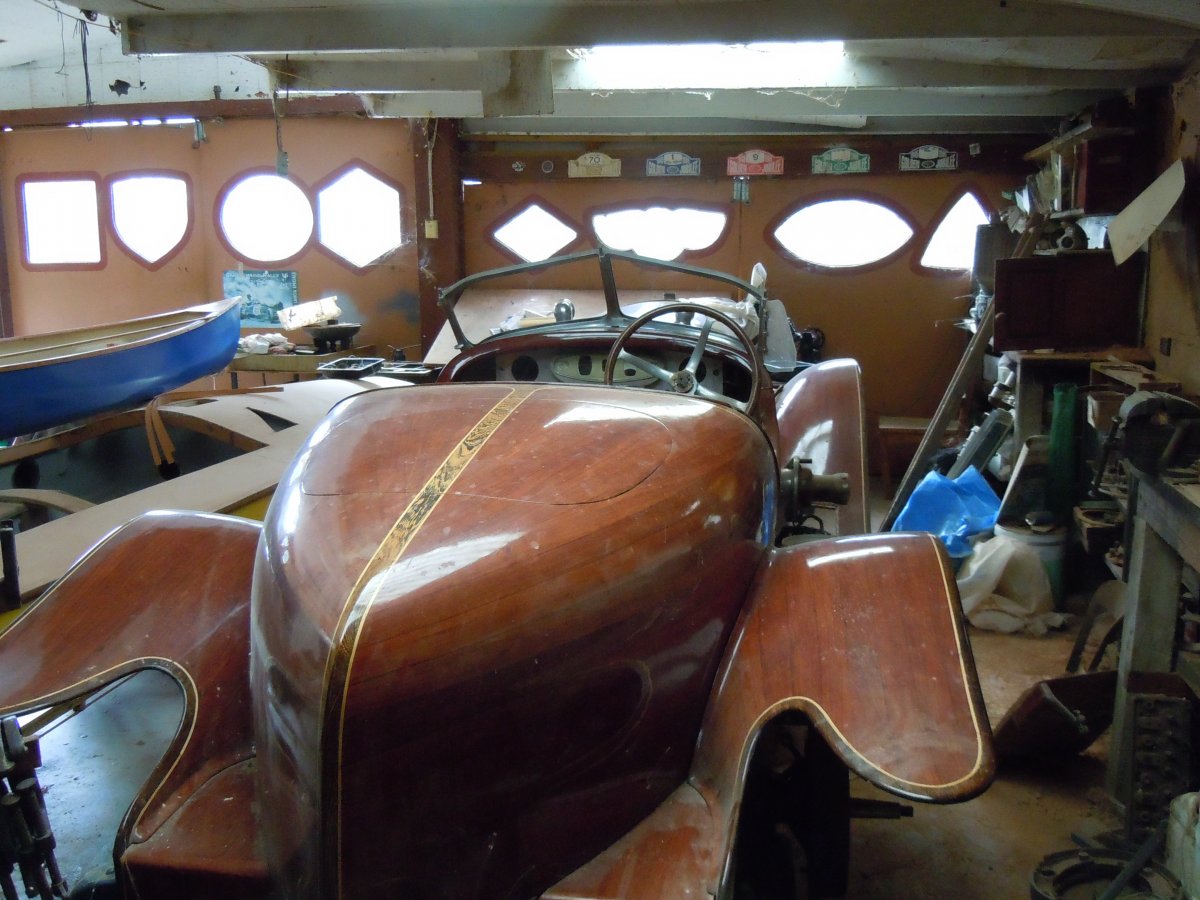

  3. do you think it would look better with a clear finish? that hood looks great the way it is.
    lewk likes this.

    the wood looks good, but I see a clueless granddad telling his rascal that this car was a woodie.
    I weld '47 truck hood side's ford script into my '33-'34 panel below the deck... the above granddad told his young'un that my '34 was a DELUXE because of the script... buddies and I laughed all day about that one... still get the "that a deluxe" from the boys now and then...

    Are you planning on a modern Bimini top or more along the African Queen canvas and rope deal???? Just kidding! Pretty neat. What is the source of those wooden strips??
  8. rwrj
    Joined: Jan 30, 2009
    Posts: 811
    rwrj
    from SW Ga
    We made them ourselves. Atlantic White Cedar, which goes by the common name of Juniper down here, but isn't a real Juniper. Used a Wood-Mizer portable bandsaw mill to rough them out, then a table saw with a power feed, a thickness planer, and a shaper with the same power feed. You can buy them from outfits that specialize in strip-built canoes, though. Thank you to all for the support. It's just a extreme low budget, mess around kind of deal. I think I have just over $1,500 in it so far, not counting labor and leftover parts and such.

    I missed this one the first time around but it shows that you can build something pretty nifty with the skills you know best and the material you work with well.

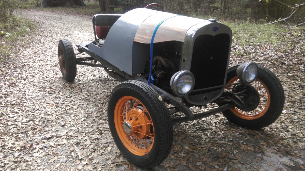

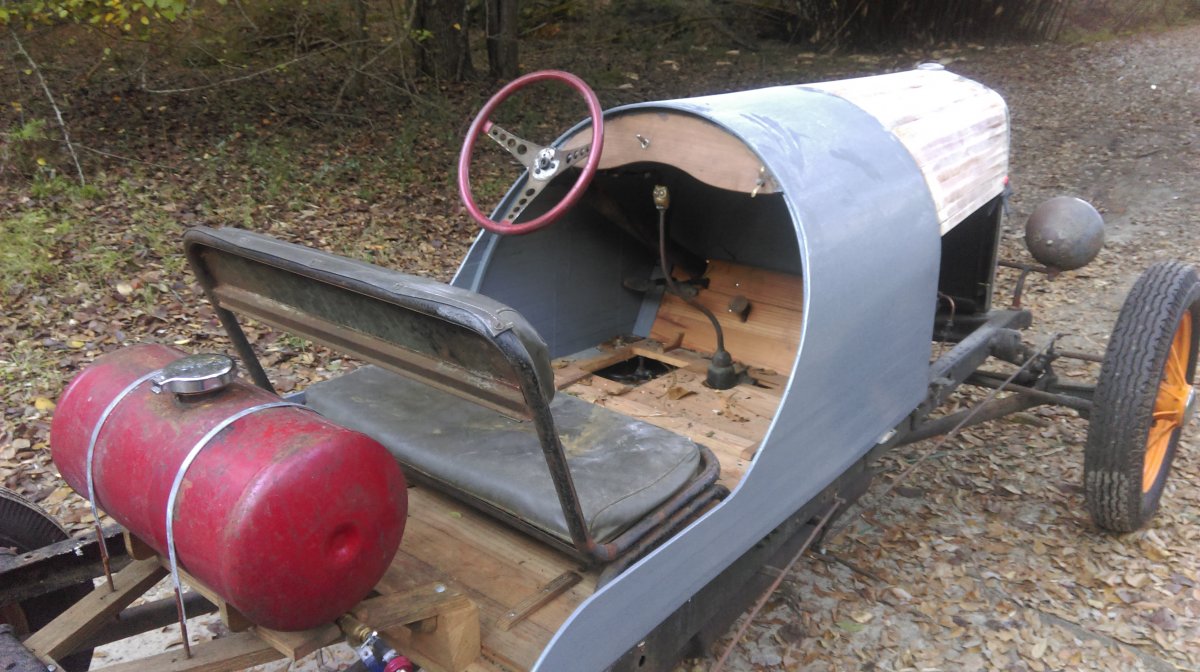

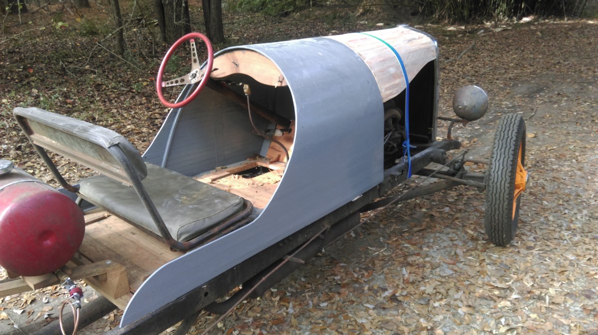

    Got the frames glued in and started sanding. And sanding. And... Anyway, I took a break from that and wheeled it around to my little picture spot so I could take a few. I find it useful to study them. Right now, I'm trying to decide on the bottom edge profile. It's parallel to the frame rails, which I like, but I might cut a little off and raise the edge. Probably wait until I get it painted, though. That can change the appearance a good bit. To the fellow that suggested painting it clear, that would be pretty, but I think a little too pretty. This thing is really kind of rough, which suits me fine. I think a plain old brushed on paint job suits it. Forgive the dust and the dead leaves in the floorboard. Back to sanding, I guess.
    Eventually I'm going to have to get a real steering wheel and make one of those little offset cowl doohickeys to keep it from sticking out there so prominently.

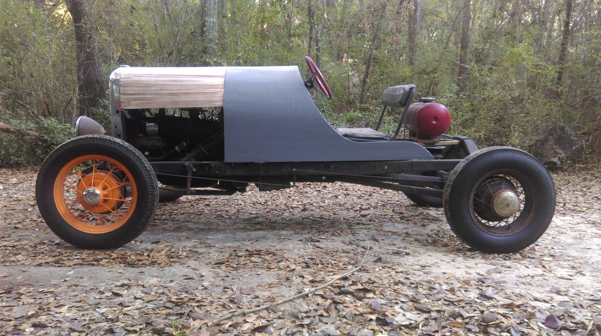

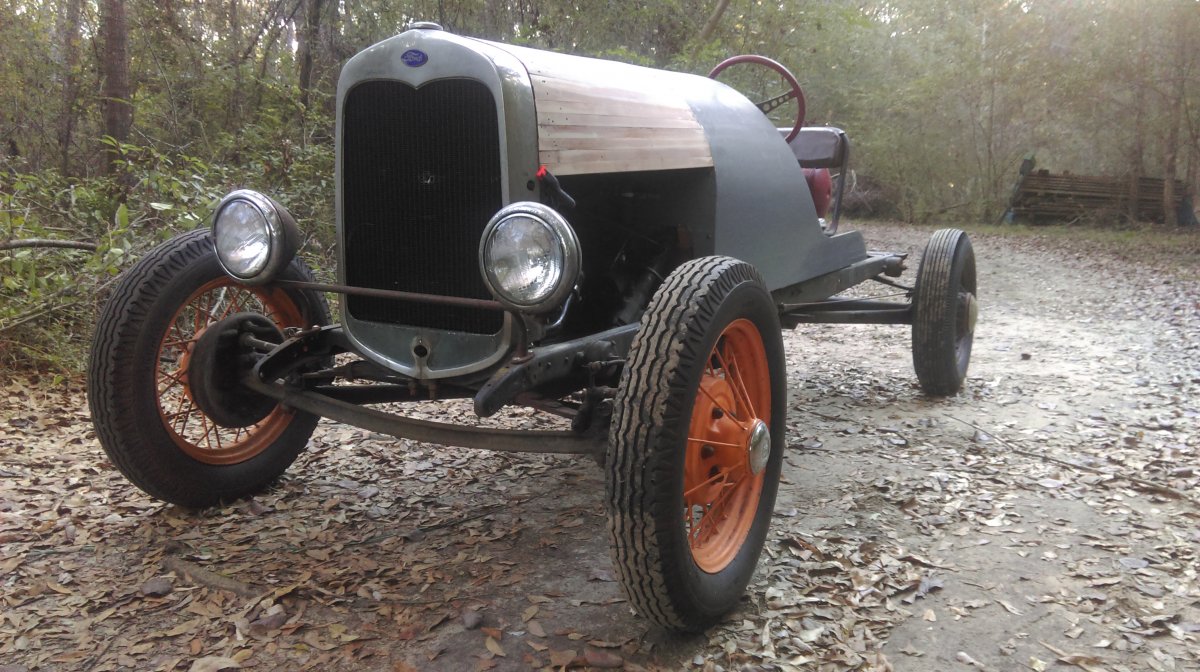

    Well, I tied the hood down and toodled around the yard in it a good bit yesterday, and a couple of things stood out. One was that you can tell a noticeable difference in the temperature around the engine with the hood on. Nothing to be worried about, just interesting. Another was that the frame twists some and kept popping the front corners of the hood past the radiator shell, so I trimmed it up. I didn't want to just raise the line parallel to the frame rails, because it came up too far on the radius of the firewall and looked funny to me, so I swooped it. I like the way it turned out, seems to kind of mimic the fender line of a stock Model A, so it looks kind of familiar and right to me. It cured the issue with the radiator shell. These old cars just flex a lot. I imagine the stock body and sub-frame added a good bit of stiffness. That blue strap isn't permanent, by the way.

    I like the swoop. Hoping you have a plan for the wheels. I'm not digging the front-to-back combo as it currently sits. Just me, of course.
  17. rwrj
    Posts: 811
    rwrj
    from SW Ga
    No, not just you. I don't like it either. Those are 600x16's on the rear, 4.75-5x19 on the front. I need 700x16 on the rear and either see how they look with the skinnies up front, or move the current rears to the front, or buy a couple more 19s for the rear. Right now the diameter of the fronts is larger than the rear. To be perfectly honest, I ordered the wrong rear tires. Just dumbass clicked the wrong tab. Didn't send them back because it was my fault, and .... At least they were on sale.
