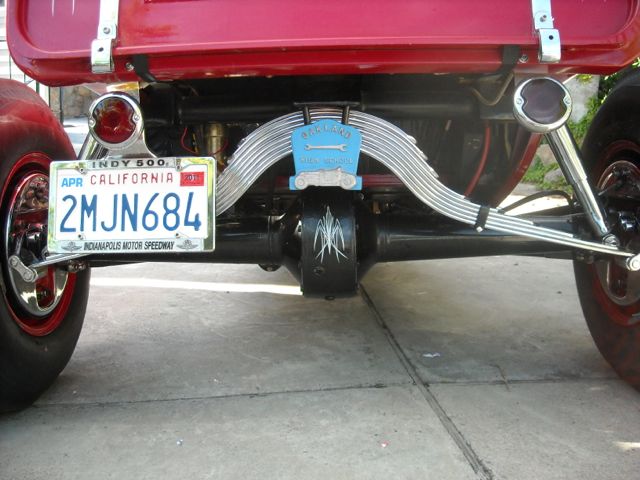

    I'm curious on how to set up something like this, a transverse rear leaf spring suspension.
    What I am wondering is how do you determine the final ride height of something like this when you are setting it up.
    This is the rear suspension kit with the winters QC that Speedway offers for their Tribute T.
    I could conceivably use their spring and brackets on my Winters QC and make a crossmember for the kick up part of my frame......
    I know how I set up my ride height for the coil overs I have designed and built for, however I have been considering the transverse spring instead......
    Just not sure how I would set it up for my ride height if I decided to switch over.
    Anyone have any solid info on how it's done ?

    The rate on a leaf spring is linear. Meaning... if it compresses 1" for 200lbs... it will compress 2" for 400lbs.
    The hard part is guessing the weight in the rear or front.
    That's why some guys take a couple out or add a few.
    Additionally the hangers should ride at 45 Deg at static position.

    Honestly, the quickest and easiest way I have found on a bare chassis is to pare it down to just the main leaf for mock up purposes.

    Would be like setting up a front end, use only the main leaf with shackles at 45 degrees? You need to determine where you want the chassis to be at ride height and the height your rear cross member needs to be in relation to chassis. Plus pinion angle needs to be also correct at set up stage. The same principles apply to the rear as to the front in relation to shackle set up.
    As you'd be aware the ladder bars would taper towards the car centreline and rear of the transmission. A longer arc is better than a short arc. Also consider suspension travel, length of shocks and whether or not a frame 'C' notch is necessary? Consider your spring design as well, reverse eye or standard. What is the load and rate of the spring?
    Free Arch is how much arch is in a leaf spring when there is no load on it. To check free arch draw a line through the center of the spring eyes, then measure from that line to the top of the main plate (the leaf with the eyes) next to the center bolt. (C). This measurement can be positive or negative. You can measure free arch by placing the spring upside down on the eyes on a floor and measuring upward is unacceptable. Leaf thickness, different eye sizes, distorted eyes, twisted eyes, uneven floor, and etc. can and will lead to an inaccurate measurement.
    The most popular method used to measure the length of a leaf spring is eye to eye. As a spring flexes up and down the eye to eye length changes. A 48-inch spring that has a 6-inch arch will measure 46-3/4 inches eye to eye. With a 3-inch arch the eye-to-eye measurement is 47-3/4 inches. This would assist with placing brackets on your rear end housing and centralising things in relation to the frame.
    The correct way to measure a spring is to measure as though the spring was flat. Following the curve of the spring, measure from the center of the front eye back to the center bolt (A), then measure from the center bolt back to the center of the other eye (B), again following the curve of the spring. The measurement at 'C' would be the loaded height (Ride height) with shackles at 45 degrees. Until I read the article I knew nothing about the rationale of stepping the leaves and how critical it was as well.
    http://www.hotrodhotline.com/md/html/spring_basics.php
    There are quite a few threads on the HAMB in relation to setting up rear ladder bars correctly and reinforcing OEM wishbones if used.
    .[​IMG]
    The ladder bars need to point up or be horizontal to be geometrically correct and give you anti-squat with the correct amount of pinion angle at ride height. Pointing them down will cause the car to squat under load which will in turn can cause the rear tyres to easily unload. The pinion will point down. The front pivot point needs to correspond horizontally with centreline of housing at ride height.
    With anti-squat built in and bars pointing up at the front up, the wheels have a tendency to turn the axle in the opposite direction. This motion causes the bars to push the car up. With them pointing down the opposite occurs and the rear drops.
    I plagerised a few other threads and used Dr. Google. I'm sure others will have something more to contribute but for me I'd start with selecting the right spring (Load capacity and rating) and brackets for the specific vehicle and weight. Measure twice and cut once and always remember the 7 x 'P's, Proper planning and preparation prevent piss poor performance.:D

    However the explanation makes ZERO sense to anyone that's never set it up. There are 2 ways to wrap your head around this concept. 1st is blind faith in what a poster has said and hope that all the work doesn't come out wrong.
    Second is to have all the components, measure, guess, estimate, re check, simulated weight, get it together, finish the car, make adjustments to achieve final results. At that point dismantle everything and check it to see that using the main leaf alone does in fact get pretty damn close.
    Also when adjusting final ride heights it's much easier to shim up and retain the ride quantity than is it come down.
    You won't, because you can't convey or apply that conventional leaf spring knowledge to a spring that's mounted in tension. It's not the same as pick up truck springs. With a pick up truck, the spring eyes are always pushing against bolts, add more weight and the push is harder.

  18. I have run a transverse rear spring on my Roadster for 45 years. It is a stock Model A rear spring. Upon installation I used every other leaf, beveled at the end for smooth movement. After about 2-3 weeks the shackles were up against the mounts. Went and had 1.5 inches taken off each end and reinstalled. 2 months later the shackles were straight down. Had another 1/2 taken off each end. Been good since then. Like was said before just use the main leaf for a good guesstimate of ride height.

    Stock dimension for 35-41 Ford is 48.5", works well with an A- spring.

    using the main spring on its own is a good starting point but you will need to make a block of some material to simulate the actual thickness of the spring. I did this by cutting a 4x4 block of wood on the band saw to allow the main spring to be bolted into the frame at the right location for the fully assembled spring pack. The block extended only as far as the mounting U bolts allowing the main leaf to flex as it would with the fully assembled car while only having the chassis bearing on it. This worked well on both the A frames I've done.

  24. Here is the best place to start and figuring & thinking from
    Go back up and notice the shackles are horizontal?
    That means the spring is in tension and pulling on the shackles enough to suspend the weight that's there right now. How much tension ???? IDK but it's a bunch and I don't think there's any easy way to measure it if any way at all. You following so far ?
    Ok let's call this visual above the starting point. At this point (with lots of pre-load tension) is where what you want to call and know as "spring rate" would begin to apply it. All You want to know if you add 100 lbs how much it moves right? At least I'm pretty sure that's what you want to know. Ok well that info or movement is not anything like any manufacturer publishes as "spring rate" because they can't account for the pre loaded tension. (See below for more) The formula for calculating spring rate of any standard leaf spring are all over Google, but this isn't standard. Are you still following so far ?
    Your ride height....
    If you can get a some working dimension from the stock set up above you can begin.
    Does your frame have a Z? Subtract from above
    The stock set up has a spring over with a specific dimension from the hanger to axle centerline......
    Is yours spring behind set up? And where are the hangers in relation to axle CL?
    Subtract that difference from above.
    Taking The above two relationships and altering them are what sets your ride height.
    Springs in tension ---
    So the above example shows the shackles in horizontal.
    That means the pulling force from the spring is greater than the weight.
    As weight is added the spring flattens and the eye to eye measurement must increase. There will be no movement (zero) until the weight begins to exceed the amount of preload tension. (Also Standard spring rate CAN NOT APPLY here) As that weight increases each shackle will progressively move toward vertical. When the shackles reach 45* , that is a visual clue (THE EASY CHECK) that the pulling force of the spring and the weight being applied by the vehicle are equal and balanced. That balance also maintains the axle location side to side, a side benefit.
    As more weight is is added to the vehicle and the spring must continue to flatten the shackles will go past 45* and begin approaching 90* vertical. At this condition you've lost the side benefit and the axle is free to wag because the spring is no longer pulling on the shackles it's hanging from them. As more weight is added the shackles will rotate towards until they bottom on the hangers, that is the end of suspension action and the spring becomes effectively solid.
