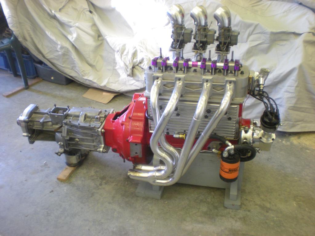

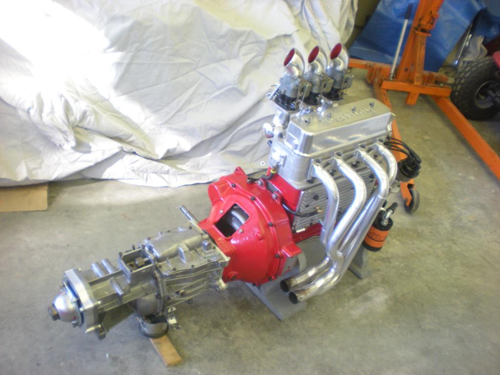

  17. Crazydaddyo
    Joined: Apr 6, 2008
    Posts: 3,346
    Crazydaddyo
  18. Crazydaddyo
    Joined: Apr 6, 2008
    Posts: 3,346
    Crazydaddyo

    Crazydaddyo- Jeez that's some candy right there^^^
  23. Are those engine stand adapters stout enough to handle an OHV banger?

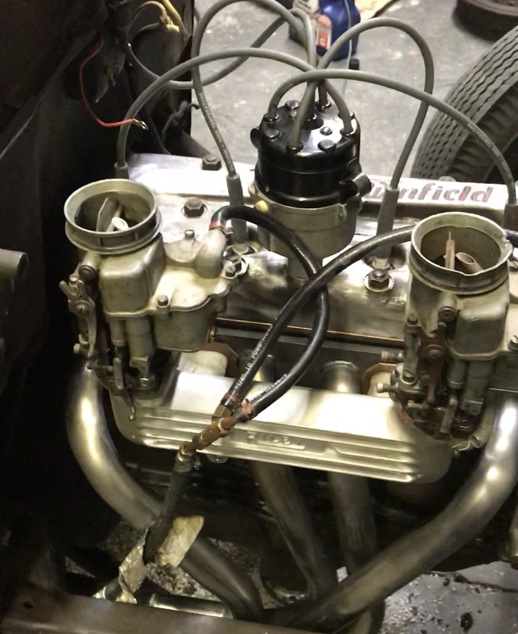

    A7B37767-F6CA-4EE1-A00D-A3A56563CA9F.jpeg It lives! Nothing like cutting it close:)

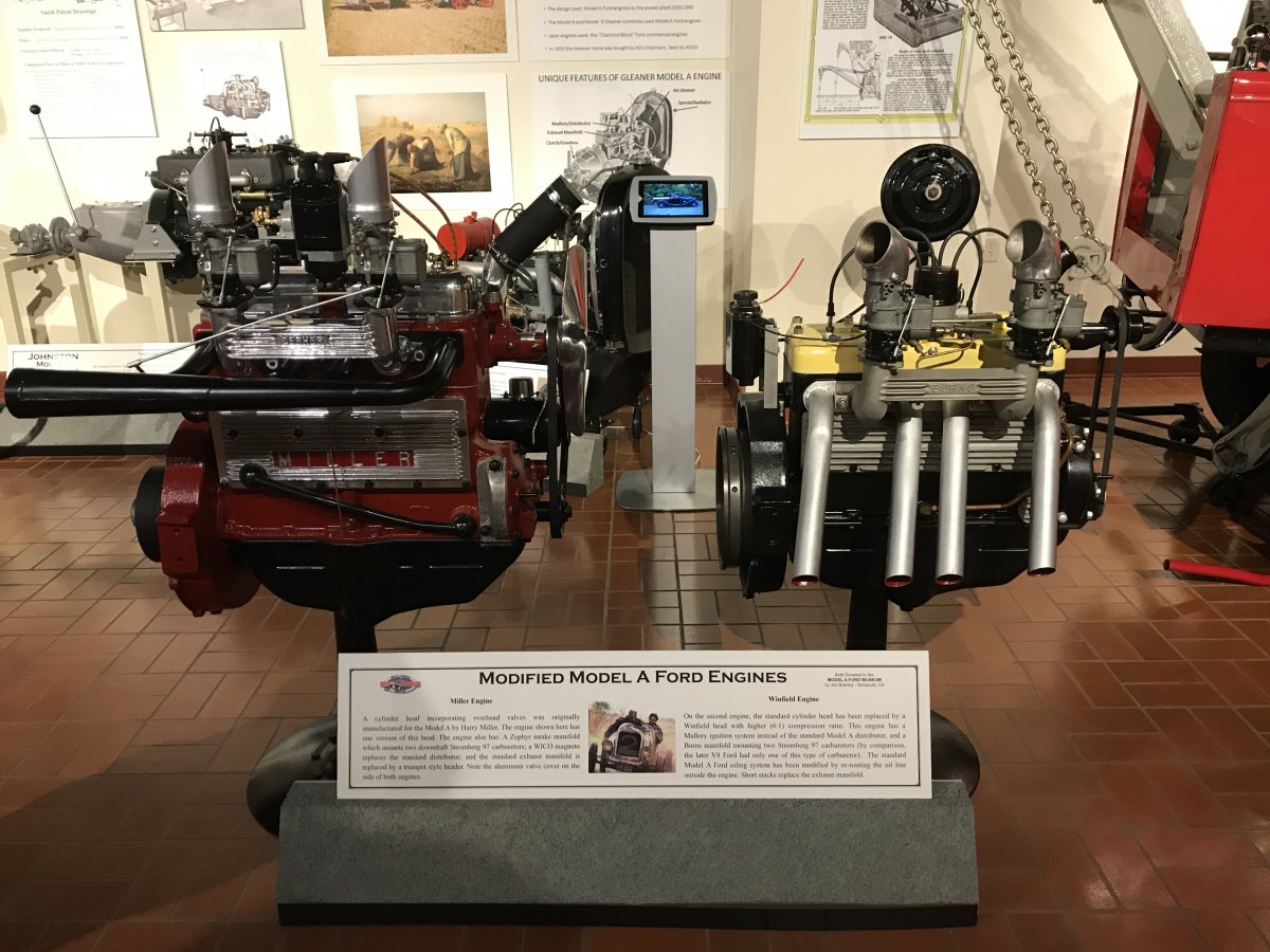

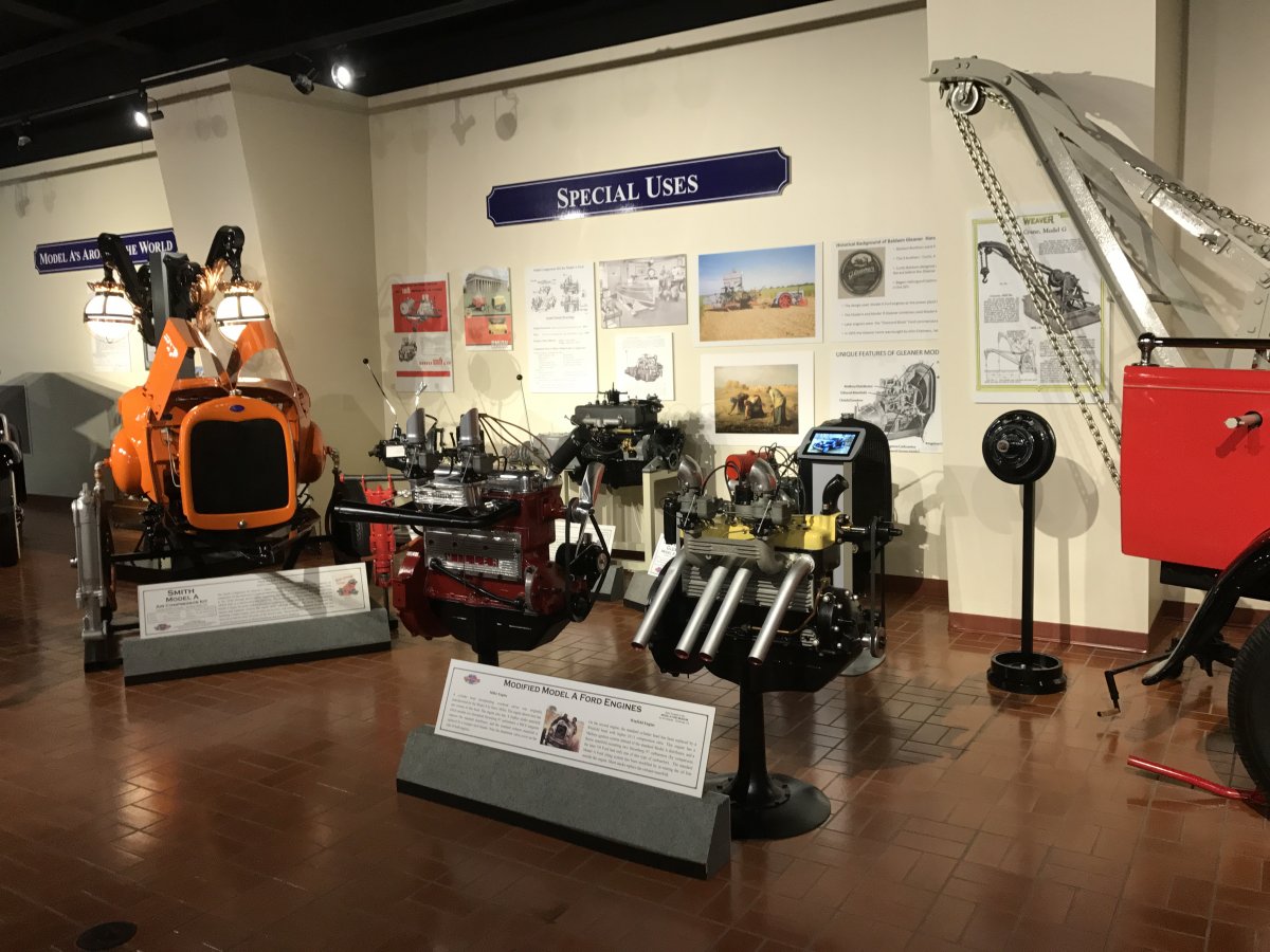

    Thank you Callcoy, Jim & Steve! It's always a treat to see those engines on display! I'll be seeing them again this Saturday at the Model A Meet at the Gilmore
    Shutter Speed, Jet96 and Dannerr like this.

    watch the rubber fuel lines . I had to go to braided steel lines to avoid melting . nice motor !

    great display steve

    V4F- yeah those lines are just temps to get it running. The "rebuilt" 97's that I got with the manifold had tons of slop in the throttle shafts so I robbed the 94 setup off my flattie to make fire. I'll redo fuel lines and linkage tonight and make ready to head to HRHC Thurs am. It's reeally loud!

  29. Yeah! Those fuel lines need to be routed away from heat! However, solid (aluminum or steel) CANNOT be used in most aircraft applications because of the fatigue caused by constant vibration. I don't use solid fuel lines in my race cars either!
