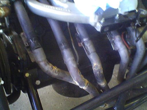

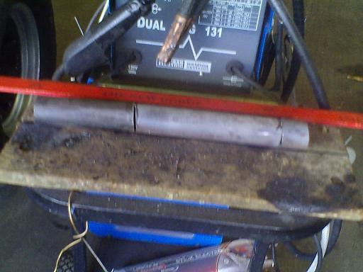

    Spent today since 7.30 working on it. Checked the plugs. (Snow white! ) took the carb off to rework the secondary air valve counterweight and decided to rejet as well. Made notes already where to go. Measured header lengths. Fornt header was 10 inches too long on one pipe. Been working on them since noon. Have it tacked back together but still not happy with one. It is a tomorrow project. The tubing I removed is in the one picture.
    Been a long time since I was this cranked. Feels good though.
