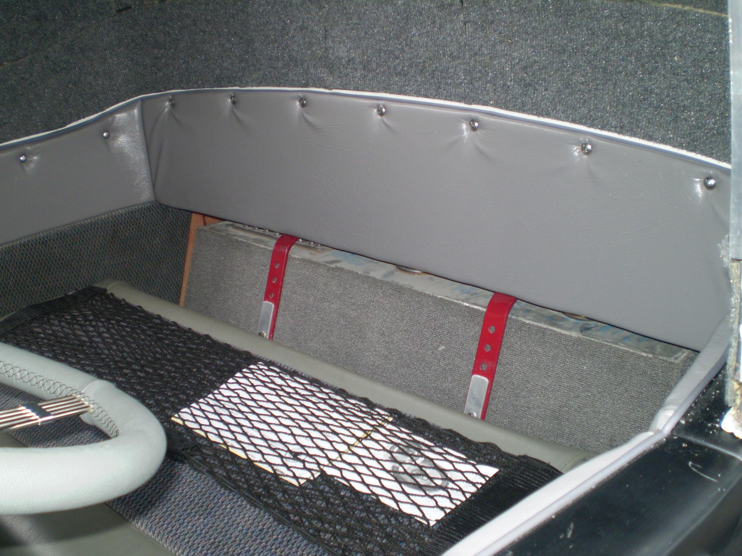

    I built the seat in my roadster and used the original seat in my coupe.

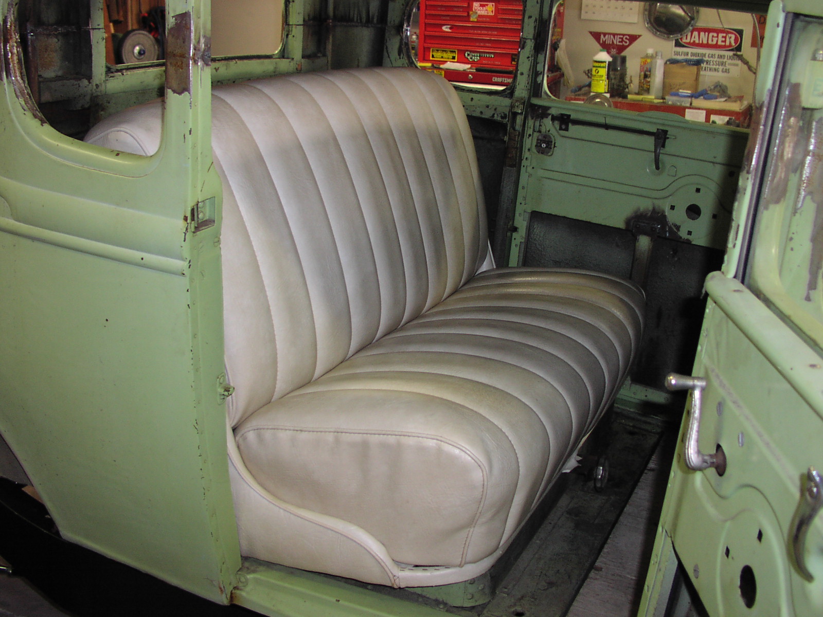

    Call me crazy, but I'm using '29 Sedan seats in my '29 Sedan. Don't even have to recover them!

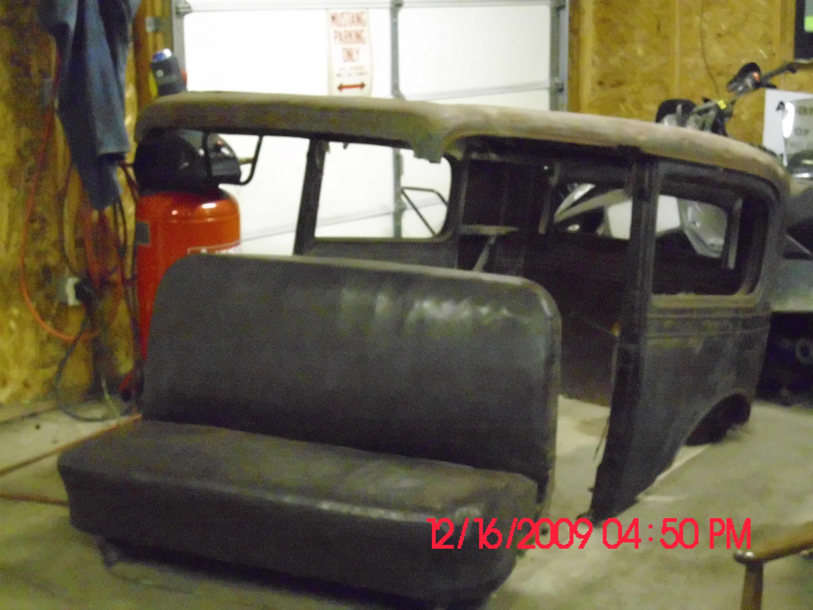

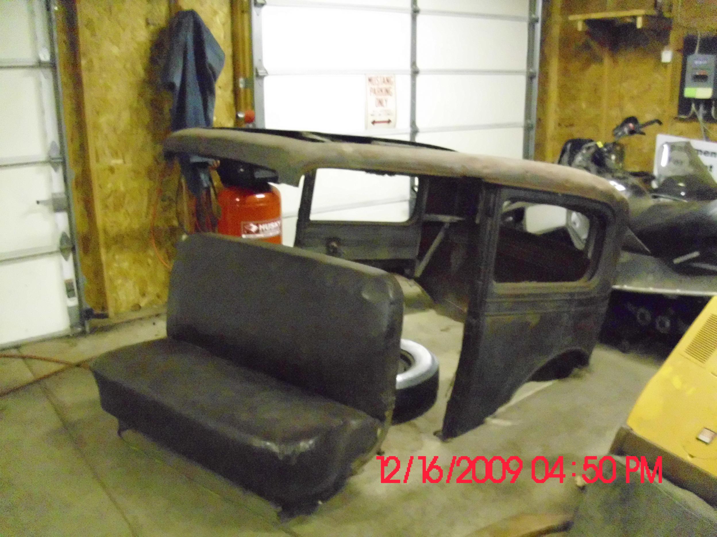

    I bought this seat locally for $75. Guy said it was out of a 1950 pickup. I wanted a full spring bench for my '32 chevy sedan. Took a few weeks but I found one. I am going to cut the frame of it to fit the drive shaft tunnel under it, lower the height of it 2", reweld and cover it. SHould be an easy setup.

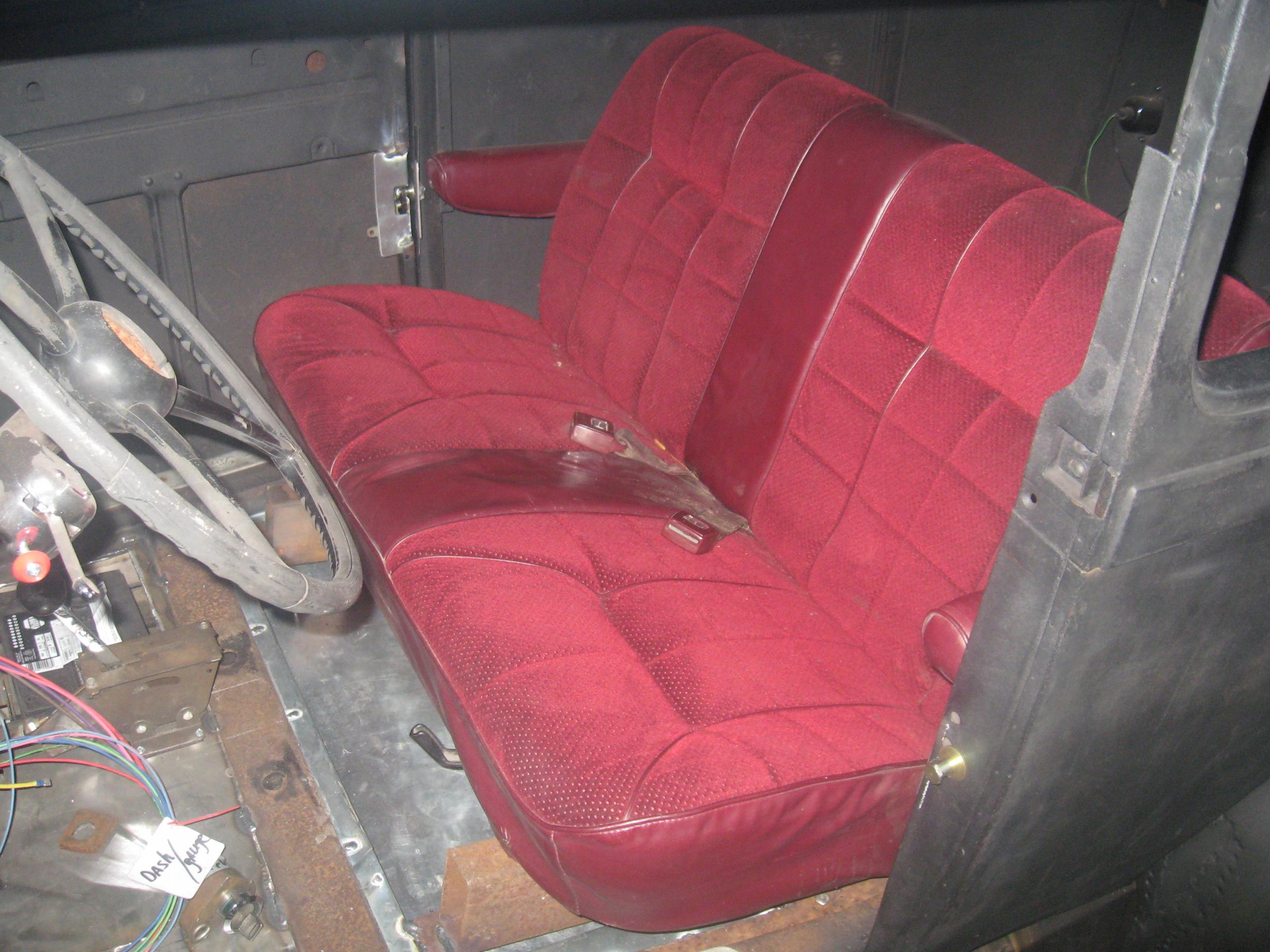

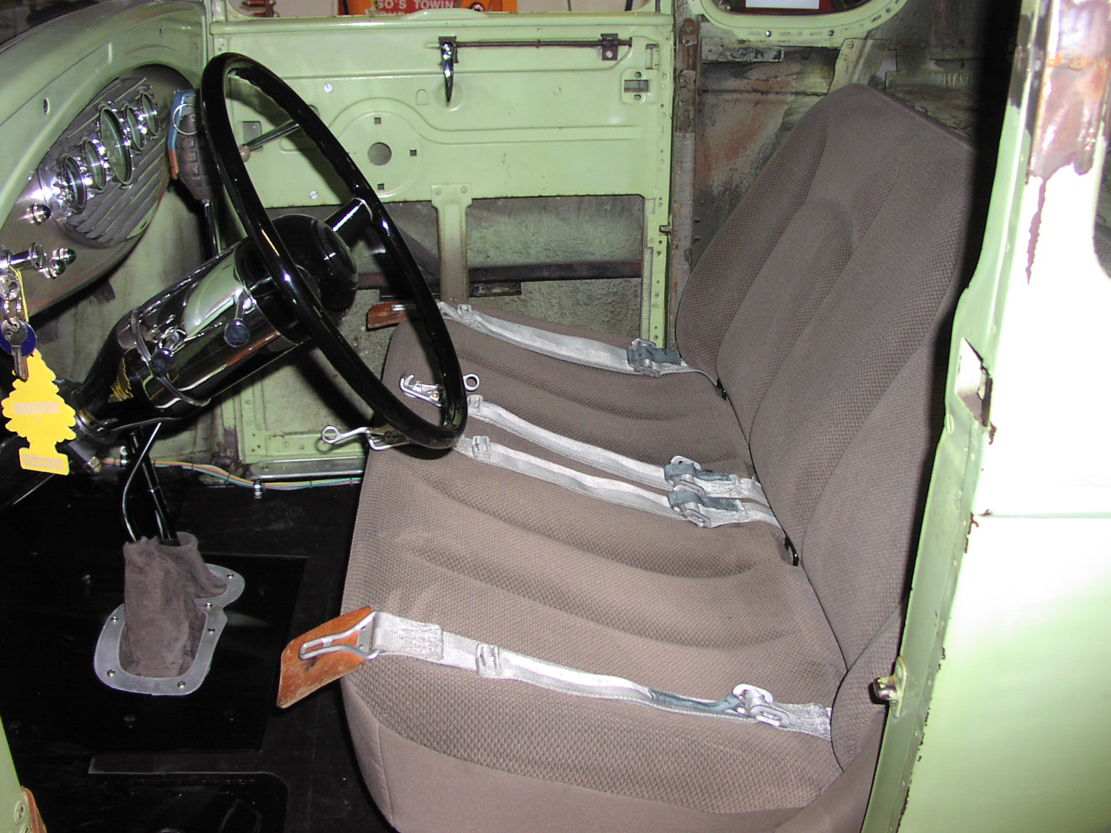

  18. Here's mine, 99 Dodge Caravan center seat. I'm pretty happy with the way it looks but I may go with a tuck & roll design if I get bored this winter. I got the whole interior out of the Caravan and used the material to do the door panels & kick panels. The whole thing was about $100.00.

    that is exactly the seat going into the back of my sedan.
    Sweet idea on using what you had cheap..it looks nice, and a good base to change your look if you like.
    would like to score a set of the VW seats to see how they would fit up front.
    not sure if the ones i have are going to work out or not. Mostly when it comes to letting the back seat passengers in and out

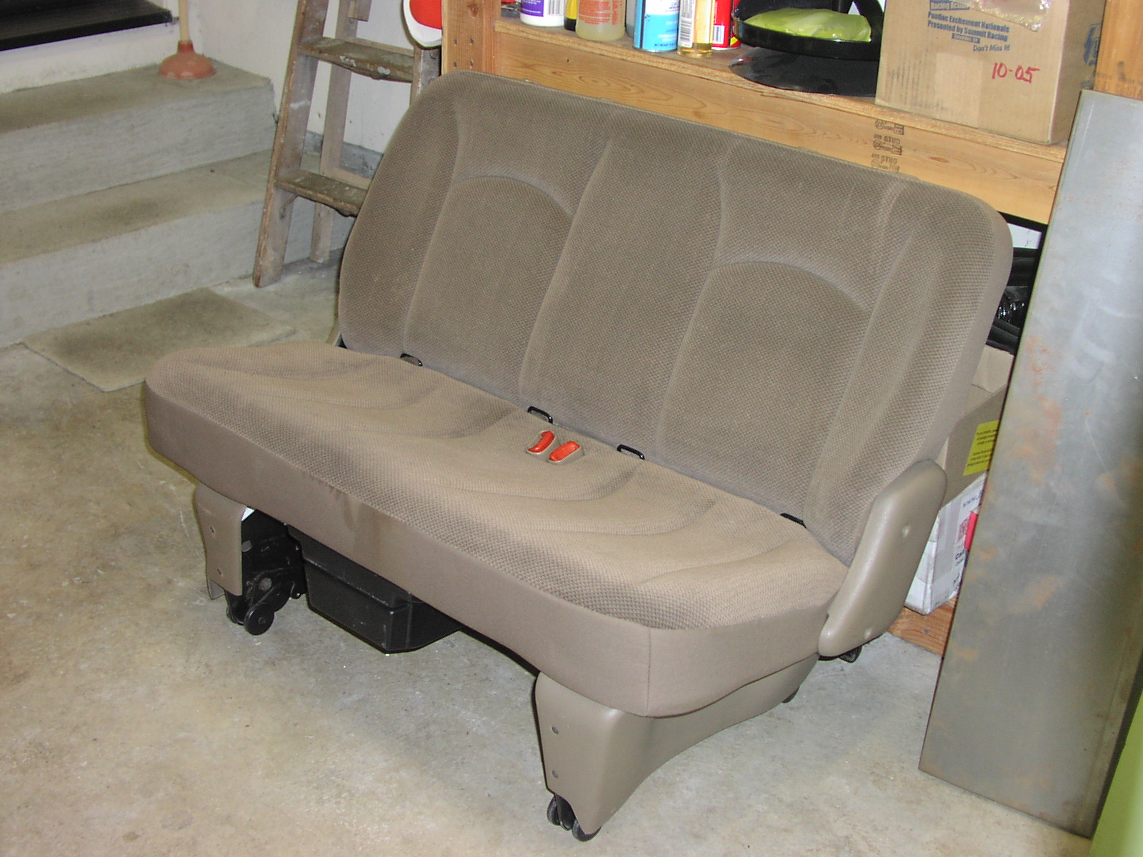

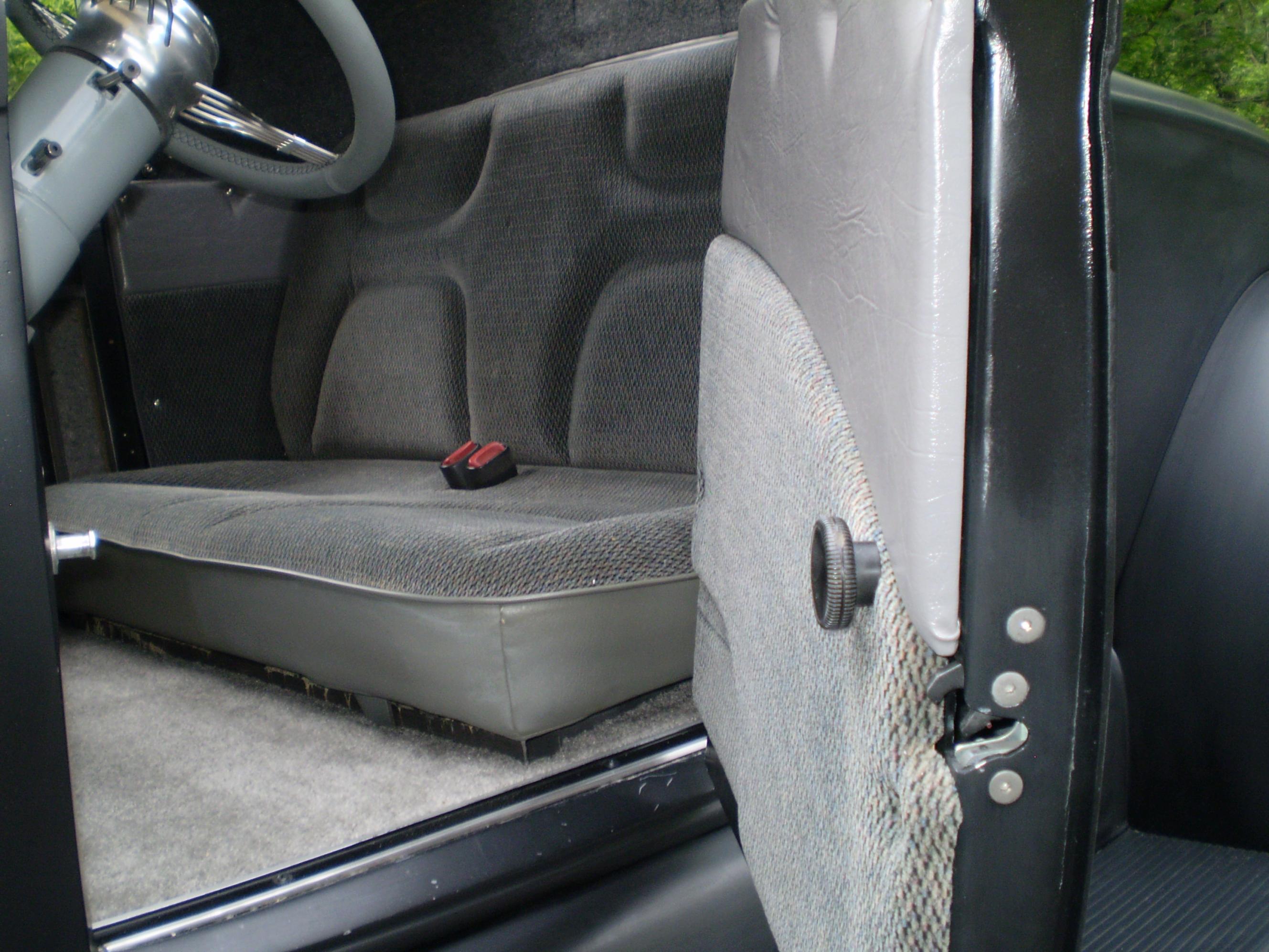

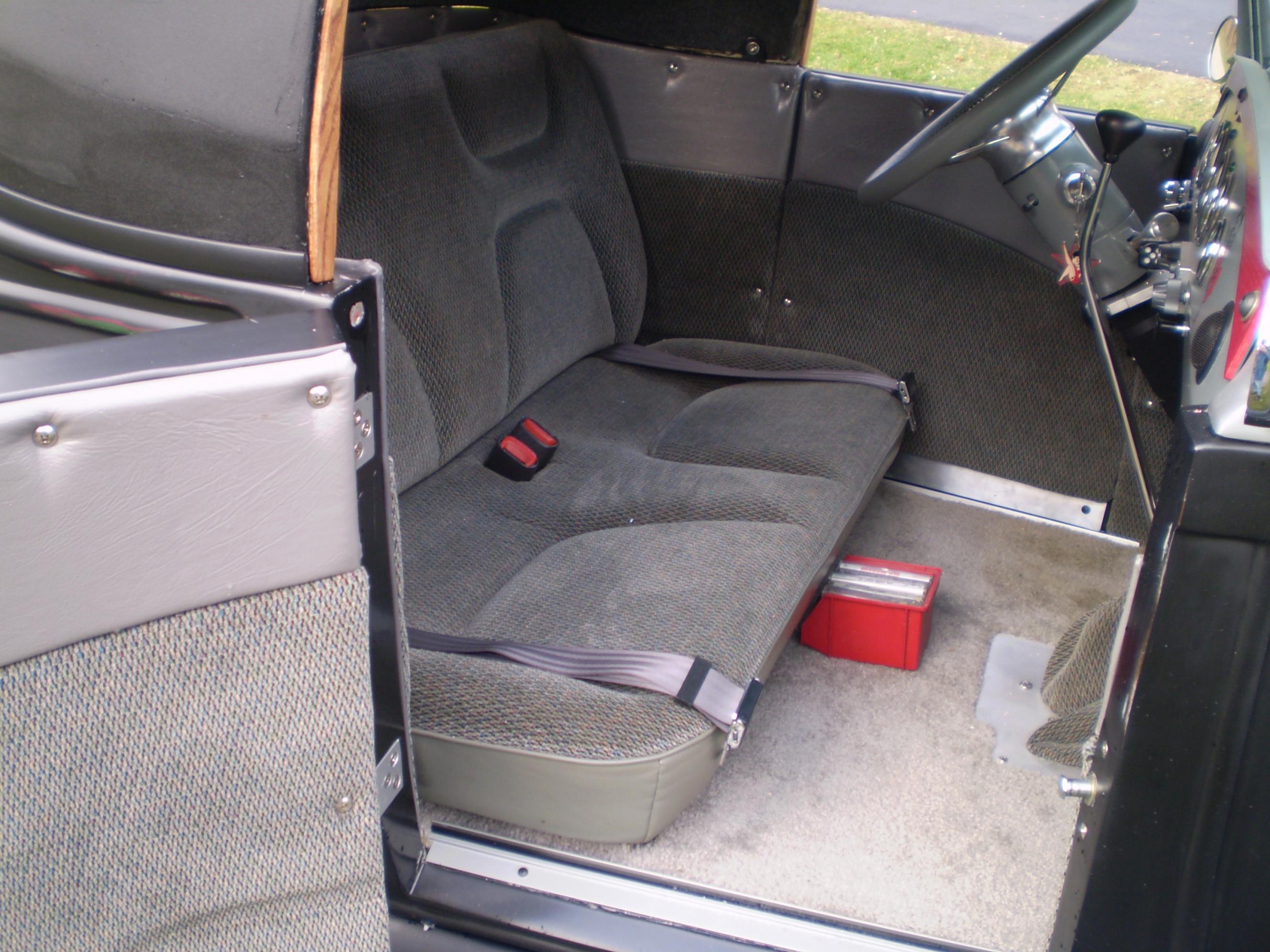

    I used a 2002 Chrysler town & country minivan middle seat in my 30 coupe. It measures 41" wide. When I was looking for a seat, someone gave me the 2 rear seats from a Chevy Astro van for free. I hauled 'em home, but they were way too wide to fit unless you wanted to whack 'em down radically, which would have been more trouble than it was worth. Incidentally, both of those Astro van seats are the same width, and they'll interchange from middle to back in the original application.

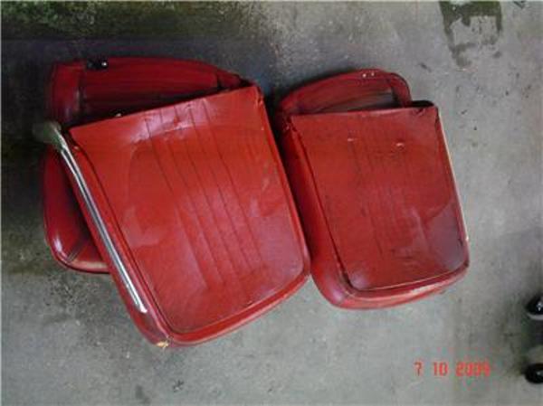

    I picked up my Chrysler mini van seat for a measly 25 bucks, and after cutting down the seat mounts to lower the height and welding on mounting feet, the seat fits perfectly. Someday, maybe I'll get the seat reupholstered in military canvas and with new foam to get rid of the modern look, but for now, that mousy brown upholstery and the cheap price suit me just fine. It's a comfortable seat, and it's even got a slide-out cup holder, if that's of any importance. Like someone else pointed out, some of the Chrysler products mini van seats offered a release handle on the right side so the seat back could be folded down. Mine doesn't have this feature, but it would be handy. I'm attaching pictures of the original seat that was in my Model A (would've been way too tall with the 4" chop without altering it drastically), the mini van seat as it looked when I bought it, and the mini van seat as installed.
