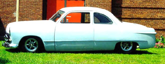

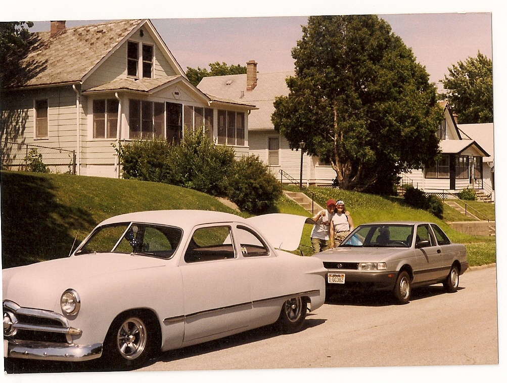

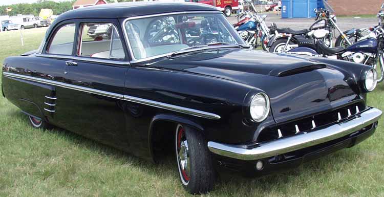

    My old 50 was lowered with cut front springs, spacer on the spring cup and 2" blocks on the rear and was almost too low, front crossmember was only about 3 1/2" off the ground.. Went on a club garage tour and one guy lived on a gravel road and I drug the mufflers on the high spots. I also did a 53 Merc the same way and both drove and rode well. Sold the Merc to a friend about 20 years ago and he is still driving it. 50.jpg all220.jpg and

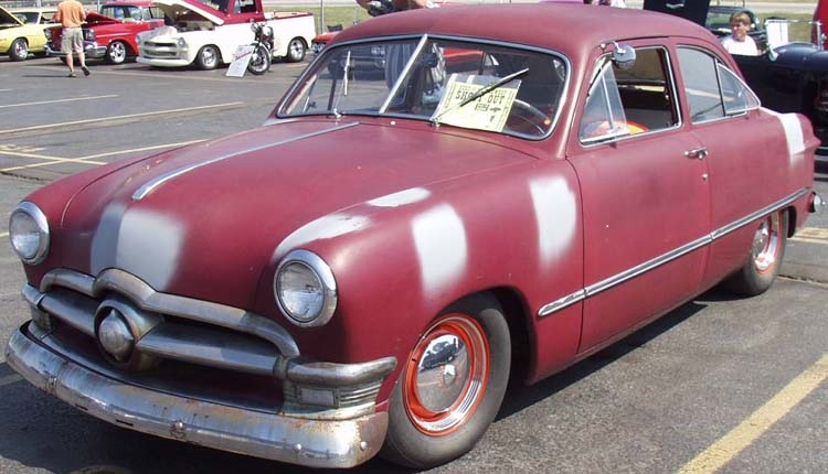

  20. Flipped spindles, cut coils and 4" blocks in the back. 14" wheels/tires too. rockybox2.jpg rockboxnscotty.jpg
