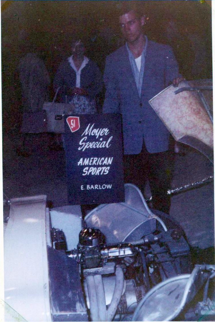

    Pretty cool,I guess he has not got around too building rear shocks? I love Crosley's anyway,so had too look ! Love the custom brakes too!
    By the way,his custom upper water hose/line/tube has a hump around the mag,that's not smart,as it should of been off the block up a little an then run straight{picking up next out let as it goes foreword=no hump for air/steam pocket=better cooling.
    This photo I added is of one Dad an I built, Crosley powered SCCA H-Mod back in the mid 1950s.
