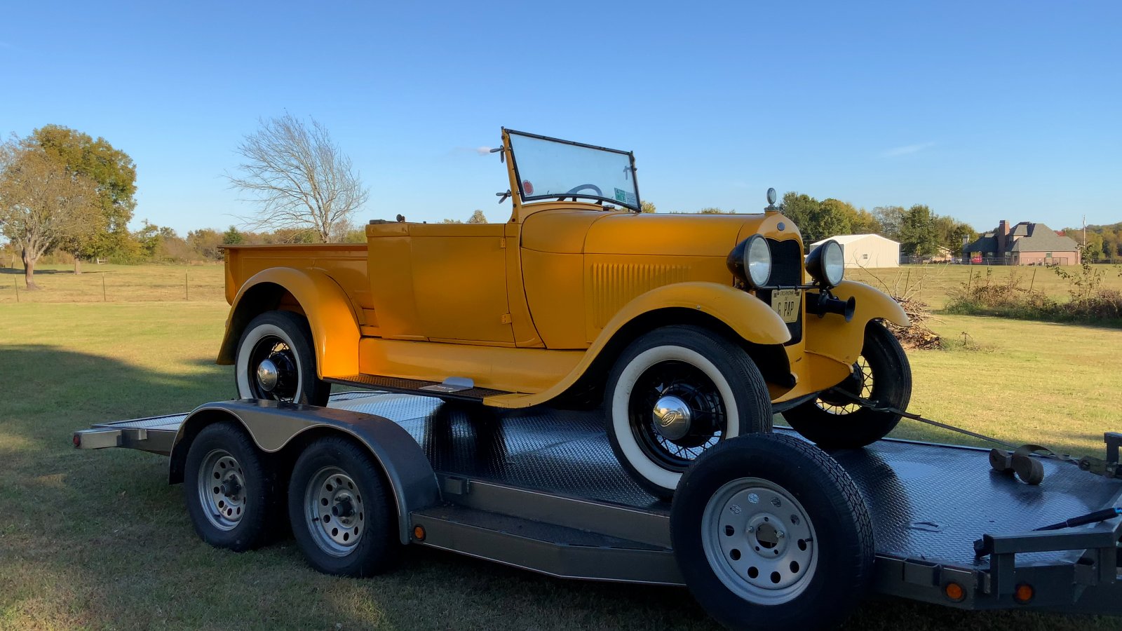

    Scored this cool little RPU last fall a few days before we left for TROG.
    It was built back in the 70s with a donor pinto, they used the pinto motor/trans, rear axle and the front disc brakes. Was updated a little bit about 10-12 years ago to go to The Hamb drags then put back away until I got it. I'm changing some things on it to make it a little more traditional but keeping the motor and rear axle.

    It had the stock pinto disc spindle welded onto a model a spindle kingpin section. Weird deal to get the disc brakes. But I yanked that because the front wheels were way out past the fenders and it looked goofy as heck!
    I had a drop axle I grabbed last summer from a buddy, and then dug around the shop until I found some 39 spindles, 41 backing plates and drums and a loose drag link. I put it all together and used the split wishbones they had on the pickup and got it all back in there. It lowered it a couple inches and got the wheels into the fender wells a lot better.
    Then I grabbed some ol' 7.50x16 Coker classics for the rear, it has a huge fender to tire gap... and the spring has been reverse eyed and had some leaves swapped to the bottom. but man its way up there.
    Looking a little better! LOL!
