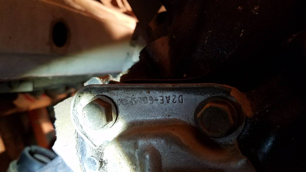

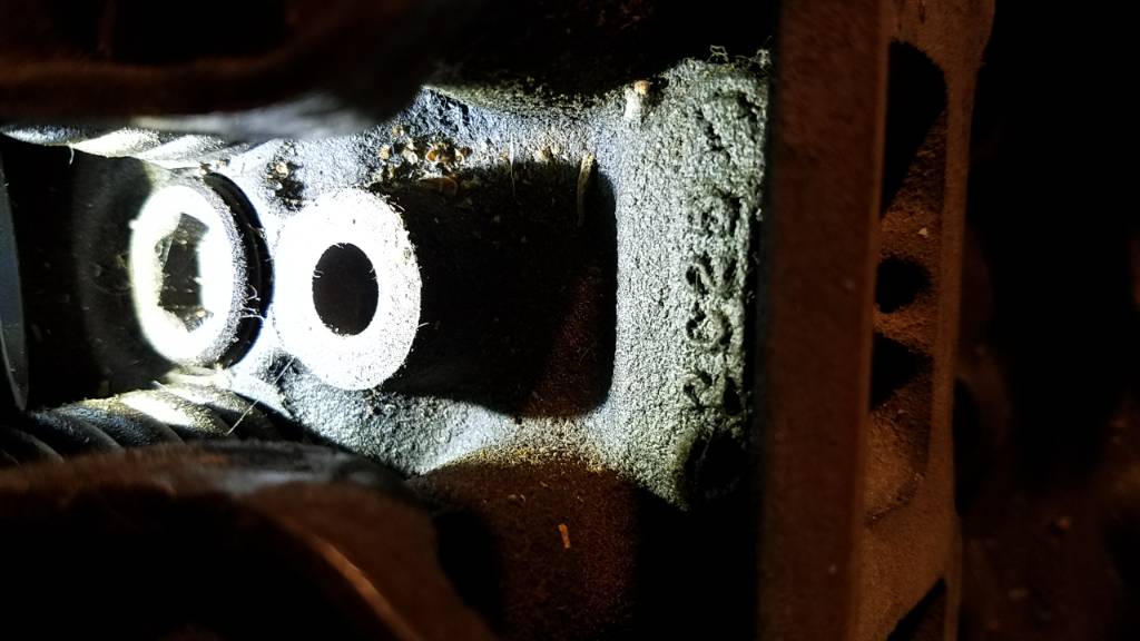

    Hey there.. I'm in need of help.. again.. so here's what I got.. it's got 6 bolts per head
    Intake manifold- edelbrock performer 289
    Water neck C3DE 6592 sheffield
    heads cast D8oe (bottom)
    2c25 & 2c27 (top)
    Timing pointer D2AE-6023?-AA
    Timing chain cover D2OE-6059-AA
    Engine code? CB 173?
    School me please..

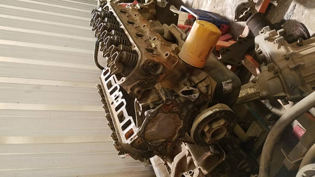

  2. '78 or newer (probably no newer than about '82) 302. Should still be a 28oz imbalance, although I'd verify that. With the rear-sump pan, probably out of a Fox-body car (Mustang, Fairmont).

    yup, 70s 302, could be a mismash of parts. Looks more like a truck or econoline pan, to me.

    I agree with squirrel - looking at pics. d-2 is 1972 year code and c is a1960's most likely carried over items.

  5. Yeah, could be a truck/van motor too, although those usually have a 'T' in the casting numbers. The Fox-body cars used the shorty oil filter, the long filter could be a clue. Do I see a rebuilder tag on the block by the drivers side motor mount?

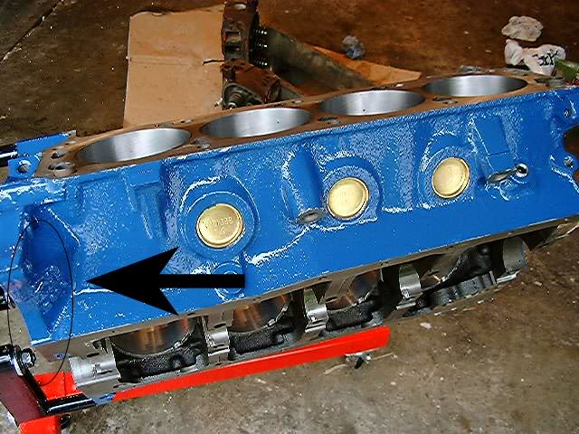

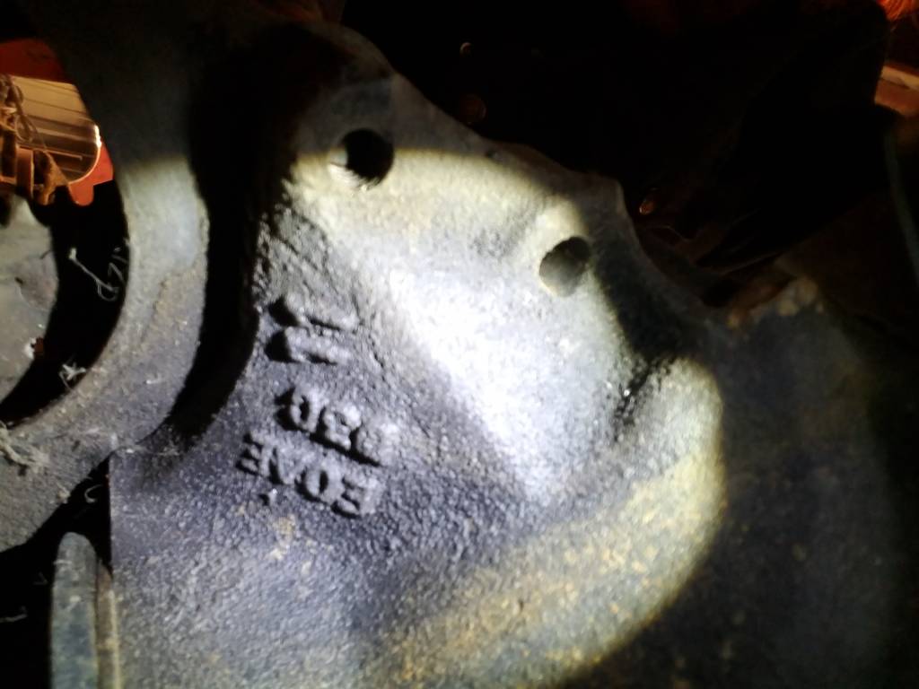

    also, did you look here for the block casting number? or just below the point of the arrow, above the oil pain rail.

  7. Everyone is correct with it being 70's but that is definitely a truck pan and not a Fox Body.

  8. Upon further looking, it's a '79 or newer block as it lacks the cast-in clutch pivot mount. Jim may be right, this could be a mash-up of parts... If a rebuilder has had it, it could be most any year. Check to see if it has a two-piece or one-piece rear main seal; the two-piece was used until November '82, one piece after that. It's also machined for the in-block dipstick, which likely makes it a '80s block.

    1980 or later block. Could be the original heads on it? I don't know how often they changed the head design.

    one of those heads says 2C25, doesn't it? that would make it a March 25, 1982 casting date.
    There might be a block casting date in that little circle that we can see the edge of, above the 11, near the block casting number.
