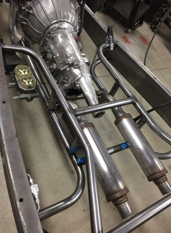

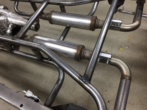

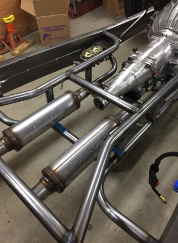

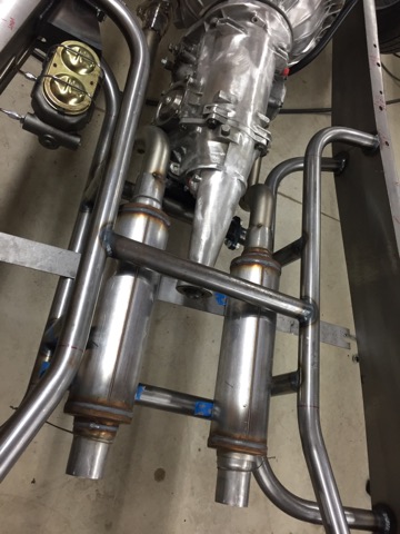

    IM003040.JPG IM003041.JPG IM003042.JPG Here is mine for what its worth.
