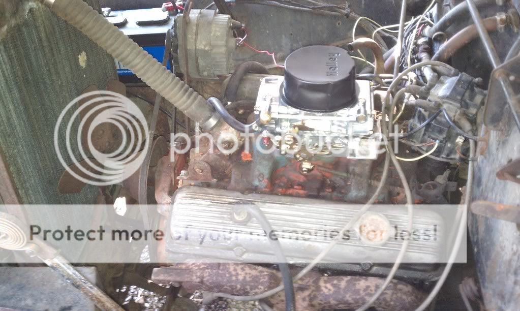

    Once again, looking to the HAMB for help. The sbc in my truck has some old finned aluminum Corvette valve covers. The vents were originally connected to the air cleaner, but I'm looking for a cleaner option.
    Ideas or pics anyone? Here is a pic of my nasty old engine.
    Thanks in advance

    Show a pic of the other side valve cover.

    Heres a pic of the other side;

    I must say I have never seen a universal flex hose in full extension like that before.

    Ok this is the PCV valve in the grommet on the valve cover. The hose should go to the base of the carb and not to the fender well someplace.
    The elbow is where the air enters the engine. You can get away with a standard type breather on this side as a place for the air to enter the engine.
    I can't help with a breather or a part number to fit that size opening but I'm betting that they are out there. Pull the elbow out and measure it to find a push in breather that fits the hole which is smaller than a lot of the push in breathers.
