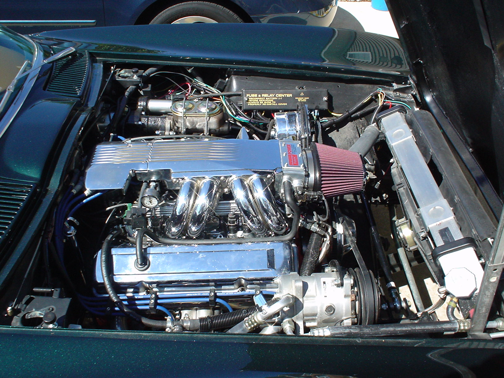

    That doesn't feed the intake manifold. It permits hot water to escape the manifold and permit better cooling on the rear cylinders.
    You can see the hose on my engine coming across the valve cover.
