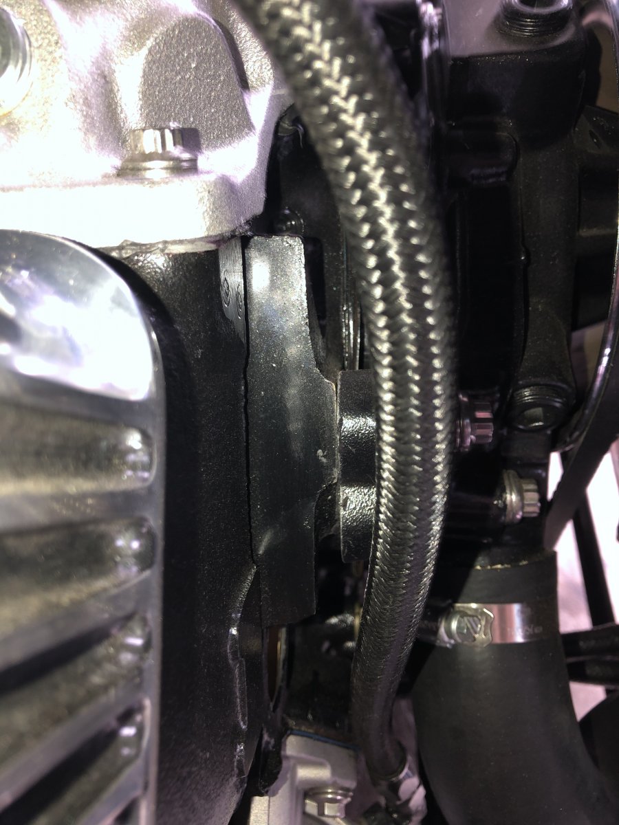

    thanks Dave...I have a bit of an oil leak that I thought was coming from the rear main seal, but yesterday I went underneath to look closer and it looks like its actually coming from the front of the motor...not a bad leak but enough that I want to correct it...pulled the pan down and it has one of the blue rubber neoprene one piece gaskets. I looked it over very close and there was no oil on the mating surfaces of this gasket and the area that seals the bottom of the timing cover looks to be compressed enough to seal so Im thinking it could be coming from the front crank seal. I finally found a Timkin seal and will get it changed out in the morning....if this dont stop it I will go ahead and replace the pan gasket with new one...still relearning the SBC....spent a lifetime with Fords and Mopars with just a scant few Chevies mixed in, so didnt realize there were many changes throughout the years...makes it a little confusing....thanks for the help guys. thanks for the tip on the gap between pan and cover...im headed out to check this right now.

    Dave...thanks for the info....looks like it is the thick gasket...pros and/or cons? 69F5CE5F-5231-4786-B6AA-F2C10F8826AD.jpeg

    Well....found the problem. Went out this morning to change the front crank seal and noticed the leak was actually at the front of the pan/timing cover area. I could actually move the gasket around by pushing on it. Pulled the pan down and it has the thin type Felpro 1 piece blue neoprene gasket. Pulled a new one at the parts house and the thick one is WAY to thick to fit. So I bought a new Felpro 1 piece gasket and a tube of Permatex gasket maker. put an 1/8" thick layer on both sides of the gasket at the timing cover area and reinstalled the pan...will let it sit overnight and try it tomorrow. If this dont fix it , though its a brand new stamped steel pan, I will buy a new pan or even a cast aluminum pan if needed. Hopefully the gasket maker will do the trick....has anyone tried shimming the gasket at this area? maybe 1/16" X 1/4" by the length piece of neoprene in this area and maybe adhering it to the gasket to make a tighter fit? looks like this has been a problem area for others in the past....just thinking
