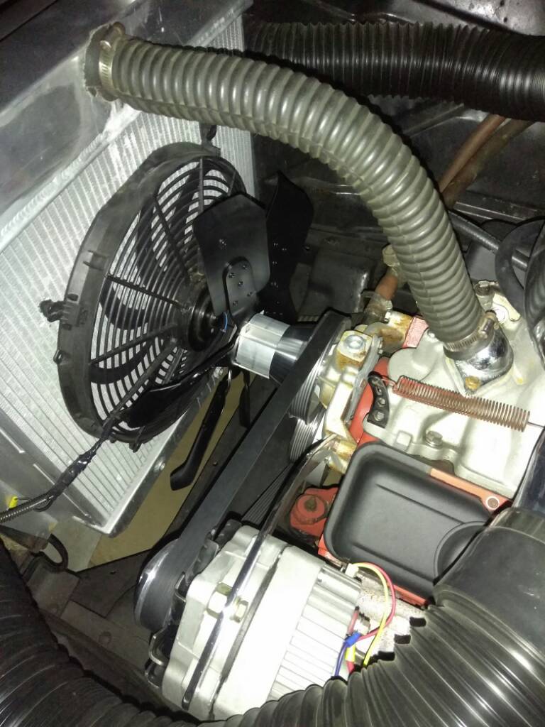

    I drove the panel 10-12 miles today around town to see how it would act. Remember, I have only removed the mechanical fan thus far and the electric fan is still mounted, though it's only pulling 1700 CFM and I really don't think it's doing anything at idle to help. So I'm going to be ordering a reverse rotation mechanical fan and ditching the electric fan.
    The temperature hand never got above 165* while driving. It creeped up to about 170-175 at red lights or a series of stop signs. Granted the temperature today was in the low 60s and I don't have any type of functional fan, I wanted to see how it would perform. If I had driven it in these temps last week, I would've been around 230* by the time I got home driving the same distance.
    Now, before you ground me (haha!) I know 160-165* is not an optimal performance temperature. I'm going to wait until the temp goes back up here in KY and drive it a few more days to make sure everything stays the way it is. If it does, it looks like I will need to swap back to a 180* or 195* thermostat as 160* is too cool. Honestly, right now I'm just glad to see my gauge didn't cross 200*.
    I have still yet to 100% verify the accuracy of my gauge, and trust me I will be doing this in the next couple of days as well as adding a mechanical fan. It seems from opinions I can't go wrong with a steel or flex fan so I'll order one from Summit or Amazon tomorrow and hopefully have it here by the weekend.
    From this driving experiment, it seems all of my troubles have been airflow related (idiot like myself installing the wrong fan) and not a coolant flow problem.
    I would have never have gotten to the bottom of this without you guys. I honestly can't thank you enough. I will keep you guys updated as I get the mechanical fan mounted and let you know how it does in warmer temps, but I can ensure you things are 99% better already

  18. 55panelwagon
    Joined: Apr 28, 2017
    Posts: 62
    55panelwagon
    Well fellas, I've opted to go with a higher CFM electric fan as opposed to a mechanical. As one of the above posts had suggested (and I didn't notice) the mechanical fan did not line up properly to the radiator and I have no room for a water pump riser.
    I drove the panel today and it ran between 165-175* during normal and highway driving. When idling or sitting at a red light, the temp would rise to around 205-210* with no fan use, and would slowly fall back down when I would kick on the electric fan.
    So, I have two quick questions.
    1) Is a 35* rise in temp normal under idling?
    2) How quickly should my electric fan be lowering the temp at idle?
    Thanks guys.
  19. Hatchet
    Joined: Jan 26, 2017
    Posts: 36
    Hatchet
    With no airflow? Yes, that's not at all out of line. It sounds like you need a good cfm fan, and I would not wait to throw in a 195* thermostat. From your reports it appears your problems were airflow related, which is good. I have no idea what that engine compartment looks like, but...you may look for simple ways to vent hot underhood air also.
  20. 55panelwagon
    Posts: 62
    55panelwagon
    The engine bay is basically a coffin. Huge inner fenders, motor tucked tight between frame rails, not much air can flow. It's basically an oven with an engine inside. Lol. But I agree, I believe the air flow was the problem. I can turn on my electric fan and the temp will slowly fall, I'm just not sure if it is dropping quick enough.
  21. Hatchet
    Posts: 36
    Hatchet
    A fan with sufficient CFM should make a big difference. They have fan thermal switches available that very easily install in radiator hose- sometimes they are included in fan kit.
    If you are switching it manually, I'd recommend that you turn the fan on anytime you are not moving, or even driving slowly- don't wait for temp to rise before switching on fan.
    Maybe take a hard look at inner fenders and see if you can create some vents towards rear of engine bay without creating other problems.
