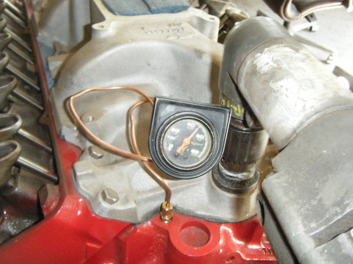

  17. Not my first rodeo here.
    I Usually see 30 psi or about 1/2 that with the drill. Another weird thing is I’ve not seen one pump up and oil the top end that quick.
    But it’s kinda weird deal. I’m assembling, but someone else is doing secret prep to the parts I’m being handed.
