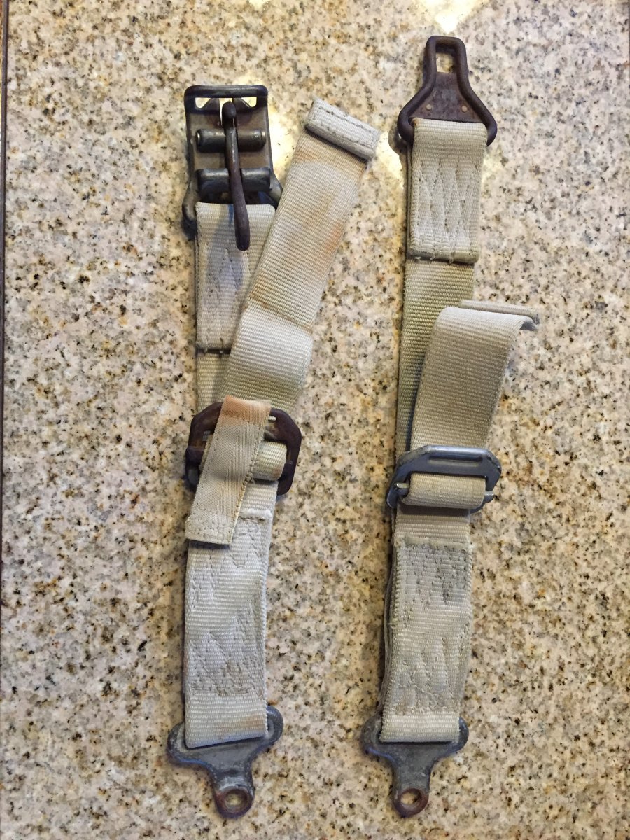

    I have the same belts in my 1960 bugeye. It was taken off the road in 61 used as a hill climb car in southern NY northern PA. Had a makers label on on strap but was illegible. They do look aviation related, but mine had the anti sub strap (crotch binder) don't know if military belts used those. But stick to your story. An the flames front, I think they take away from the lines of your design. I could see it with a dark maroon frame, orange engine, and a cream body.

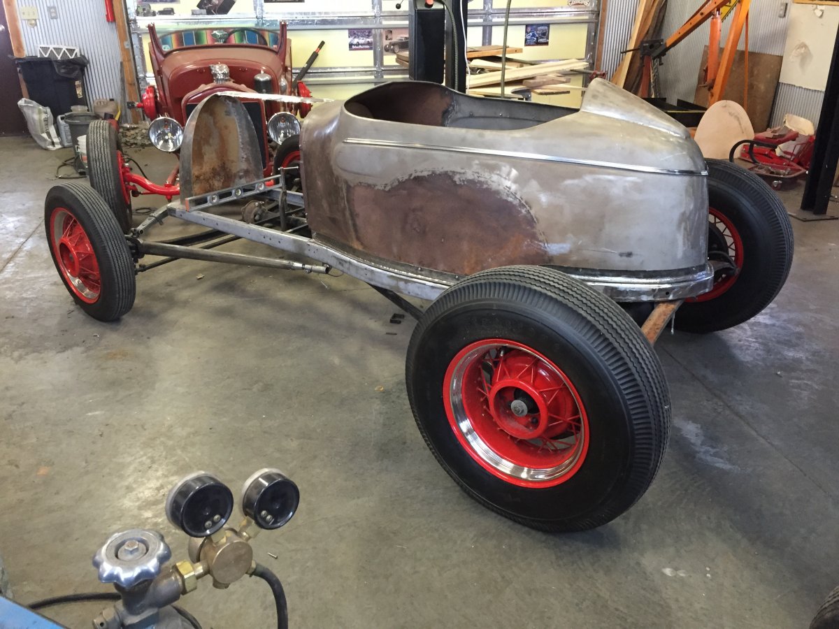

    All set up. I can not believe how many people are digging this thing. It is so weird and my sheetmetal work is something to be desired but the hotrod and race car crowd really think its Kool! IMG_2569.JPG IMG_2570.JPG

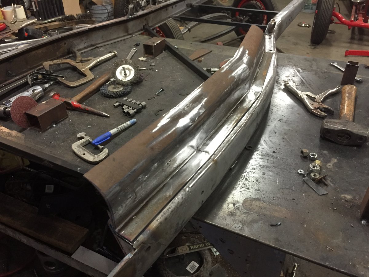

    Thinking about how to fab up a foot well/floor. This is a bit overkill but I think this is what I'm going to do. I have several pieces of Ford torque tube that I have cut in quarters then welded to a piece of angle iron. I will cut it to match the contour of the frame and bolt it to the bottom of the frame and filled in in the center with 16 gauge. IMG_2575.JPG IMG_2576.JPG

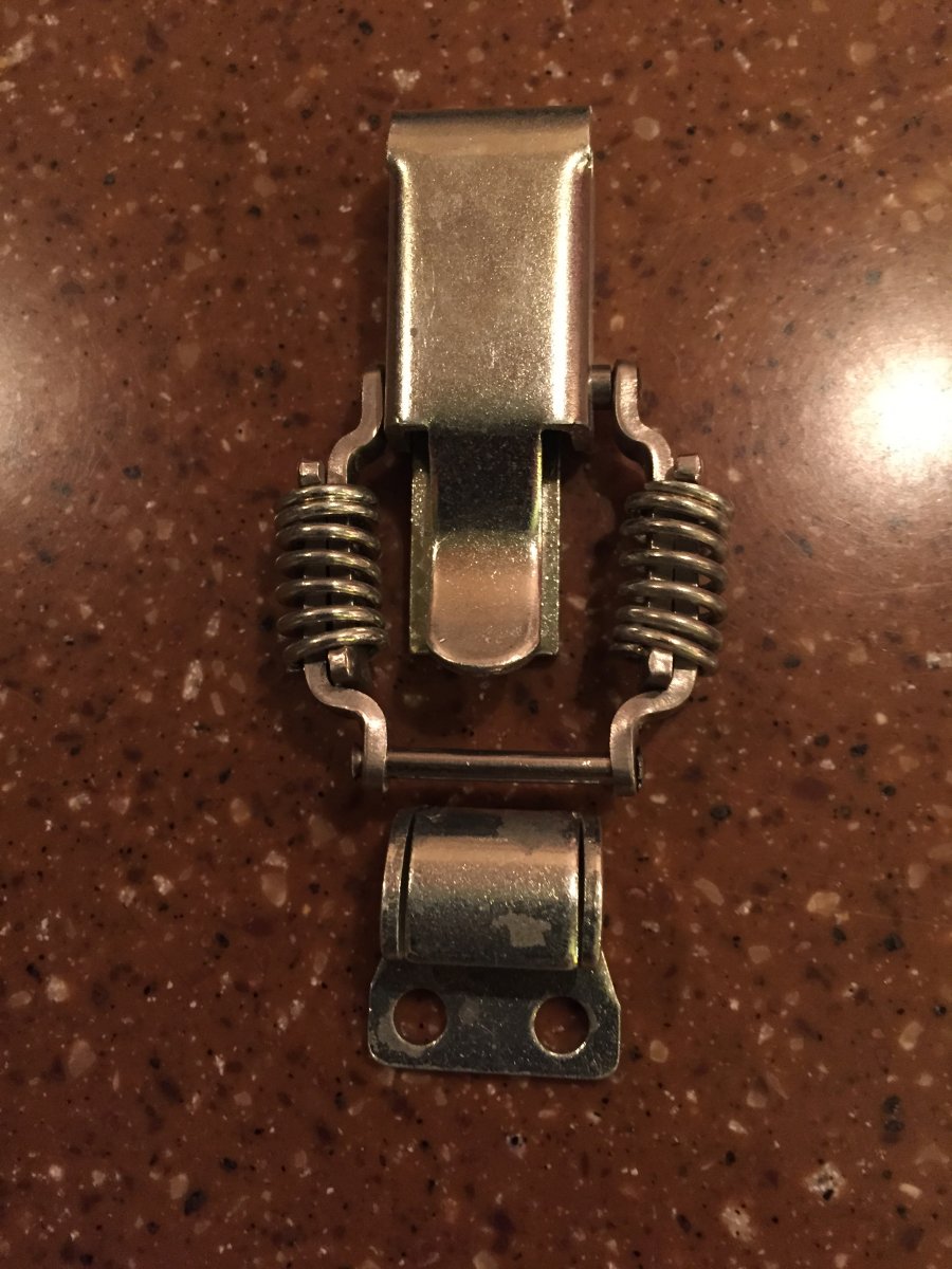

    IMG_2596.JPG A friend of mine is doing metal work on a 59 el camino, the owner of the car is a kool guy. We were sitting around talking about the single seater and he asked if I was going to run a hood. I told him I wanted to do something simple and use lunch box latches to hold the top to the sides. He says I have some of those I'll give them to ya. So the other day he gives me these latches and tells me he had bought a bunch of military surplus years ago and these were in with all the stuff. They are funky old n.o.s. latches that were never installed on anything. They are not the cleanest looking latches but they are funky enough to use.

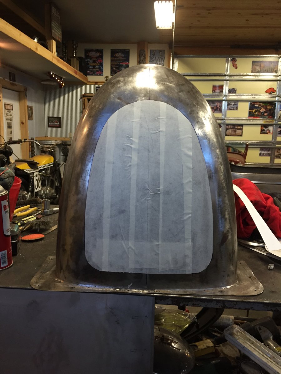

    Want to get the hole cut in the track nose and make a grill. Whats the thoughts on this shape? Have a couple buddies that say perfect and one buddy says it needs to be taller. Where it sits the hole will already be above the radiator. Give me your two cents. IMG_2603.JPG IMG_2604.JPG IMG_2605.JPG

  25. Grill size looks good to me. I may have missed this in a post but did you widen the rear wheels?

    What are your plans for front dampers? Will they have any impact on surround grill appearance?

    I wouldn't make it any taller, I think the proportions are correct as it is.
