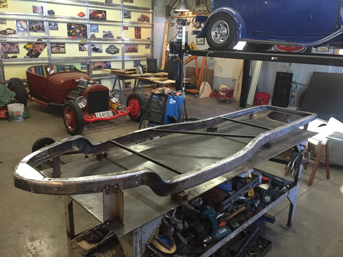

    Started cutting on my frame this afternoon. Started at the cowl and started pushing the frame out to match the body/subrails. IMG_2485.JPG IMG_2486.JPG IMG_2487.JPG IMG_2488.JPG

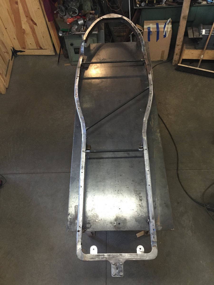

    Got my frame rails both ruffed in this afternoon. IMG_2489.JPG IMG_2490.JPG IMG_2493.JPG IMG_2494.JPG
    brEad, Stogy, Blues4U and 1 other person like this.

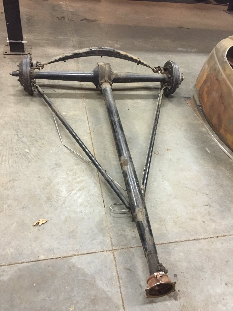

    brEad, brad2v, Stogy and 1 other person like this.
  7. Seem's like your moving along fairly quickly. Looking good!

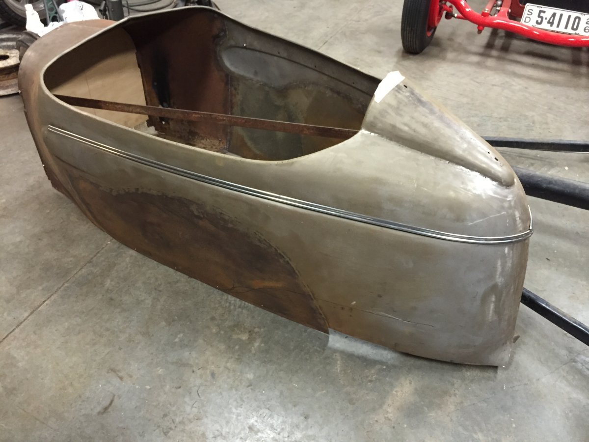

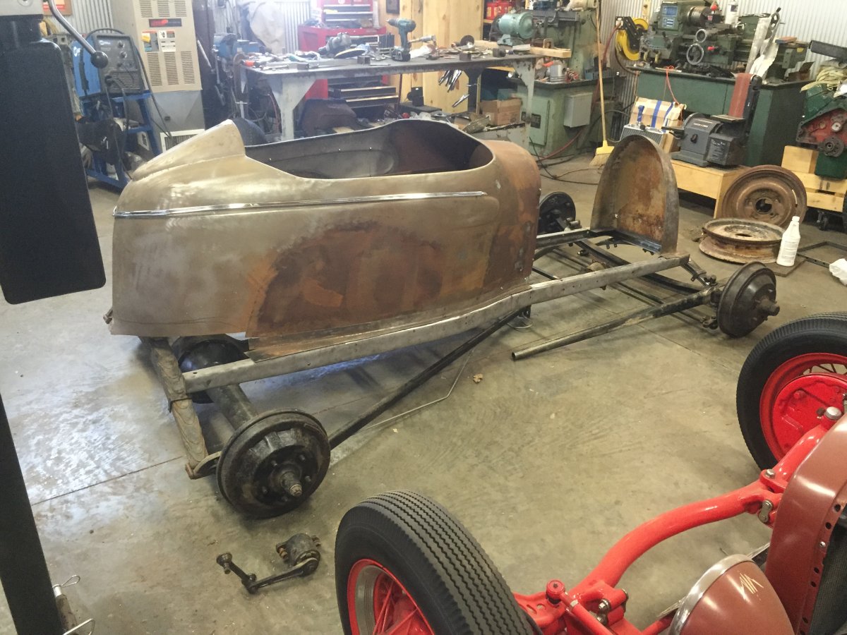

    A buddy had some 46 front fender stainless so i'm going to use it! Damn it looks Kool!! IMG_2503.JPG IMG_2504.JPG IMG_2505.JPG

  13. sodakmini
    Joined: Jun 28, 2011
    Posts: 518
    sodakmini
    I really dig it buddy! Definitely adds something kool and different to the build

    might as well use the holes that were already in the fenders.

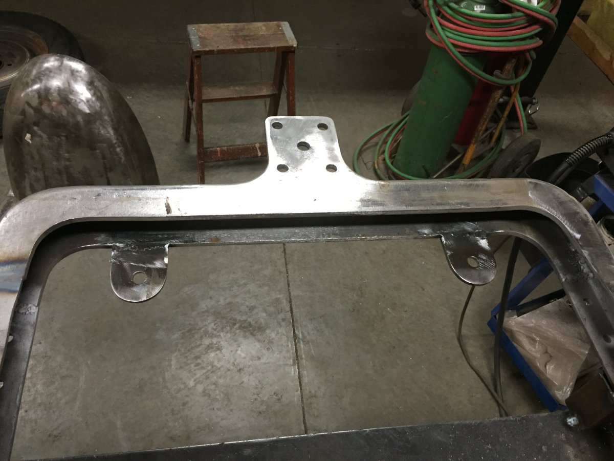

  15. rusty rocket
    Joined: Oct 30, 2011
    Posts: 5,231
    rusty rocket

  16. the trim looks great...real nice touch

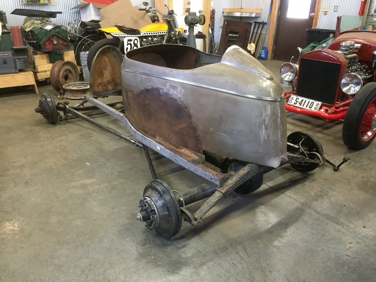

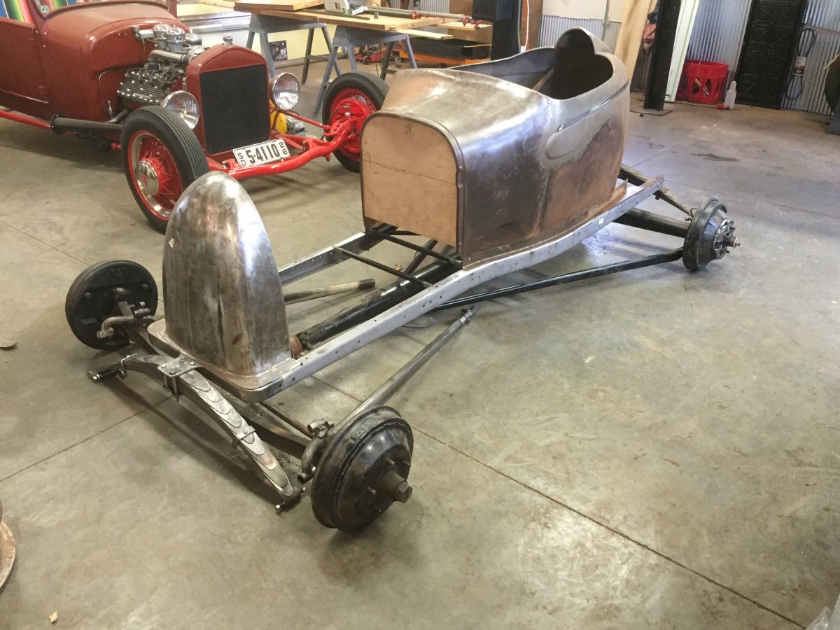

    rusty rocket

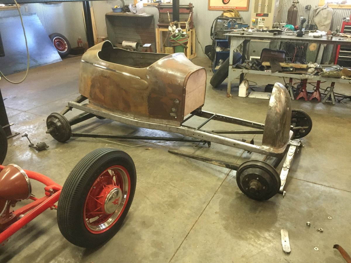

    I did a bit of mocking up this morning. IMG_2510.JPG IMG_2511.JPG IMG_2512.JPG IMG_2513.JPG

    Did a bit more pinching of the frame this afternoon also cut the tail end off and made a kickup. I will then weld the tail end that I cut off back onto the kick up. IMG_2515.JPG IMG_2516.JPG

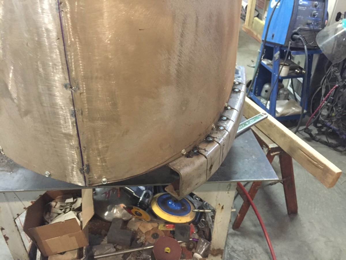

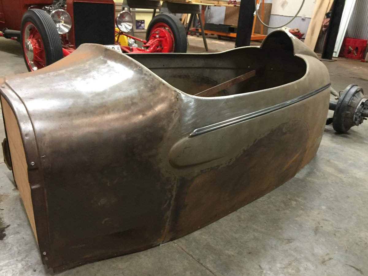

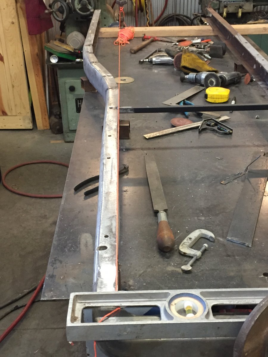

    Made a template on the tail end to make sure the sheetmetal is the same on both sides and then started bending the frame around to match the body. IMG_2519.JPG IMG_2520.JPG IMG_2521.JPG IMG_2522.JPG

  24. Atwater Mike
    Joined: May 31, 2002
    Posts: 11,618
    Atwater Mike
    I'm really following this, good thinking on the lower body flanges. (I was thinking 18 ga. angle and shrinking!)
    Great outcome...
    Rear spring mount: Short tube member with flat perch plate beneath? (if transverse rear spring is retained)
    If you do use Dodge pass. 'selector' type trans, a simple one-stick linkage can be made up: flat plate bracket fitted close to side of trans. Tubular 'stick' with single pole button at top. Single wire goes down tube to a 12 volt relay, ground activated; power to an early Chev starter solenoid, mounted inside frame rail. Short cable connects solenoid plunger to selector arm. Push button to pull selector arm to engage1st/reverse rail inside trans. Selector has return spring inside trans, so let go of button, stick now shifts 2nd and 3rd. Fastest speed shifts in the world! (good ground is ensured by attaching a flexible ground strap from bottom of stick to an attaching bolt...strap can come from hood ground strap on BMW in wrecking yard. Or outside yuppie watering hole)
    I did this one on a '31 Plymouth PA coupe with hemi and selector trans. Called it an 'electric shift'! Took 2 hours to make it...

    My plan is to get one side of the frame done make a template and do the same on the other side. I will add material to connect the two together. My other thought is to add a plate in the back to locate the spring as far back as I can get it and still be under the body. Thanks for the info on the transmission, I really would like to get a top load three speed though.

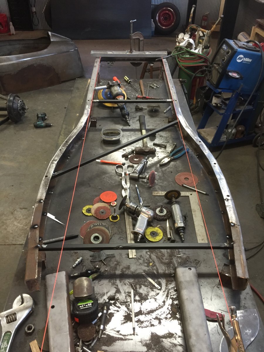

    I got the back half of the frame ruffed in and did a little bench clean off. IMG_2527.JPG IMG_2529.JPG IMG_2530.JPG IMG_2532.JPG

    All i can say is WOW. I was going to suggest using the stainless trim pieces to give it a 'finished' look, but you beat me to it.

    Thanks man. My buddy bought an older guys 42-48 stash, He had a bundle of front fender trim and out of all that trim there was one good left and one good right. It was meant to be:)
