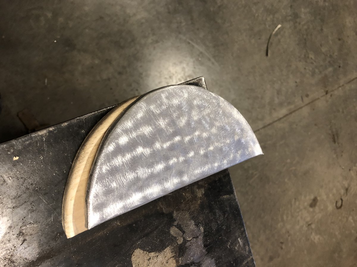

    rusty rocket
    Made a wood buck and hammered out this little cover for my head rest. I am going to make a hinge at the bottom and magnet catch on the top, it will fold down so I can access my gas tank neck. BA38675D-1B01-43B7-81F9-2ACC46B273D4.jpeg 88721F91-1BAA-4D8B-831F-879BC393FD91.jpeg

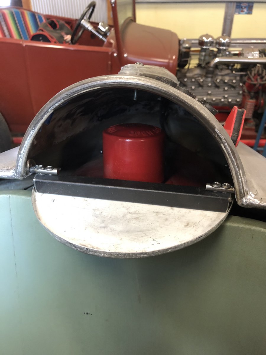

    rusty rocket
    Got my little bottom hinge built today. CC2F2F63-914D-49BE-9ACB-2C3D4846A7D5.jpeg Now I just have to add the magnetic catch on the top.

    Being a trim carpenter I’m a better wooden seat builder than a metal seat builder!:p

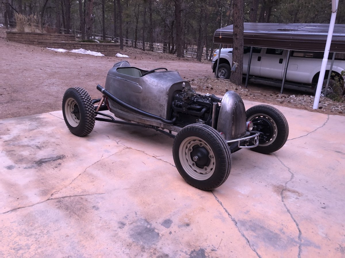

    DROVE IT!!!!!! Took it for a spin up and down our road have quite a few leaks to track down but what a god damn rush!!!!! Went thru all three forward gears and reverse with no problem. Sounds pretty damn good thru the 3” straight pipe and cackles Like a sum bitch when ya let off!!!!!!! BEA6A680-0B65-4BE0-9A79-5E34CBFFEC33.jpeg

    What kind of temps did you get? How's the oil pressure?

    Temp went to 160 and oil pressure at start was 60 and then down to around 40 after it warmed up a bit.
