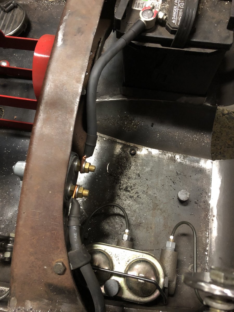

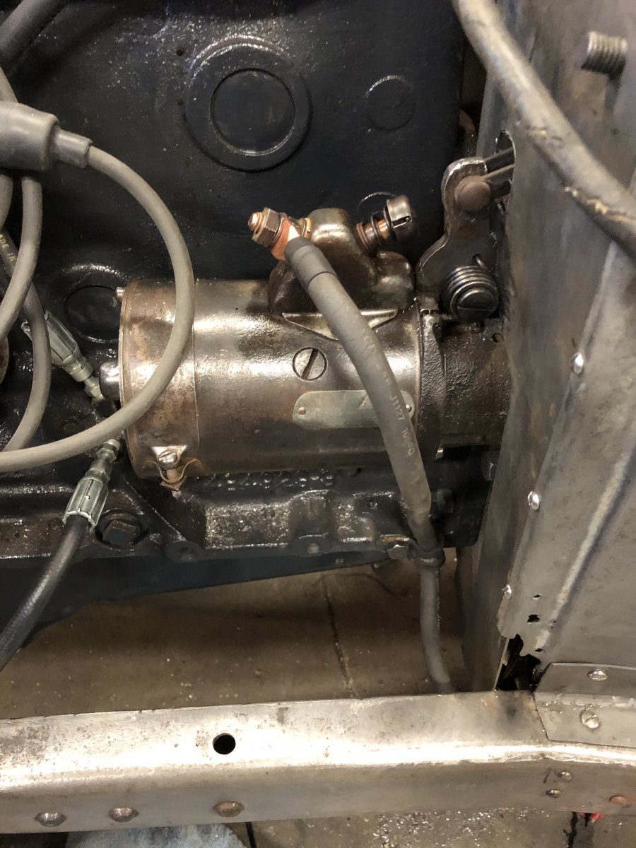

    Since my starter engages and turns over the motor it was time to make up some battery to starter cables. I ran the cable inside the frame and came out just in front of the firewall and up to the starter. 56D56EB9-E400-47A3-B29F-5465304C6C10.jpeg In back I came out of the frame to a battery disconnect and then over to the battery. D29B3DD8-3E86-45C8-8660-2CAE9E1B8DFE.jpeg

    Rusty, I have been following your build and your doing a hell of a job!

    Are those home made cables or store bought?
    If they are home made you did a superb job on them.
    plym_46 and Stogy like this.

    I built them myself. It wasn't to hard I bought little solder pellets at napa to stick everything together. It was really very easy.

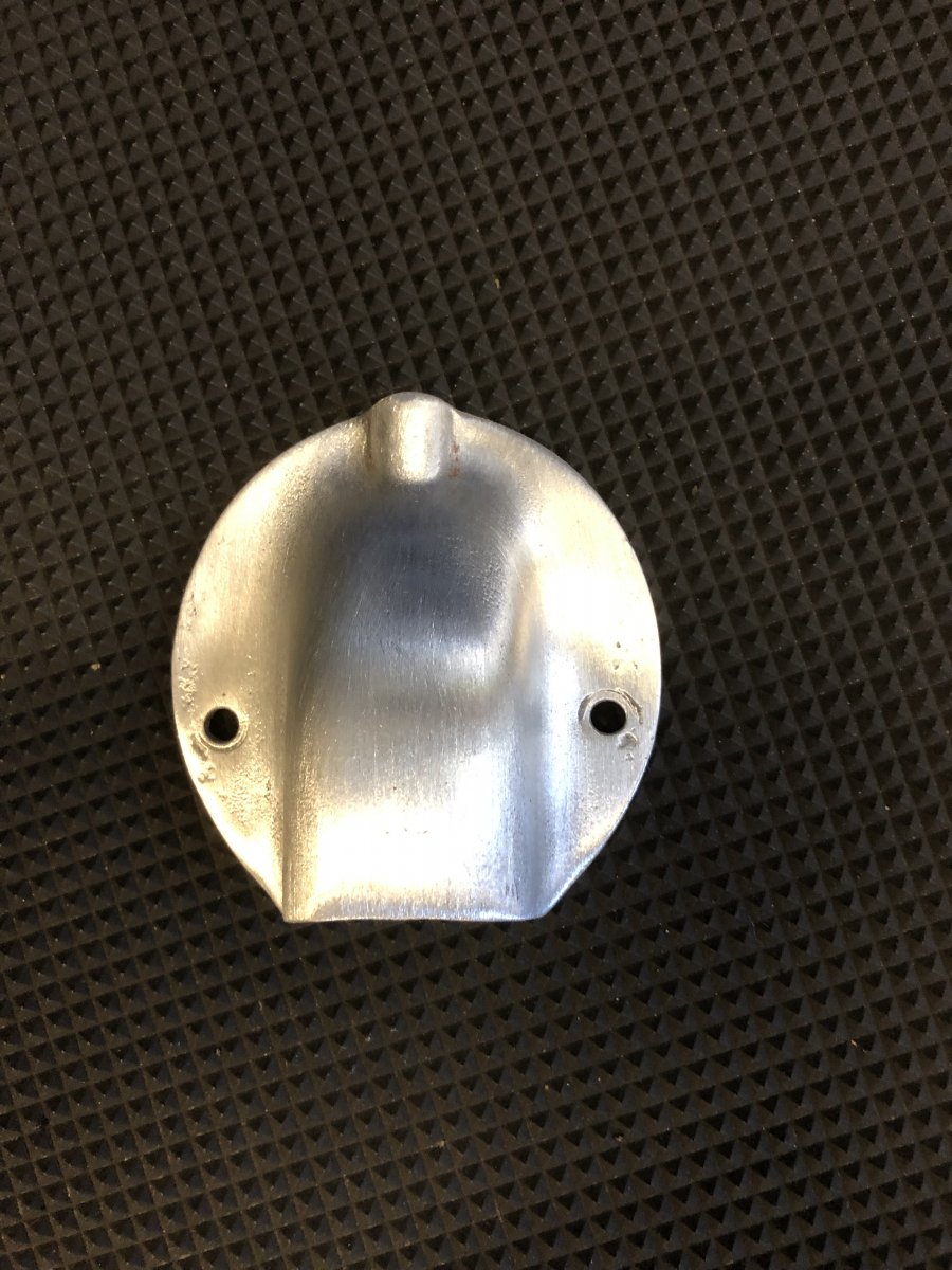

    This last weekend I went to my wife’s aunt and uncles farm on the other side of the state to tear down an old barn for the barn wood. Of course I found something to use on the hot rod.
    I found this piece on the siding and it covered the main power line coming into the building. It was covered with old red bar paint, I did some sanding and scotch brighting to make it look a bit better. AAFD9870-5472-4A3D-B2D6-EB391967247B.jpeg 8185DEDB-270B-4C39-AFAB-092BC8CAB86C.jpeg

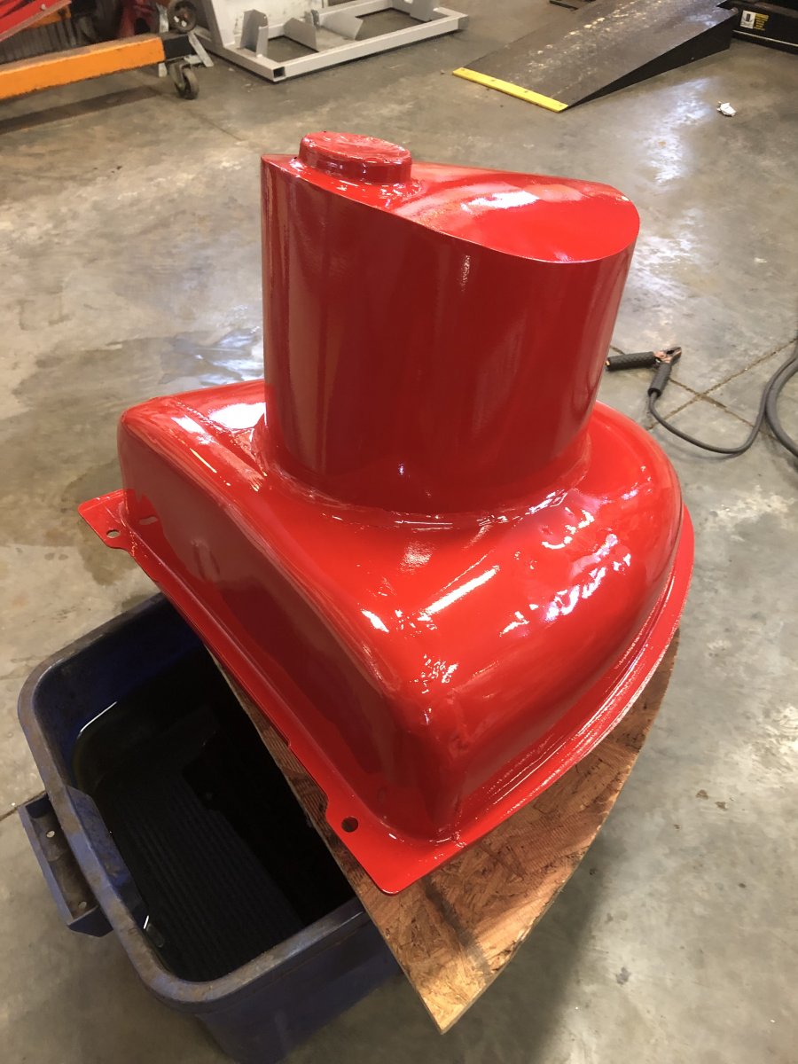

    Got my gas tank leak free, primed and painted. I figured since it started out as a farm-all tractor tank I am going to keep it looking like a farm-all tank so I spray bombed it IH red. AD1C82D5-1349-4CF1-B510-5467D1831834.jpeg C17DD520-22C5-4C49-B06A-C131AC8A5D12.jpeg C64222E1-FF90-4F8D-AC16-ABC9A8CFA6B4.jpeg

  16. So, where are we going to put the decal?:D

  17. rusty rocket
    Joined: Oct 30, 2011
    Posts: 5,231
    rusty rocket
    Hmm if I had one I'd stick it on there!

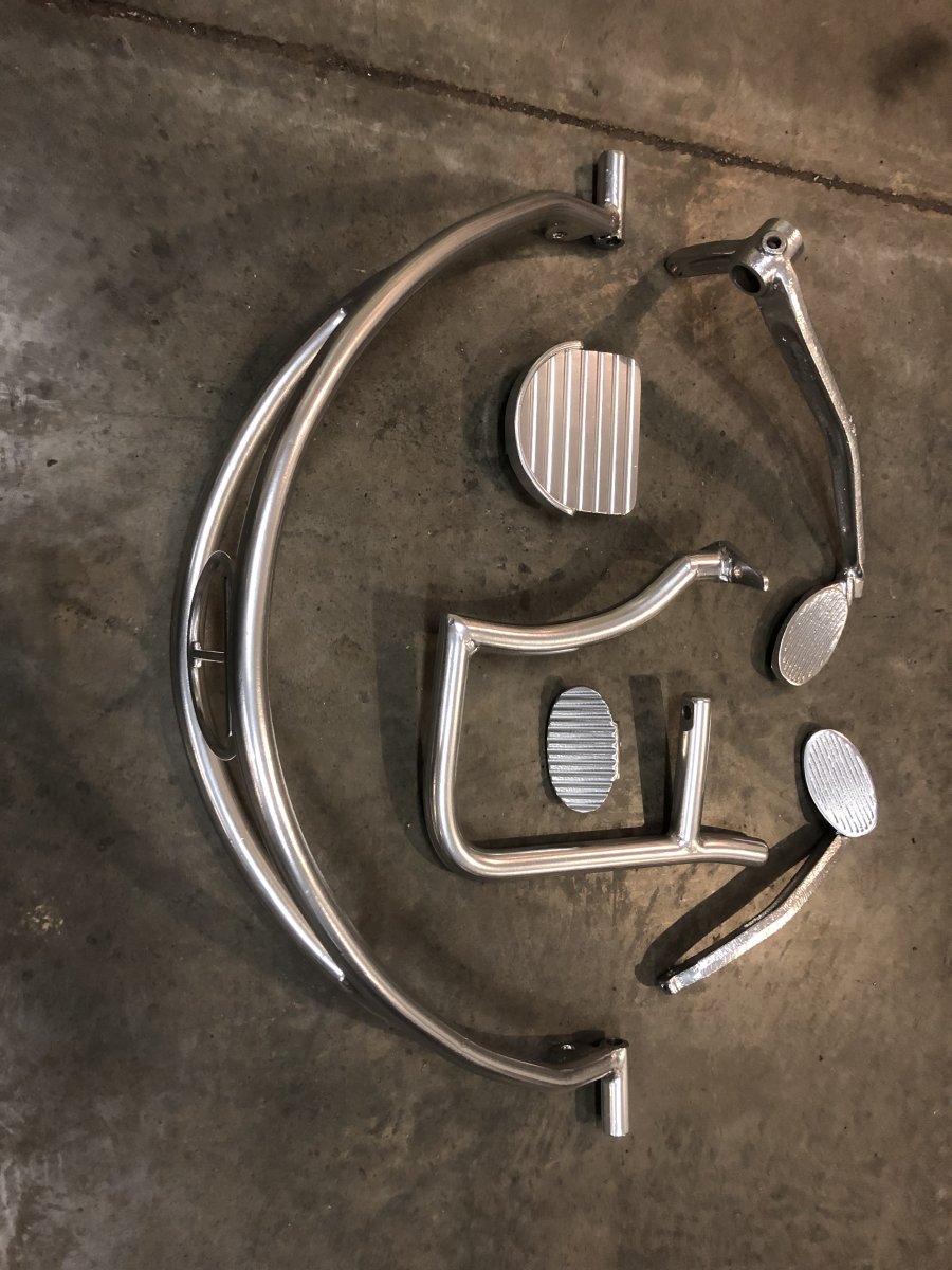

    I have a friend that does powder coating so I sent him my nerf bars, pedals and a few others small parts. Had him shoot them in what they call near chrome without the clear top coat. I think they look pretty good not show quality like chrome but that’s my fabrication and it fits the build. F8382A91-9D1D-4754-A166-510B433833F3.jpeg 06BDAC77-DA84-4323-A60C-46D41957DC35.jpeg

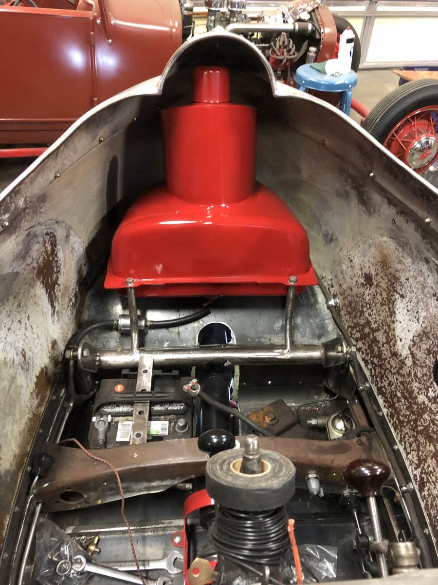

    Got my gas tank poked back in the hole.you can’t miss it that’s for sure. C9C723B0-7F89-42B6-A976-33B789307CD3.jpeg
