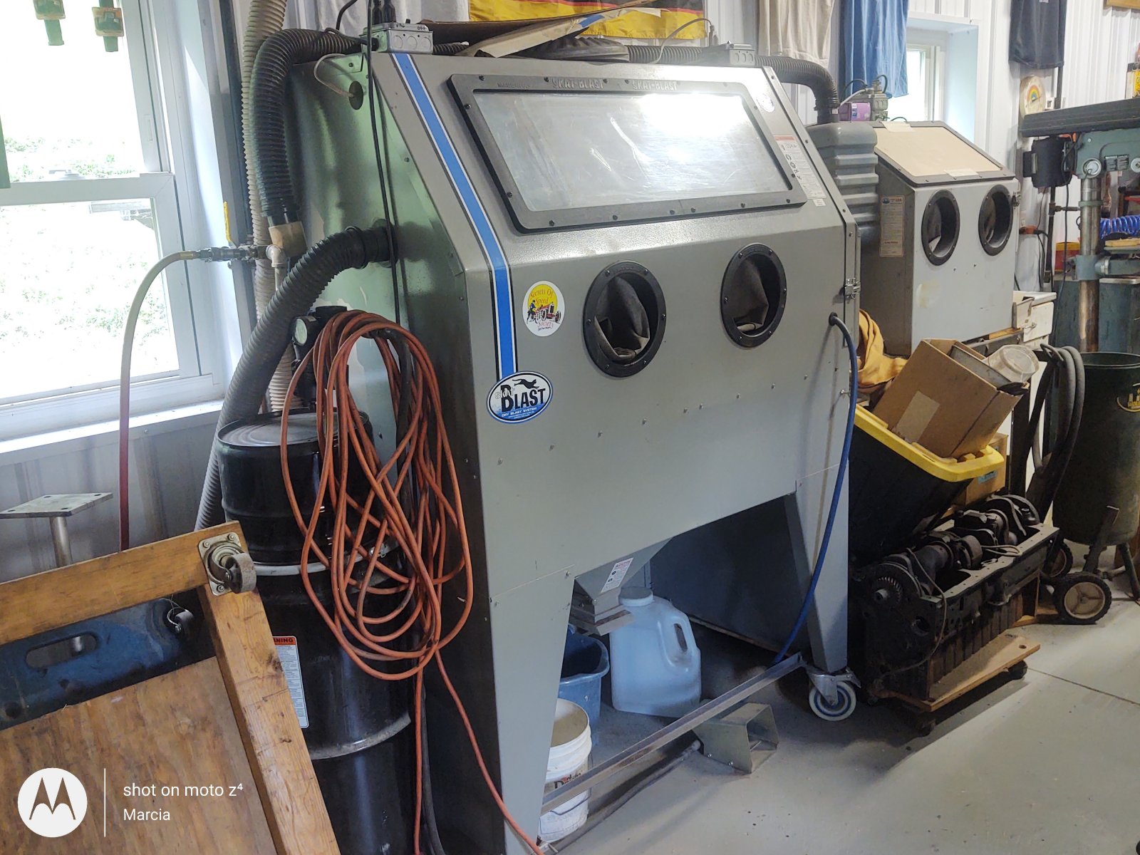

    I bought the big Tp cabinet a few years ago. I love the foot pedal over the trigger. Fast service too. I order all my supplies from them. IMG_20220531_173204939.jpg
    Tman, Truckdoctor Andy and ekimneirbo like this.

    I got tired of the trigger gun on my Barrel Blaster so I just upgraded to a foot petal and gun from them. Used it a couple of times already and I'm happy with it. Of course its not nearly as fancy as the Tip cabinet that @Marcia posted but for the amount I use the cabinet it works fine for me.

  10. Marcia
    Joined: Feb 27, 2009
    Posts: 1,035
    Marcia
    It was a scratch and dent sale. It helps when I'm doing the Model T wheels.
