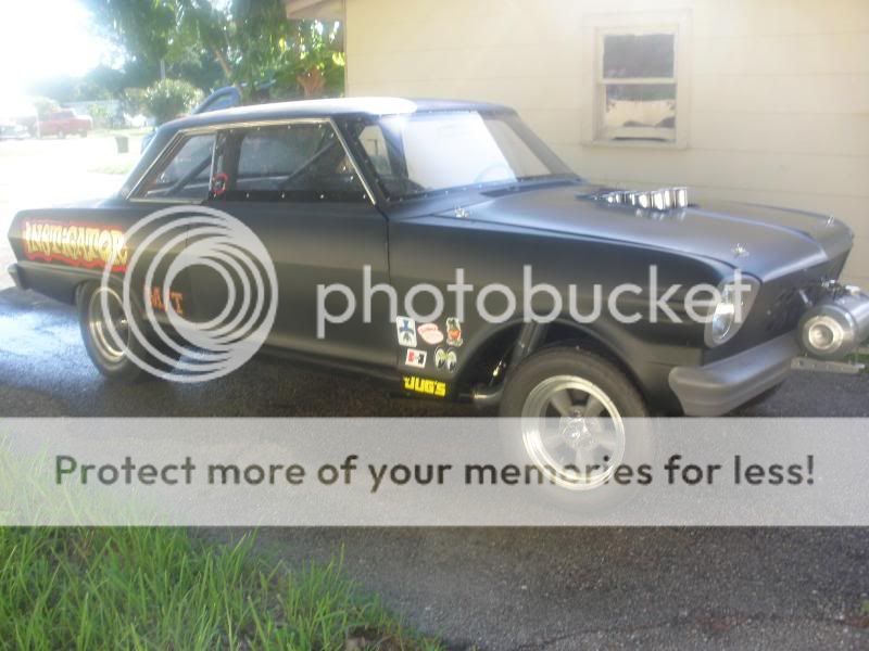

    I have been working on friend and club mate Doc's '63 straight axle Nova lately. Fist and foremost was to get rid of the ugly cowl hood that was on the car when he first put it together. He got a steel hood at the Turkey Run for $10, I gutted it and cut the hole for the Hilborn to stick out. A few other updates were made and we are ready to hit the track again. Mostly getting ready for the Billetproof drags in October. It runs like a bastard with the new engine and the Hilborn.
    Here is the before with the cowl hood
    Mock up of the new steel hood
    Finished product
    The new engine

    We only have 3 passes on the new engine. So far the best is 11.24, but it has alot left in it. We have done some tuning since then, it was running real fat and we put somemore timing in it. It should dip into the 10's.

    I did a racecar hood kind of like that with carb stacks just bearly sticken out,ended up having to put stacks up plus extra 3in. higher because the air flow at about 60+mph over the hood shape I was using pulled air out of stacks right then making a flat spot in the power:eek:
    Air flow can fool ya.

    I'm usually on the other side of the fence on this, but why isn't it a gasser?
    Maybe the wheelbase is stretched a little? Really can't tell for sure in the pictures.
    Larry T
  25. THEKID49
    Joined: Apr 24, 2005
    Posts: 583
    THEKID49
    No it's not stretched. Stock wheelbase. I'm not sure why it's not a gasser either. Seems like everybody is calling a car with a straight axle a gasser. This car looks the part and will perform like one.
