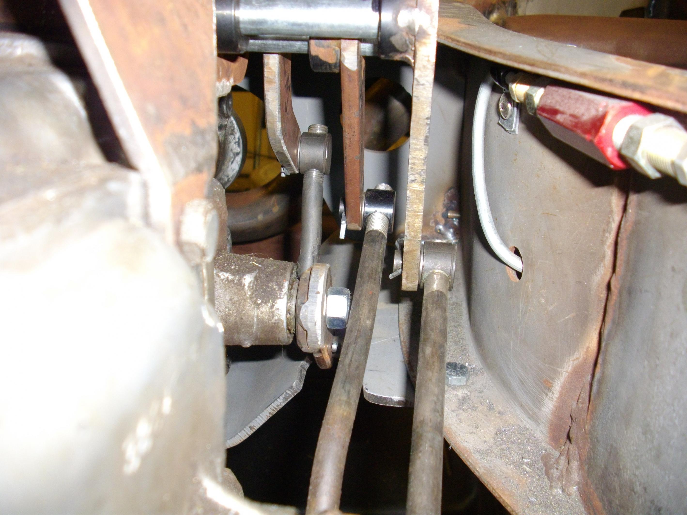

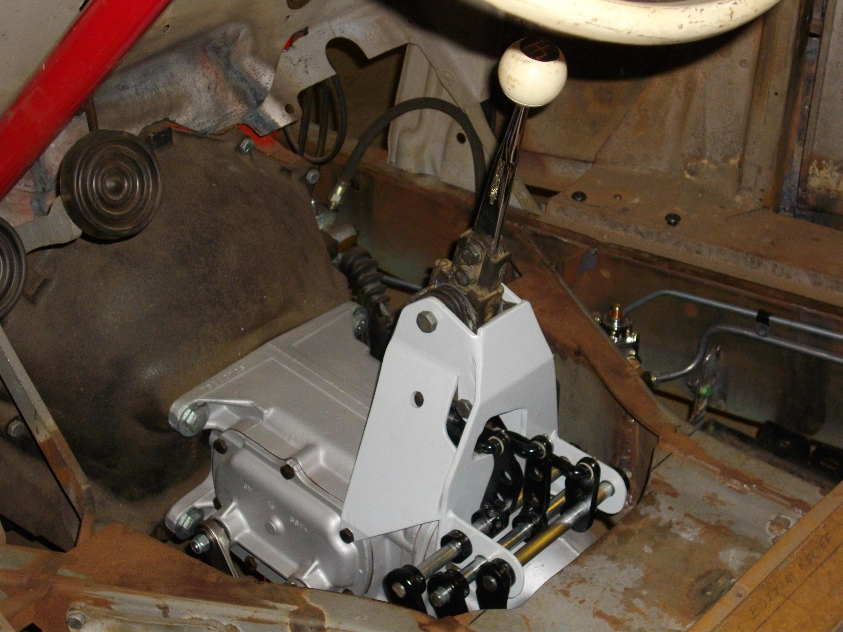

  9. greaser
    Joined: Apr 30, 2006
    Posts: 866
    greaser
    I put an M21 muncie in my 32 pickup using a C.E. x-member. I modified the shifter mechanism using intermediate shafts and mounted it over the trans like a top loader.
    It's pretty involved, but can be done.

  13. tlessard
    Joined: Mar 8, 2012
    Posts: 29
    tlessard
    from Austin, TX
    WOW greaser! That is fully involved. Looks great!

  15. Retro Jim
    Joined: May 27, 2007
    Posts: 3,854
    Retro Jim
    Damn , that's a hell of a lot of work to get a shifter to work !
    Looks really good and should work out just fine .
    Retro Jim
  16. raengines
    Joined: Nov 6, 2010
    Posts: 227
    raengines
    from pa.
    nice job greaser!!!!
