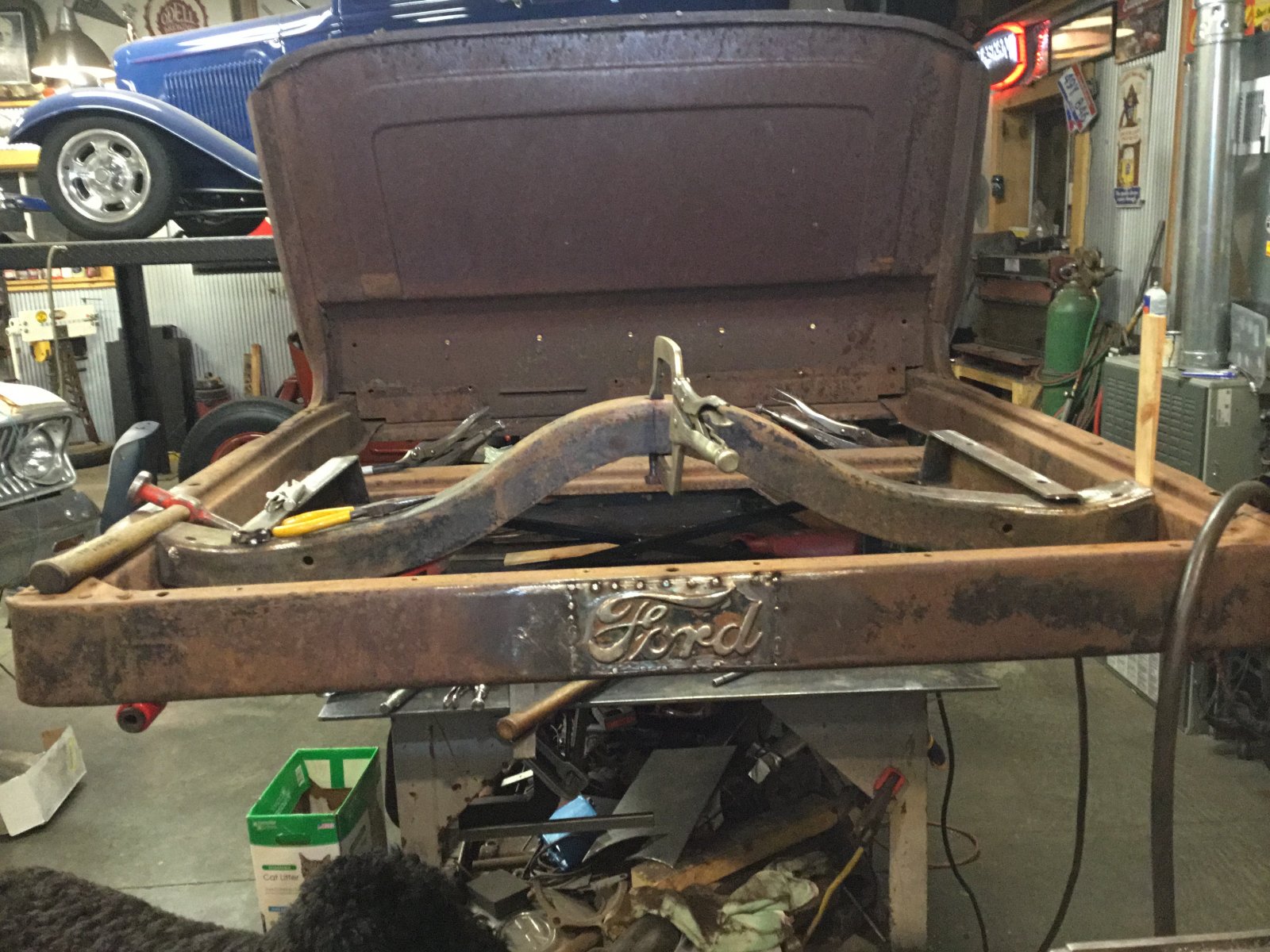

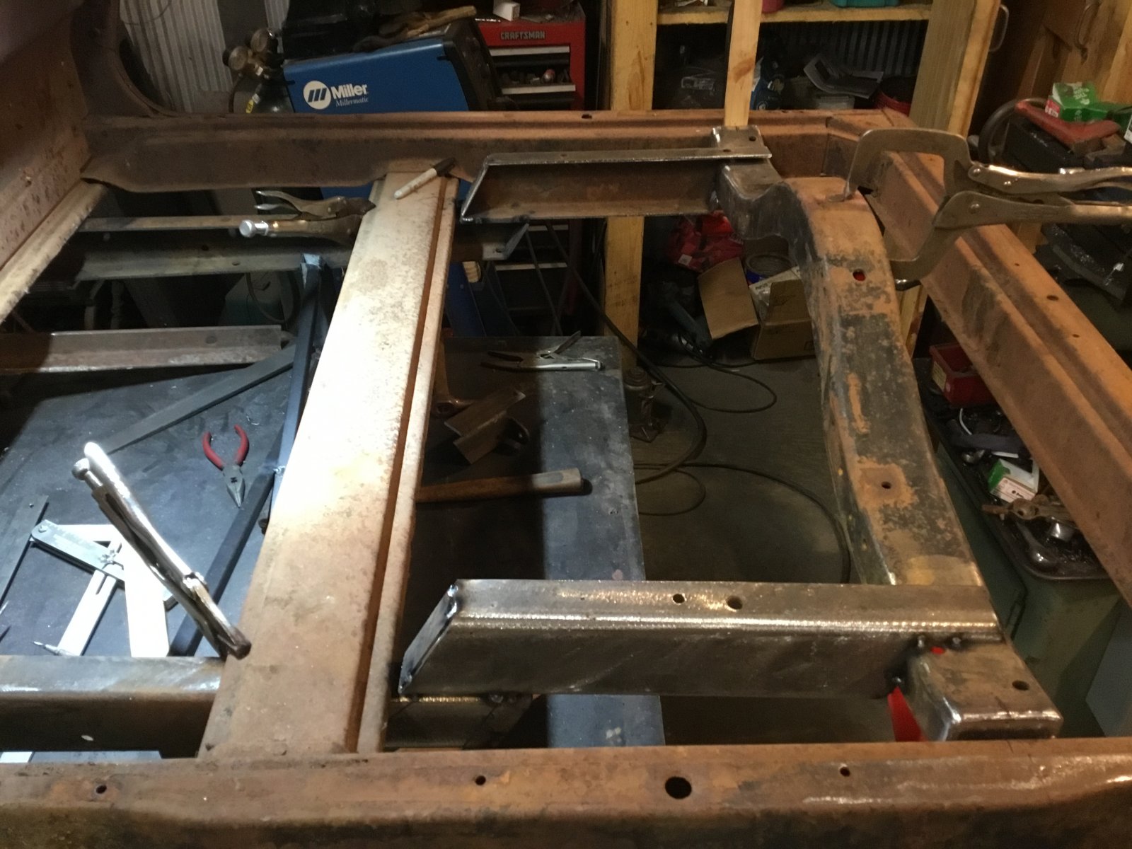

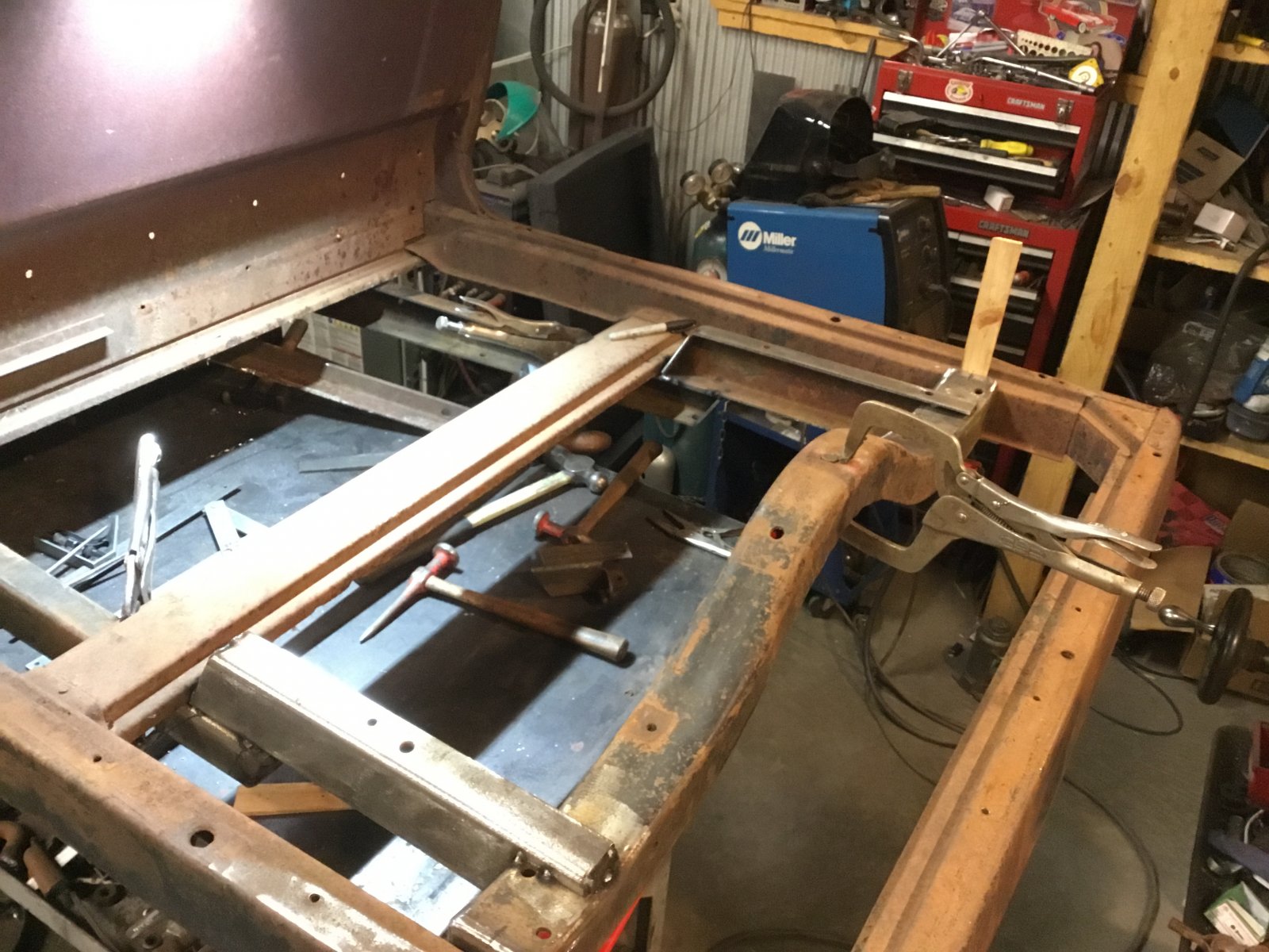

    I have the rear of the frame put together and tacked. 895C4EBD-8056-446E-86E7-718D93689FD9.jpeg FB9BCC91-6B61-48C9-8E37-CAFA644B9F63.jpeg 193D15B7-CD33-4846-AF88-00E0C3C16CF5.jpeg I also cut out the area where the spare tire mounted to the sub rail and added a Ford script from a 47 Ford pickup hood. I guess it’s my jam because I used the other script from the hood on the back panel of my T modified. DD6F18AD-489F-45A7-8F36-5820F925154F.jpeg
