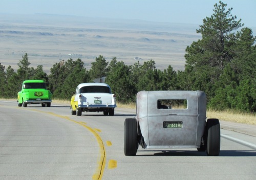

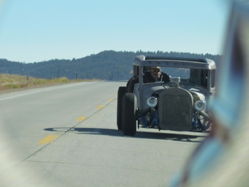

    Here some photos my buddy took. This was the first time on the highway.

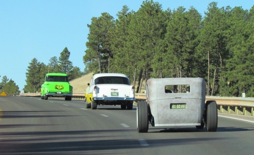

  6. Rusty Cheese
    Joined: Oct 11, 2010
    Posts: 336
    Rusty Cheese
    Cruising...

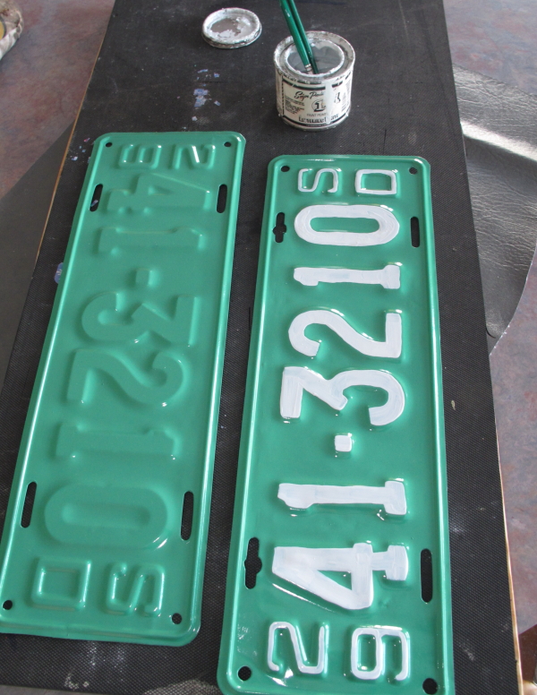

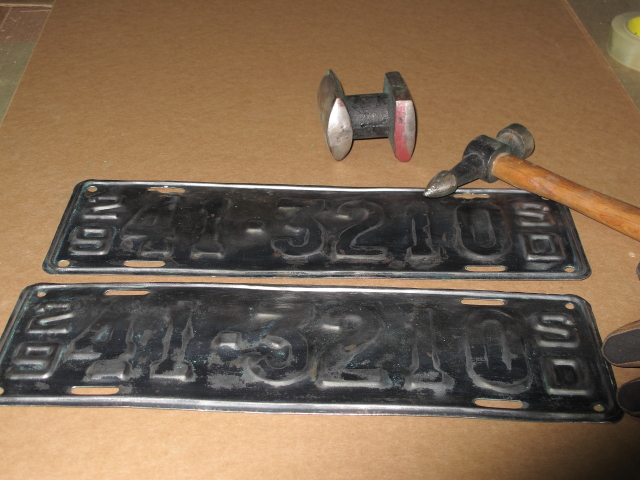

    Applying to the State of South Dakota to let me use the 1929 plates...

    Well, I got to drive it today! No better way to spend the day, Hot Rodding around the Black Hills with my son! 78 degrees in the middle of November. Thanks for all your guidance Jamiee!

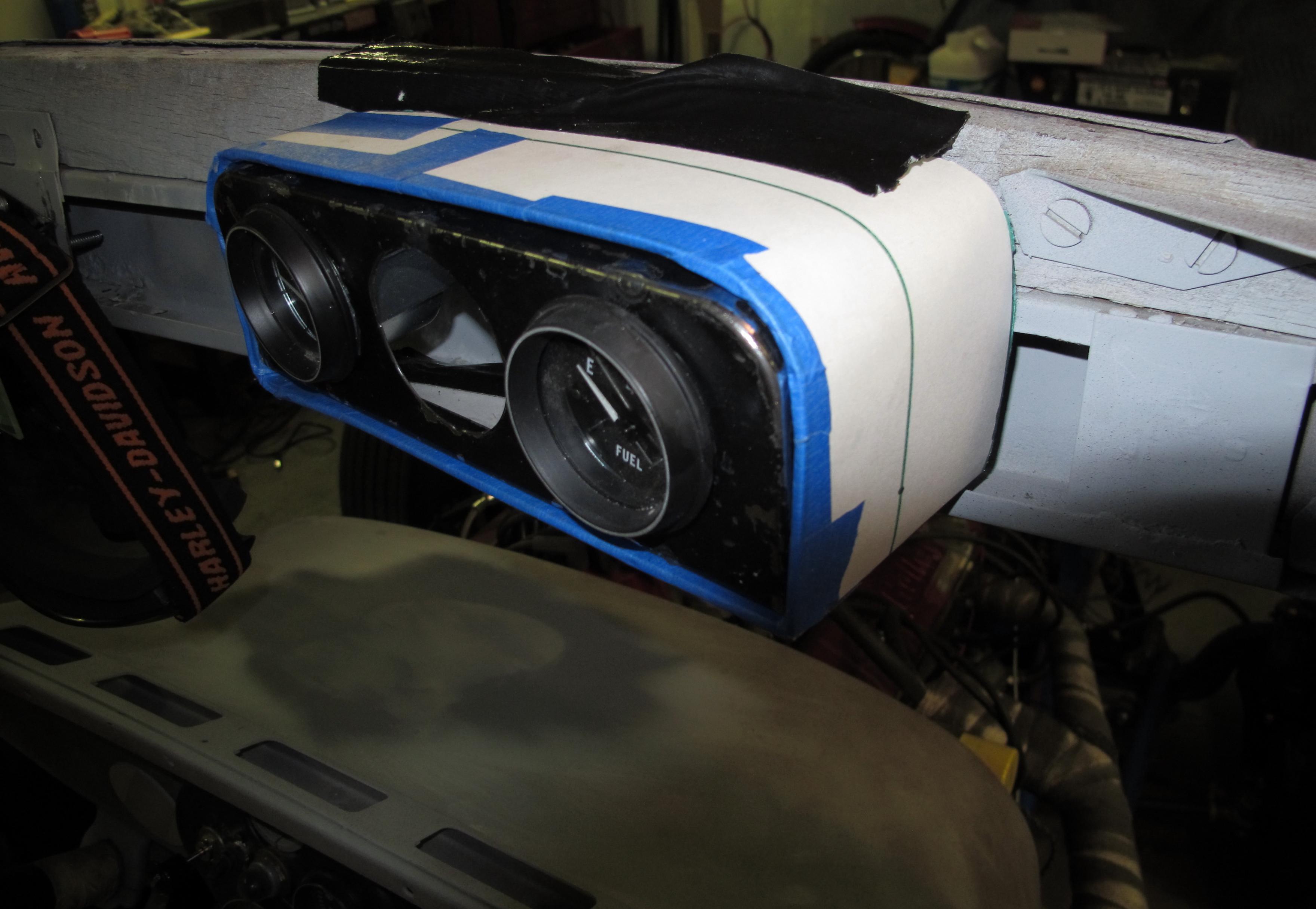

    Cold here in South dakota. Everyone should be out in the warm heated shop building something. With out spending any damn money...
    Gauge Relocation Project.
    Paper Template-CHECK

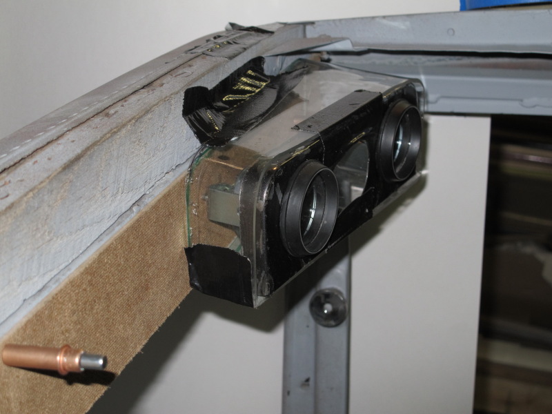

  17. Rusty Cheese
    Posts: 336
    Rusty Cheese

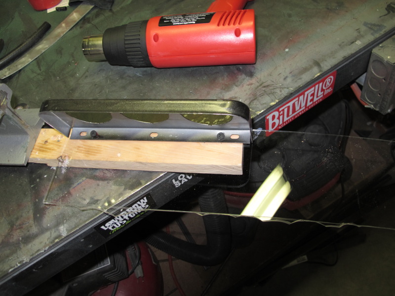

    Check the angle.
    Cheap plexiglass and the heat gun santa got me.

  18. Rusty Cheese
    Posts: 336
    Rusty Cheese
    Flat, not for long...

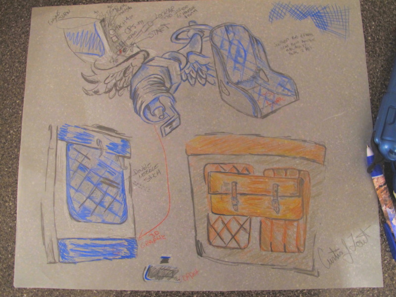

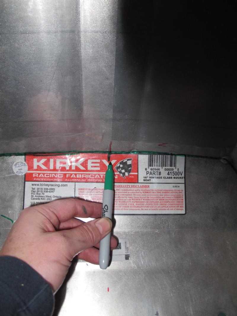

    Rusty Cheese

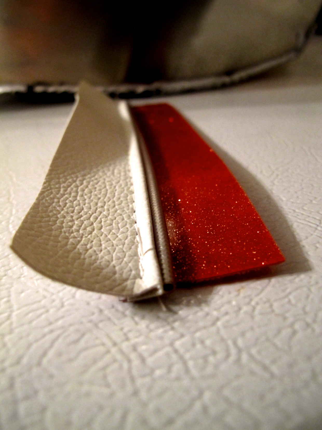

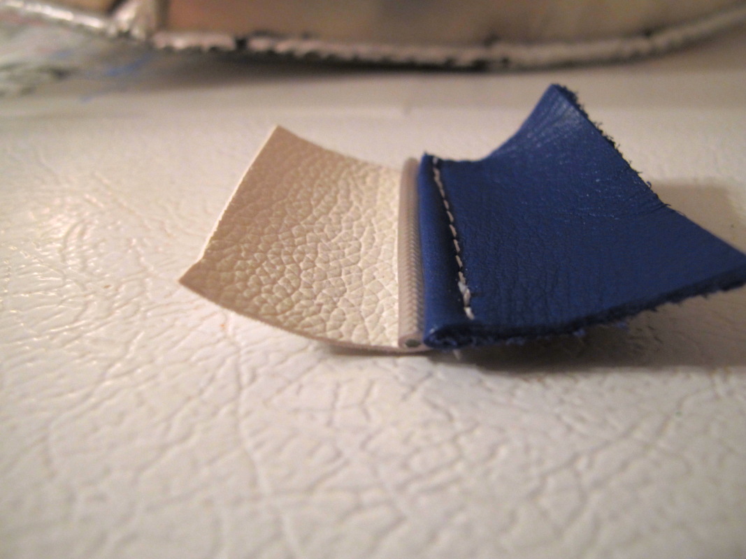

    Seat Ideas. Trying out my new piping foot for the Juki sewing machine...

    Cartoon 29.
    Too many ideas...

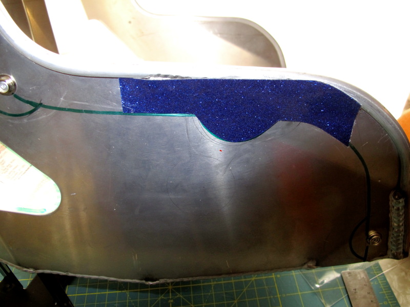

  23. Rusty Cheese
    Posts: 336

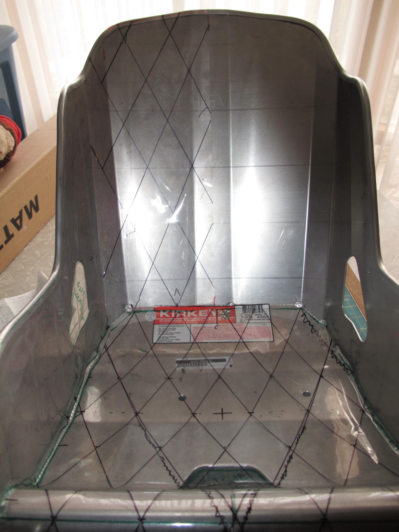

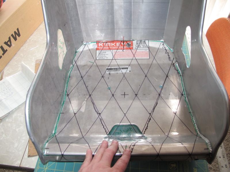

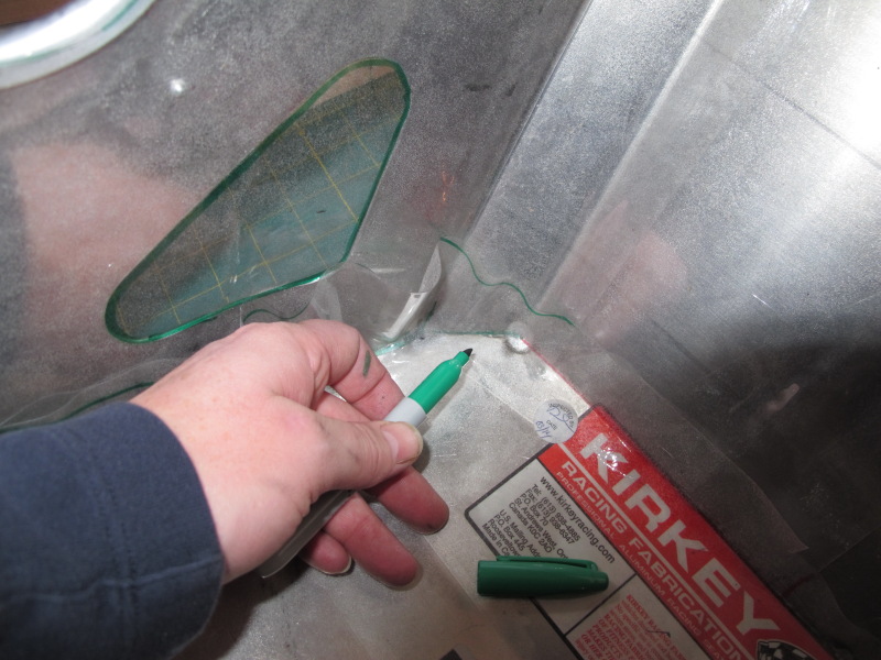

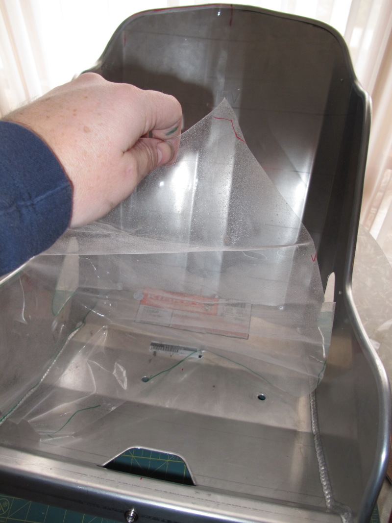

    Rusty Cheese
    Ok time to ,make the pattern for the seat cover. I'm going for a 60's sparkle vinyl with snaps and and Diamond inserts pleats. I'm not a upholstery expert by any means, just learning as I go. so any input is always appreciated...
    First I used a small amount of spray glue on my pattern to keep it from moving all over.
    Working off the center line.
      125.7 KB
      158
      239.5 KB
      164
      187.3 KB
      164
      155.3 KB
      145

    I want a uniform size around the outside and going to add a few snaps.
      105.1 KB
      145

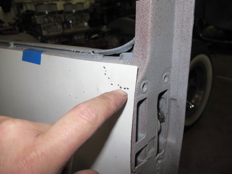

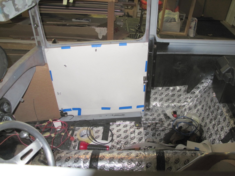

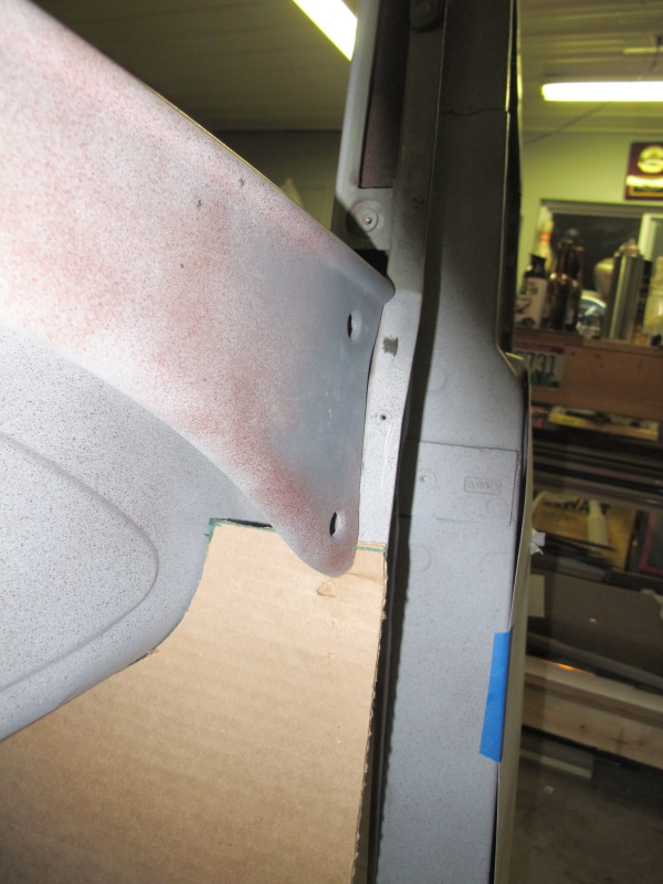

  28. Rusty Cheese
    Posts: 336
    Rusty Cheese
    I'm making my template for my door panels... Do I have to notch the top two corners because it doesn't seem to sit flat.
    Second. How far up should I go with the panel under the dash. Any advice or pics would be great.

  29. nsidemn
    Joined: Mar 16, 2006
    Posts: 76
    nsidemn
    Dude!! Looks like I may have to walk across the street and see how my future employee is doing...lol Your garnish moldings will extend to the edge and push your panel tight. That is an area where the plastic works great because you can heat it and it will hold the bend. I know it is a lot more cost factor with plastic but with you super tight roof you know its going to get wet. With the plastic you don't have to worry about warpage.
    As for the kick panel you are good at the dash. The 1/2" wide strip right next to the dash panel is where the metal trim piece attaches that holds the windlace. If you are not going to install windlace you may need to cover that spot.
