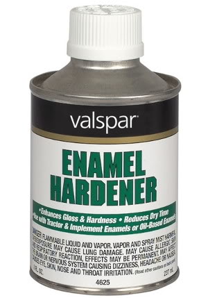

    There is a Hardener that helps dry time available , I use Valspar enamel hardener from tractor supply. Thin it with what the can says so you don't have trouble.

  13. Rustoleum says right on the quart jar to thin it with acetone. I have thinned it 4 to 1 with acetone and then poured a capful of hardener in and mixed it up good. You have to play with the pressure and spray pattern on a scrap of cardboard until you like the way it sprays.

    Rustolium works great. People that knock it, probably haven’t tried it. I mix it with regular generic enamel hardener and 30% clear coat, it sprays easy and look like any other single stage enamel.

    Then I went to napa and bought a pint of universal gloss hardener.
    This will allow it to harden quickly and you can sand if needed in 24 hours or so, suppose to keep the color on cheap paint alive longer.
