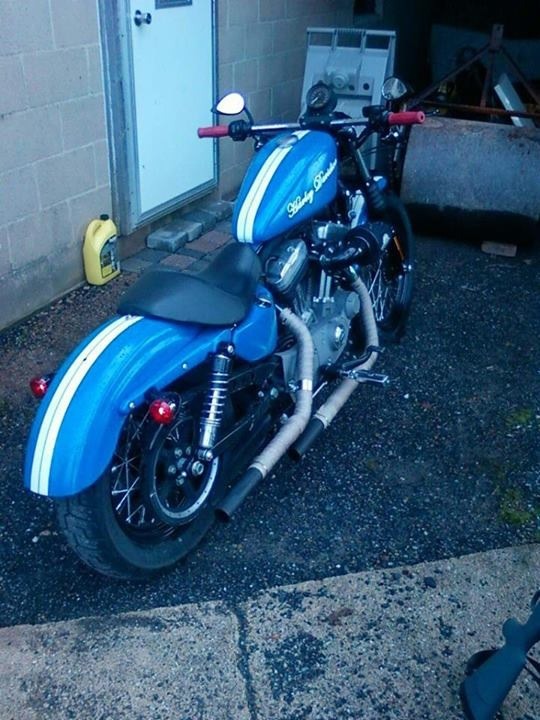

  20. ImageUploadedByH.A.M.B.1373795384.597998.jpg this is my bike. Normally I wouldn't post a picture but since the topic is paint I did.this paint job I did cost me less than $60. I even used blue shop towels and masking tape to mask off the strips. It was painted in 2009 and it still looks good. If your looking for a crowd pleaser I even won two shows with it. I entered just to be an ass. I'm good at that. And yes it was rattle canned. But it was done being wet sanded in between coats. I wax it and that protects the paint. How ever I am going to be repainting it with metal flake and candy when I get home in the fall. The thing is roll with what you got. At the time I didn't have money for a real paint job. So I had to do what I could till I was able to get the real thing. How much more "traditional" can you get than that...... -Fat Chico
