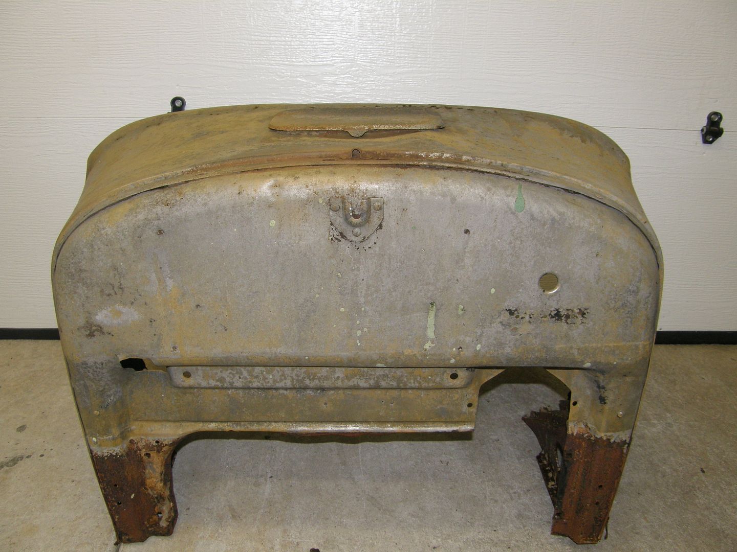

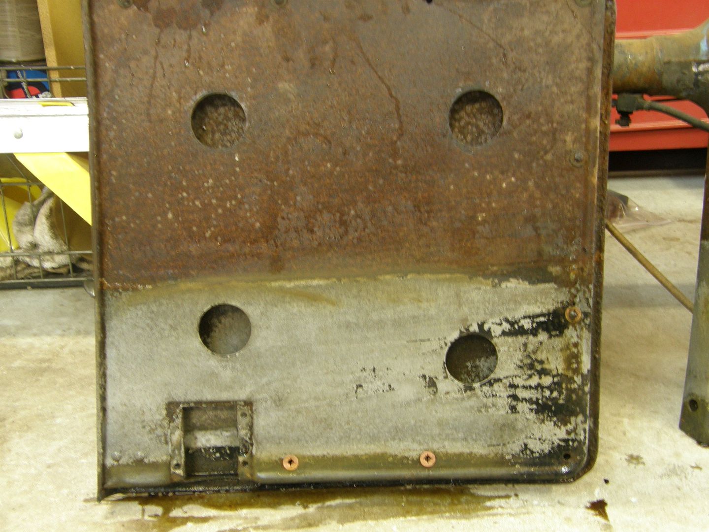

    Yeah it does work!
    After a couple of weeks in a molasses bath.............
    You'll notice rust on the lower 6" or so. That's because the first time I tried it, my pond liner had a leak and most of the molasses drained out. So, I left it in and it dissolved the rust on the first 6". Got a new liner and flipped the panels over. The rusty part was originally clean but stuck out and was exposed to air. It's only surface rust that'll come off with a light sandblasting (as will the flash rust that begins forming almost immediately).
    First run with the doors (notice no harm to original paint, rubber or pot metal).............
    Built a 4'x4' box out of scrap 2x4's and OSB.............
    Installed a reclaimed pond liner from an old pond in our backyard...............
    Proof positive that an entire '27 Model T roadster will fit in a 4'x4' box..........
    20 gallons of molasses bought at a local feed store for $60 including tax, then mixed with water at a 7:1 ratio - 7 parts water to 1 part molasses............
    Entire car submerged in the brew (until most of it leaked out)!.............
    Replaced the liner, added some more molasses and after a few weeks............wah lah!
