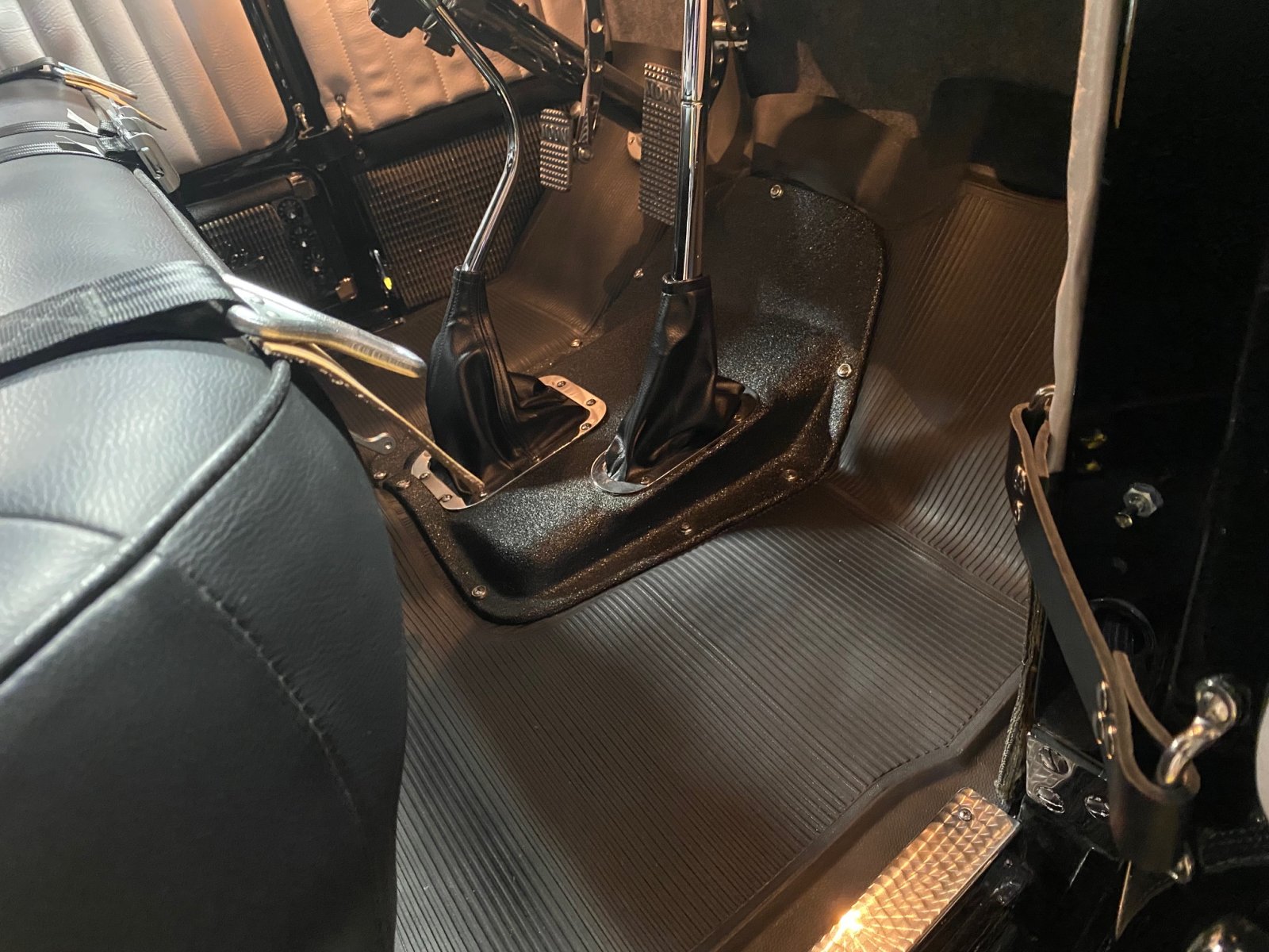

    I used machinist fatigue floor mat in my RPU as well as in the bed. Started with 20 gauge sheet material, pressed floor foot pockets, glued the matting and painted the tunnel and surrounding area. #01.JPG #02.jpg #03.JPG

    The roll I bought smelled pretty bad when I first opened it up. I scrubbed it with Dawn and a brush before putting it in my car. Smell went away after a good scrubbing.
