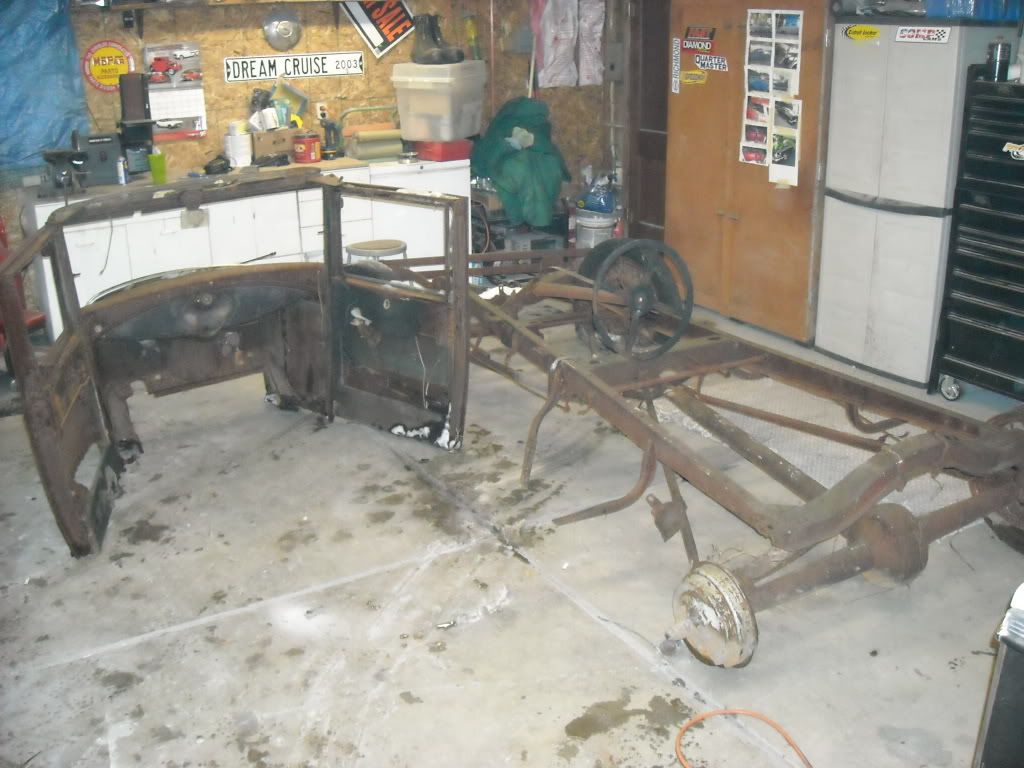

    I've only repaired panels and done typical body work, I have never atempted to build a car, so here goes nothing. After all its just steel. My father in law works at a scrap yard and since the price of scrap is up people are getting rid of some good stuff they think is junk. So on christmas eve he came over and surprised me with this cowl and a frame. I started working on it that night I was so geeked!!!

    I like the look of an rpu and Im 6'7" so this way I should be able to build something comfortabe to drive. First I made a table and removed the doors,then put the cowl on the table so I dont have to sit on the floor.
    I figured with a body so short who needs doors. So I started measuring and cutting.

    Well I got the body sitting on the frame. Now the fun begins, time to do something with the frame. Looks like i need to do some researching to figure the front end

    After looking at the body I think the top rail needs to come down to the body line on the cowl. Maybe put a new 1x2" right under the one thats in there then cut out the orignal one. What do you think,I need feedback!

    I think I'd lower the top rail just a touch......and bow it out so it doesnt look so squared off. Those parts look like a good save and you sure don't waste any time. Good luck, keep us updated.

    Yup, looks too boxy... Cool project, I like it!

    I'd use that box tubing as a structure to form/hang your finished body panels from. I bet you can use it as-is but more as a work fixture.
    There is one thing about making the body - nothing is square, true or flat - that'd be too easy. Keep going, you're doing fine. The typical way is to go from one mistake to another, no big deal. It is a learning process. Later, oj

    Thanks for the input guys.Keep them coming. The back is 4" wider than the front. Ive thought about using the door,I guess I just hate cutting up those doors because I know I will never use them. But the thought is in my mind.

    That's exactly what I was thinking when I was looking at the pics. Also, my personal opinion, you need to do something with the closed car windshield frame when you make an open car. At least lay it back a little but even better, get rid of it and put a roadster windshield or a Duvall style.

    You can do it! i'd suggest you look around for some doors & rear 1/4 panels. I'm building a modified out of swap meet bits. 31 slant window cowl & tank, sedan doors, sedan 1/4's and i made the rear panel out of sheet metal. i only have $1200.00 in the whole project with wheels/ tires and the motor & trans mounted. I'm sure some guys on here have some rusty old bits that you could fix up a little. Good luck!

    Troy is right, you can't go wrong with quarters, or "shapes"...BUT! If you are 6'7", I'd seriously get some length (similar to Troy's above) or your knees will be up to your chin!
    My brother (6'4") has a '29 Rdstr P/U we built in my shop some years back. He doesn't listen, so he ended up with a standard '29 Roadster pickup cab with a slightly recessed firewall (BBChevy & muncie 4 spd) and a lowered seat: windshield chopped 4-1/2", he can drive the car for 5 miles or so, it is hellishly cramped.
    The way your rear cross brace is positioned tells me you need 8"+ to the rear.
    Don't forget the thickness of seat upholstery when you sit in there...and be careful with steering angle/mast length!

    I did something similar. I used a 29 4 door cowl and a 26-27 T touring backhalf. That was after mocking up a stock 29 rpu body and seeing how cramped they really are. Now I have plenty of legroom and some space behind the seats.

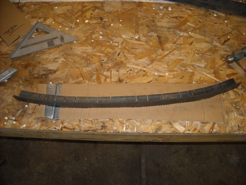

    Well Ive taken everyones suggestions and took the whole week and looked at it every day for the past week. I decided to use the doors I have. Remove the wood and doctor them up. Ive been trying to figure out how to duplicate the body line at the top of the door. Some one suggested to me cutting a piece of exhaust tubing in half. Im still looking. Heres a few shots from today.
