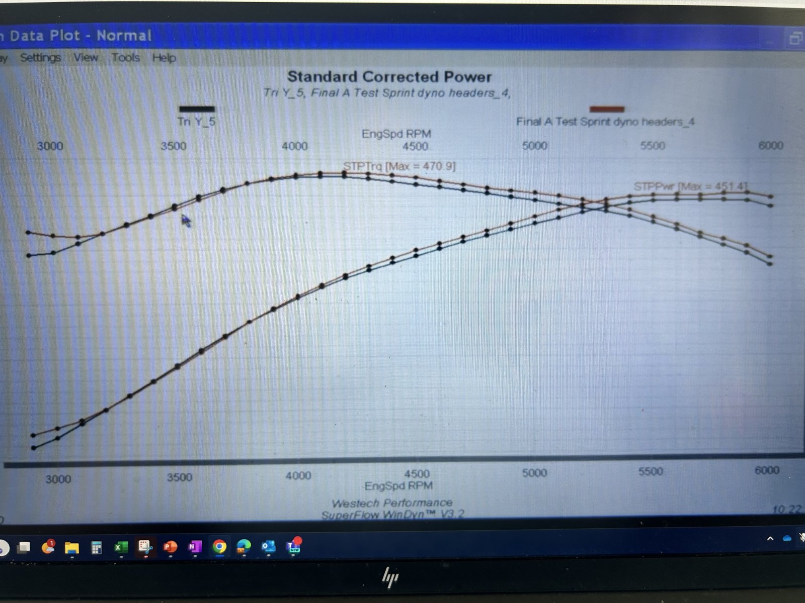

    I have but on engine masters they compare one combination with the different header sizes what they don’t do is show the differences of overlap on all the tube sizes also the difference between tri-y and long tube on an smaller displacement engine where the torque peak is around 4500 RPM let alone the difference between dyno and chassis headers performance. There can easily be a 35 to 40hp loss in header performance before normal parasitic loss.
  2. Rootsy
    Joined: Sep 8, 2014
    Posts: 120
    Rootsy
    from Monroe, MI
    I am referring to season 5 episode 18 where they literally ran a 1 3/4 Schoenfeld dyno header against a 1 5/8 Doug’s Tri Y (2.5” collector and all) on a 383 in the upper mid 400 hp range. The Tri Y hung well with the dyno header - within 5. The rest were worse. Fluke or ligit I don’t know - a lot of things can be done I reckon to convey the results you want to convey on TV so I guess grain of salt. I’m not too worried and honestly I am not going to find a 1 3/4 4 into 1 that fits worth a darn in this car. BTDT. A long time ago I went through like 3 or 4 different sets to find what would fit best. I would have kept the ones I had (hooker I believe) but having them coated was about the price of new coated headers and they were dented and clearanced pretty hard so were rather ugly…
    so I guess it doesn’t matter if I lose 5 or I lose 25. If my dyno guy would have had the provisions to run the Tri Y I had I would have but it didn’t adapt well to his exhaust / muffler system. So kind of limited to what fits and works…. Either way upgrading to a toploader and 9” is directionally correct so I don’t have to spend more $ down the road.

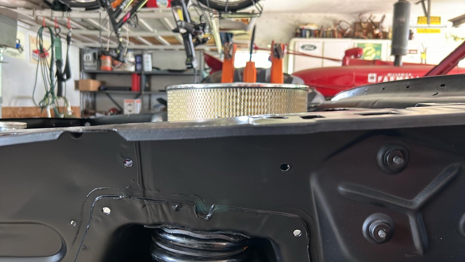

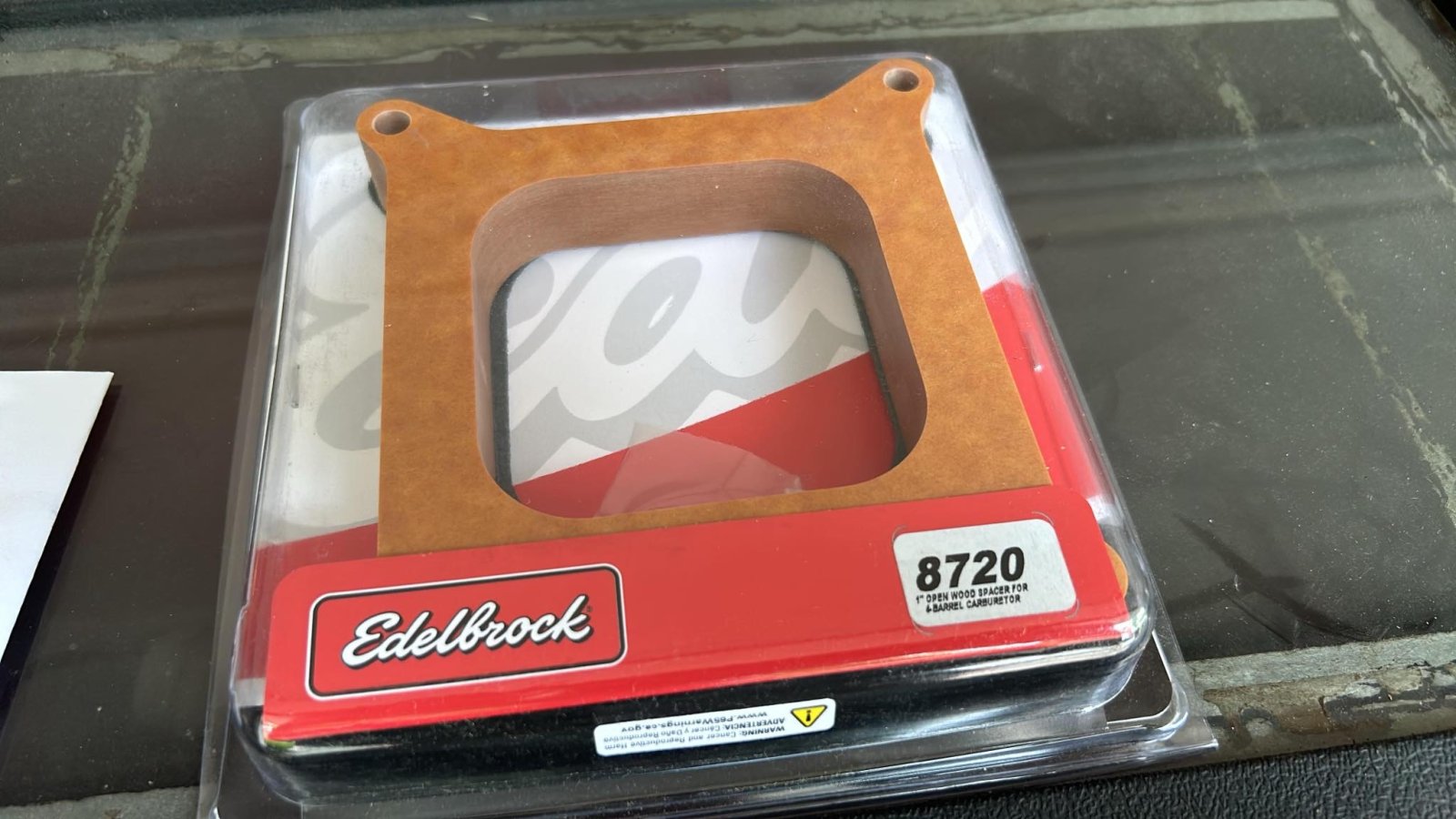

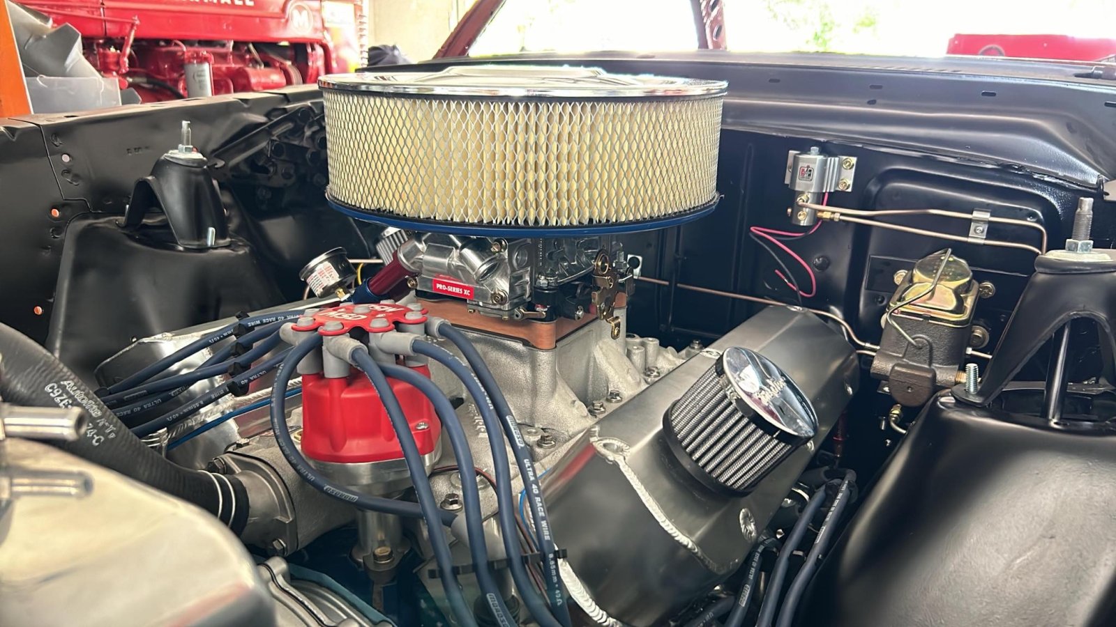

    Buttoned the engine back up after getting headers in place. Added a phenolic 1” spacer between carb and intake. It likely won’t have any negatives. The RPM intake seems to generally respond well to a 1” open spacer.
    This pro-systems carb though uses a 5/16 thread for air cleaner stud. So I grabbed a piece of 5/16 round stock and fired up the lathe and whipped one out. I have a 4” Wix element - good thing for the teardrop.
    Onto the cooling system adventure. It’s been another challenge..
    Even found this surfing the eBay.
    Figured it would be fitting on the air cleaner.

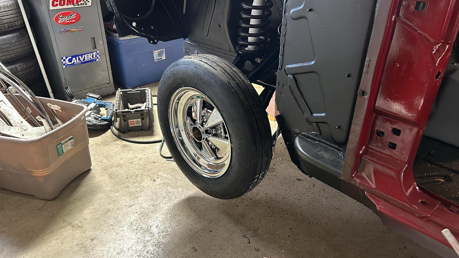

    Had to drop one end of the rear springs go get rear wheels and tires in. There just is not enough droop with the Calvert split mono springs and 11” drums to snake wheels and tires in there.
    rears are 235/60-15 M/T ET Street radials on 15x7 Cragers. Front are 26x6 - 15 M/T ET Street radials on 15x4.5 Cragers.
    I could use another 1/2” of backspacing on the rear but not happening with the Cragers in 15x7…
    Put the export brace in and rolled it outside and up and down the driveway a few times and bounced it a bit. Needs some more shim on the passenger side to get the suspension evened out a bit. Figure there is at least another 800-1000# of stuff to go on / in this car to get it squatted a bit more.

    The Comet wheel well is kind of tricky, but it looks like you got the tires right where they need to be. Fantastic work on the little car, keep it up.

    The rear wheels are in the stock location. I have holes in the perch and the shock plate so I can move it 1” back if I wish. Should be OK - rear tire is 26.2” Dia and has clearance. Need to go get a driveshaft made so now is the time to make changes.

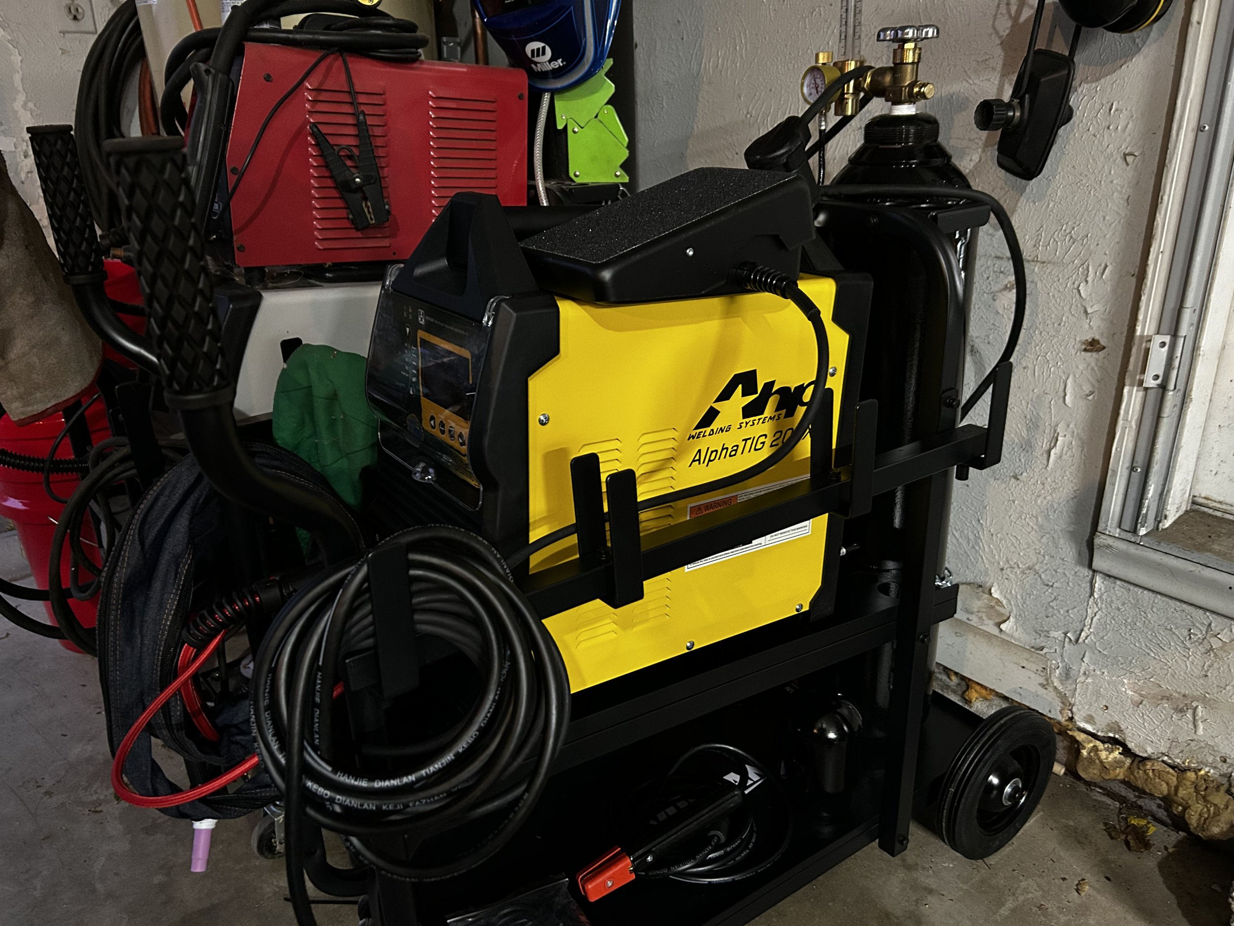

    Added some tools to the arsenal today… cage should be here later next month
    the Alpha TIG is supposed to be the best bang for the buck. We will see if I still remember how to stack dimes…

    Stackin Dimes ! Haven’t heard that one in a long while . Foot pedal was always tough for me in some positions . I sometimes use the finger control in a tight spot , you may need to try one the cage build . Car is top shelf , I had a sedan years ago , guy I sold it to still owns it and I can not get it back , going to restore it some day . Great work , keep it up your on the home stretch now .

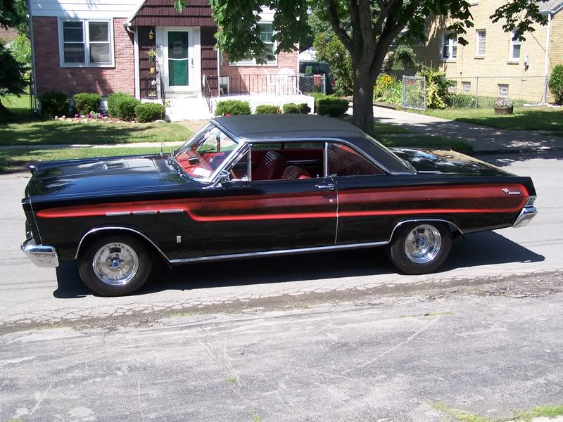

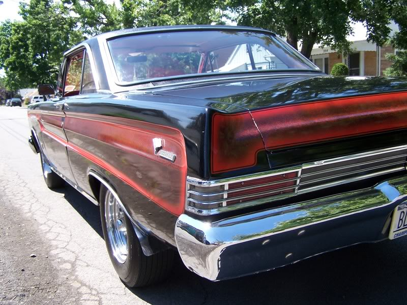

  20. Nice build you're doing, here is my neighbor's one owner cyclone, mostly stock drivetrain in it.

    I have both a foot pedal and a torch trigger. For $700 this setup is hard to beat.

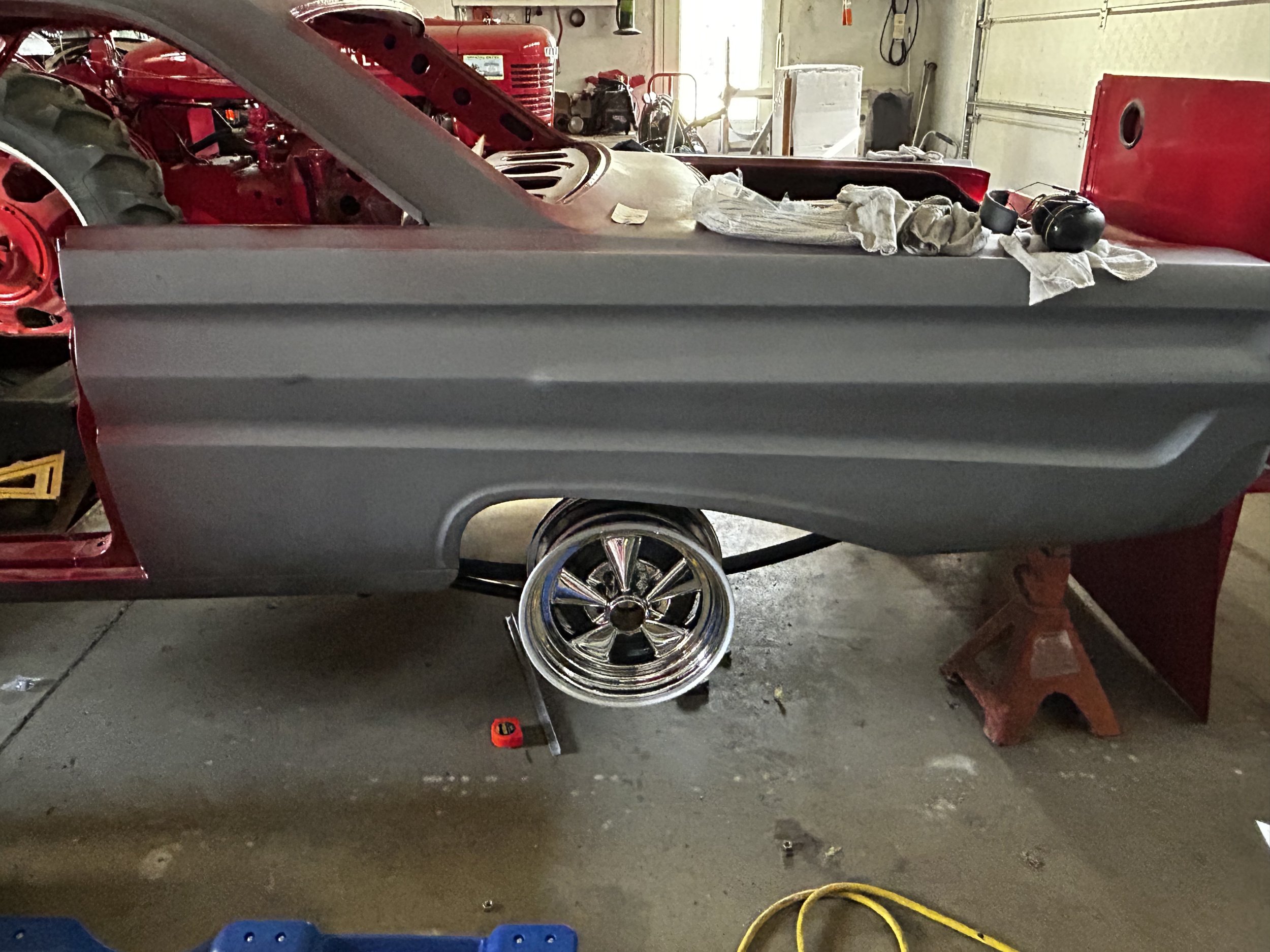

    Door skins stripped before the rain started to roll in. I’ll get the rest structure sanded snd scuffed and the skins sanded later this week.

    Spent a couple of hours Friday pounding on fenders. Mounting points were all bent up, front bottom mounting point was totally jacked up from being moved around for years. It was bent and inverted from what it should have been. Matches fairly well now but there is a crack and hole that needs to be welded up and ground down.
    Think I am going to POR15 the inside of the front fenders…
    Sprayed test panels with the closest “PPG match” to Rangoon red and yeah, it’s a no from me dawg…. Next photo shows JAU “Rangoon red” @ 3 coats on left (2 panels), right is the PPG 3660 @ 3 coats and one with some clear the far right just base. Not really what I am looking for. The 3660 has an orange pastel feel to it in person…. Have a local comet friend whose dad has some vermillion in DBC who has offered to shoot me a test panel to see how I like that. Vermillion is $315 / gal in Shopline or $640 in Shopline plus basecoat.
    Think I have narrowed to Vermillion, race or torch red…
    Also blew all of the mice nests out of the rear deck lid. Have a big dent I need to remove so in the absence of a stud welder I guess I’ll tack a washer in the dent and put the hook on the slide hammer.
