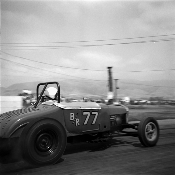

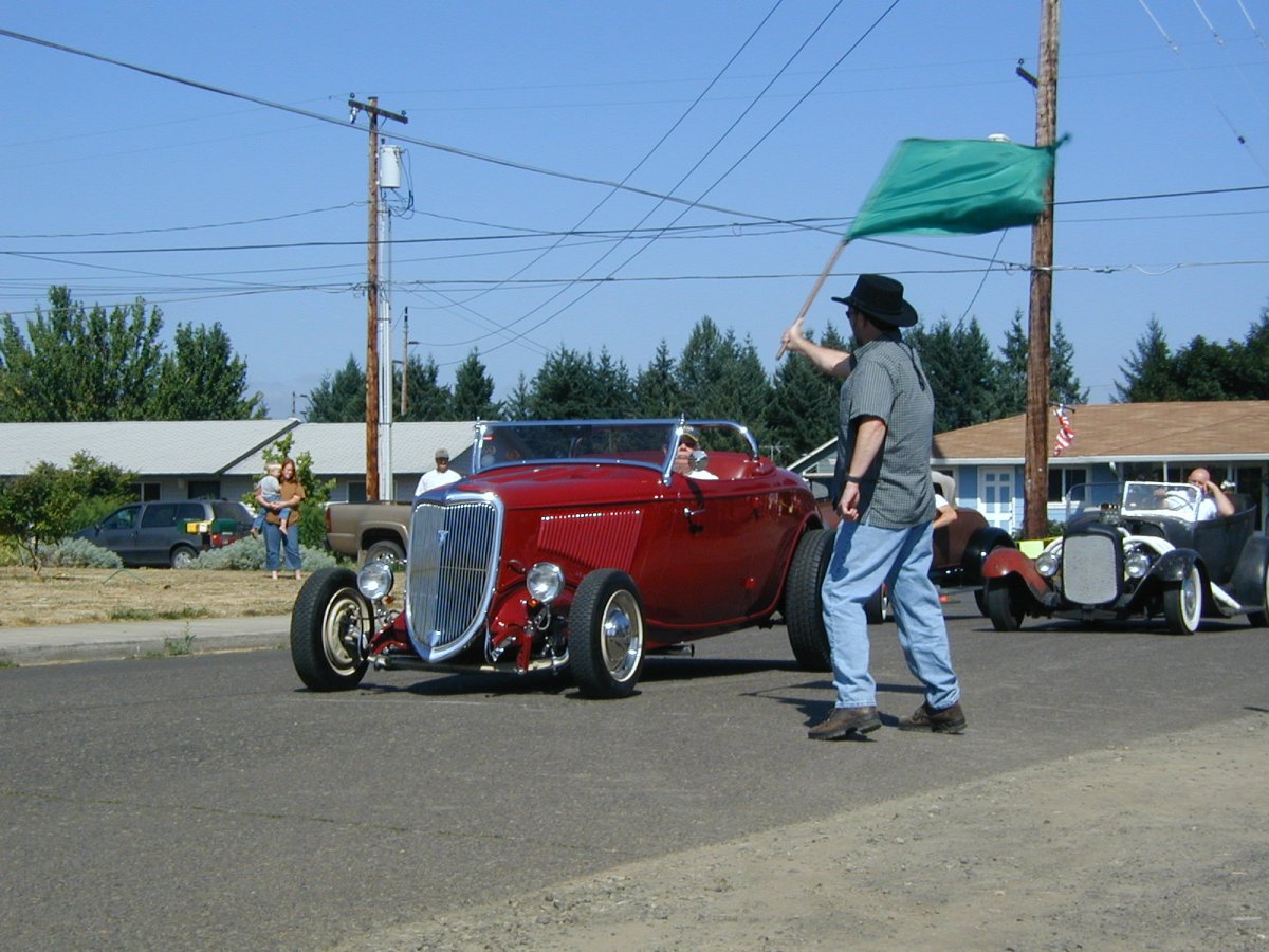

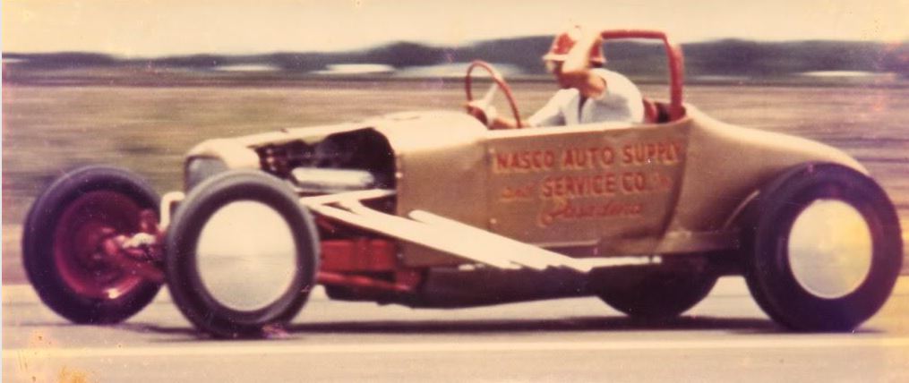

    I've got a '28 roadster that I've been upgrading for safety - Brakes, Steering, Belts, etc. I'm considering a roll bar. Anyone have any favorite images you can share? How about height?
    Maybe this?
    Or this?
    But probably not this:
    I know sometimes they did them with round roll bars in the dirt-track races to make them flip right back on their feet.

    I'm not sure how useful a roll bar that doesn't come up near the top of your head actually is. The last pic of the Square Bar car is probably the most functional of the three you posted and is on a period "East Coast stlye" (edit: I see it's a MO car now) car that seems to have raced.

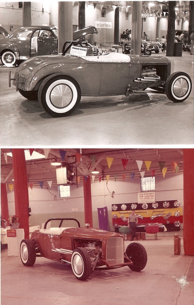

    Tricky to do one that actually works and still looks good. In fact, on a street car - no way... But if safety isn't your number one concern, these rule:

    Some of those are less roll bar, more torso preserver. They look cool though.
