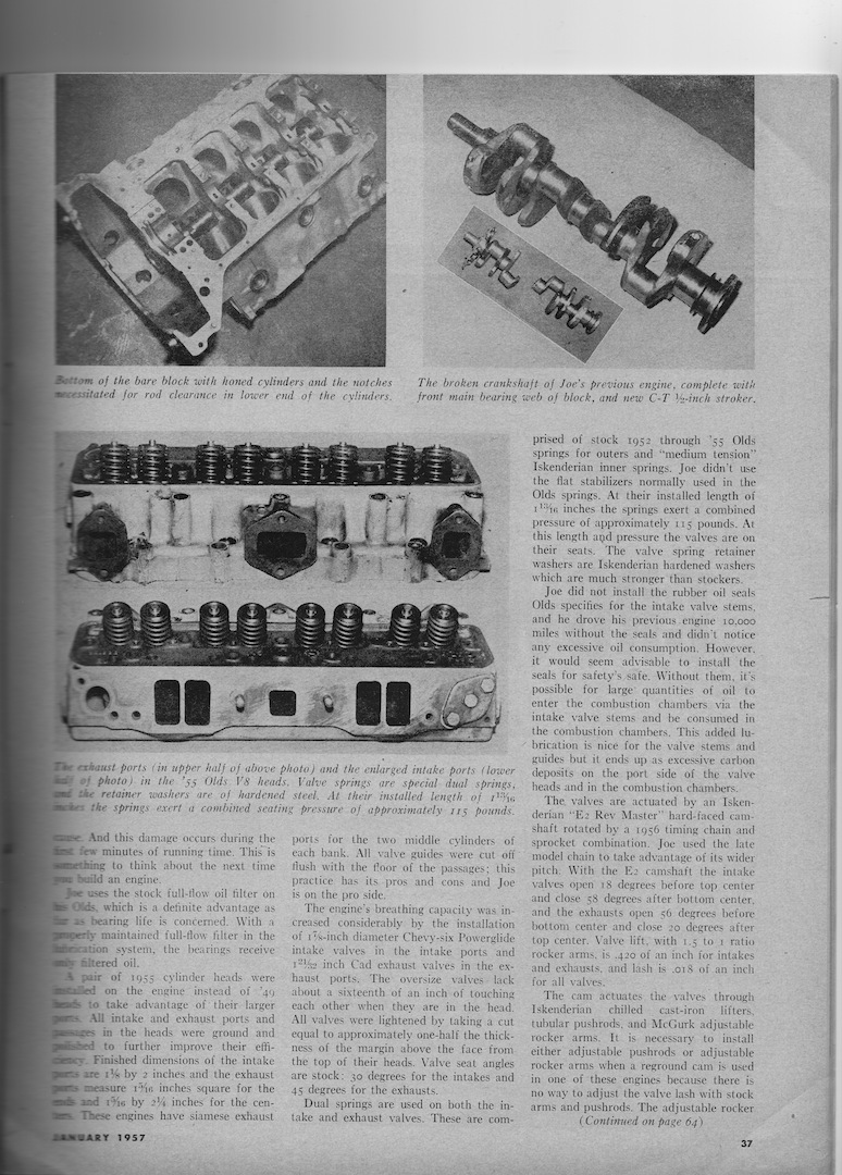

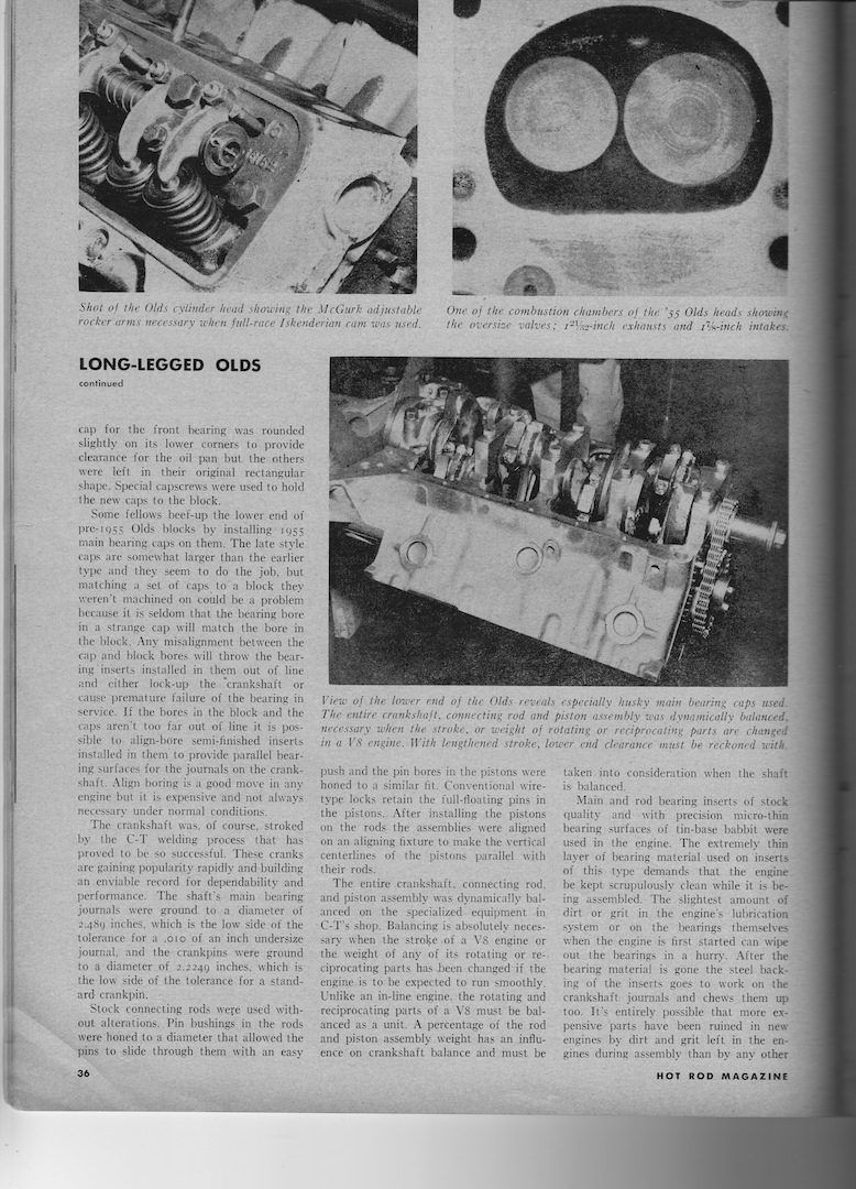

  3. I was flipping through some old Hot Rod Magazines and thought these might be worth adding to the thread. An article from HRM January 1957:

    ^ I was reading page 37 on those scans, and they said "Isky E2 cam" in that motor with 1.5 rockers. Is that E2 the one in the Olds Dealer J2 nascar kit? I thought there was another E number, too.
  6. Frank, I don't have any late 50s literature on Olds Dealer options. I'll have to see what I can find online though.
    I'd also like to dig up a same vintage Isky catalogue to compare.
    I seem to remember you had a thread about Olds parts for Nascar/Export, trying to identify what (if anything) was what.

    Speedy, that was a GM cam tag I was trying to ID. I am thinking it also might be a tag for a stock replacement cam, because there is some info on the web about some early 57's having lobes worn off, under warrantee, when new. I still think there is a slightly better chance it's an export J2 cam, only due to the info about retainers and springs that are on it. I don't know.
    I need to find some dealer parts books from 57-64 ..one of these days, I will look for some:rolleyes:

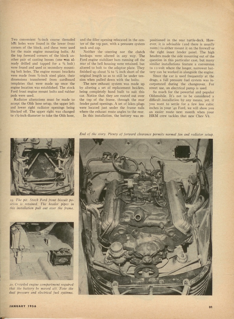

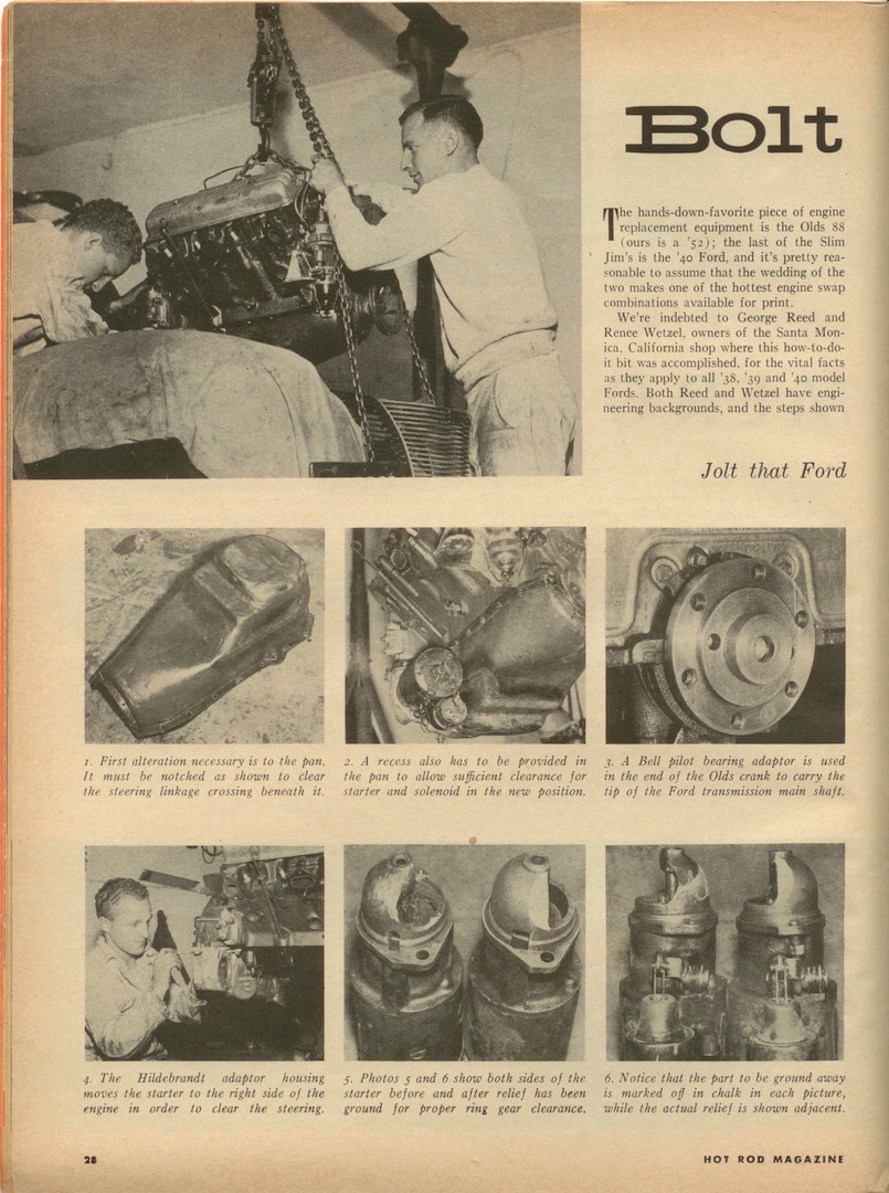

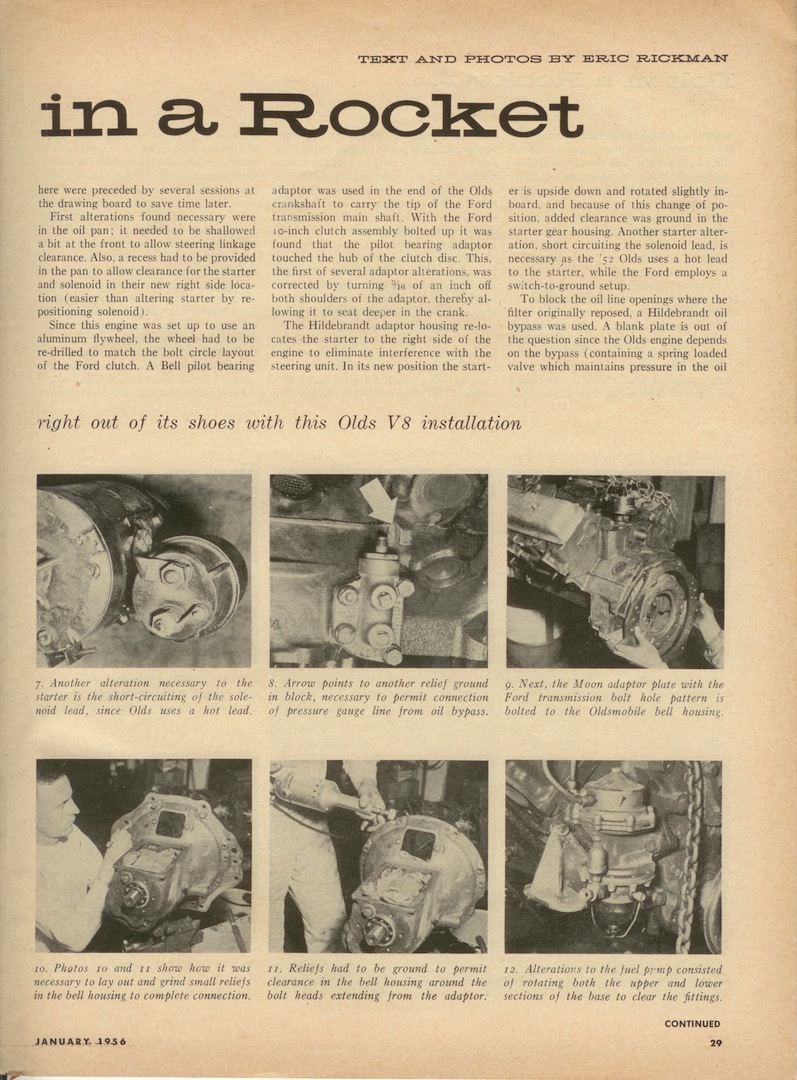

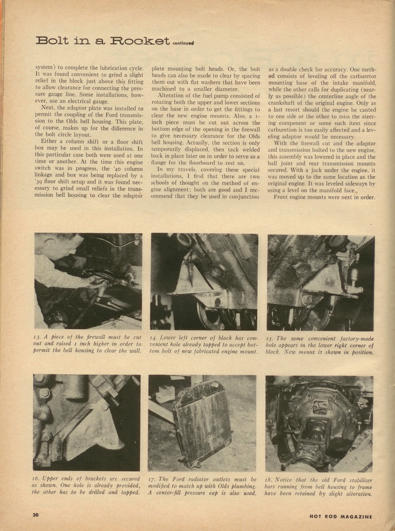

  9. This isn't quite tech info, but there are some modification tips in here that I will be using. Worthwhile to add to the thread I think.
    From Hot Rod Magazine, January 1956
  10. F&J
    Joined: Apr 5, 2007
    Posts: 13,281
    F&J
    That's pretty cool, Speedy. I went through some of these mods with my 303/40 swap. I've been asked about the tie rod to pan before, and I know mine is close, but I thought it was due to a dented pan bottom. I need to look closer, I guess.
    It's a fun swap for sure, and will be so easy if you use a ministarter. Yea, that's not old style, but it seems more practical to me.
    I should burn my 32 and get going on the 40. the 40 is not jinxed like the other car is.

  17. I was actually comparing some of the article, to parts from your build thread. It was interesting to see how many things were similar. Sure looked like a fun build, though, I'd be happy with even a stock 40. :D
    I have two good starters for my 324, so I think when I put the engine in, I'm going to use one of those, and modify it like they suggest in the article. I can always switch it out for a Ross ministarter at a later date.
    I think that deuce is going to be worth it in the end. But if you decide to 'burn' it, I can always burn it up here north of the border. You know, less stringent burning practices and such. :rolleyes: :p
