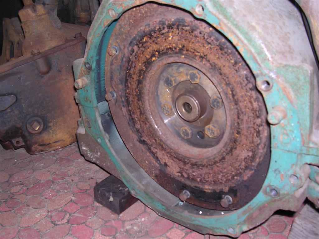

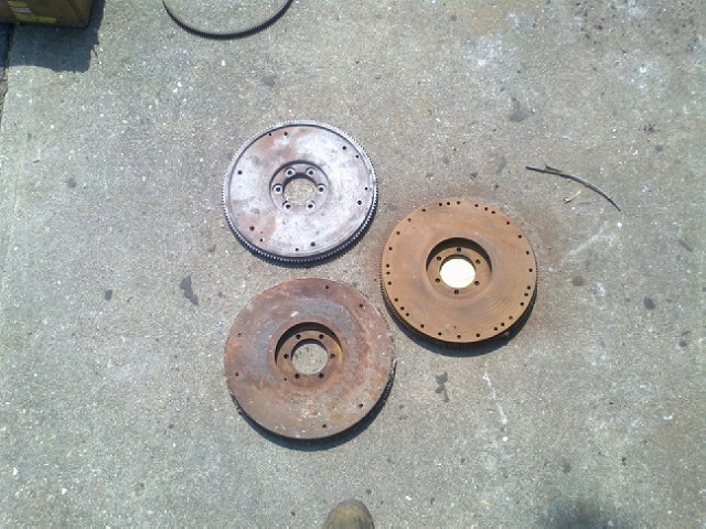

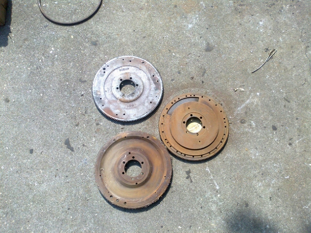

    Pic 1 and 2 are 3 Olds flywheels. The sandblasted one at the top is a 6-cyl Olds, that does bolt up to 49-up Olds/Cad V8. I have not found a good application for these, because the clutch is recessed compared to a V8. I guess it might possibly work on the long input S10?
    Then the flywheel on the left in both pics is a 54-56 Olds.
    The one on the right is the late 394, with the million holes :)
    Last pic of a flywheel on a 57/58 motor shows it looks like a 54/56, but has a 7th hole. I do not know if this is a stock 57-8 flywheel as it was hotrodded...But I think it must be.
    Not to confuse, but the early Cad 49-54 flywheels I have, also have a 7th hole:confused:, but can be told apart from Olds, because the ring gear teeth look wider spaced and also are angle tips, where Olds was a straight cut tooth.
    Edit, that 6 cyl Olds wheel is much lighter, at 26 pounds,I recall. That 394 seems way heavier than a 54-56, but i have not weighed either of those yet.

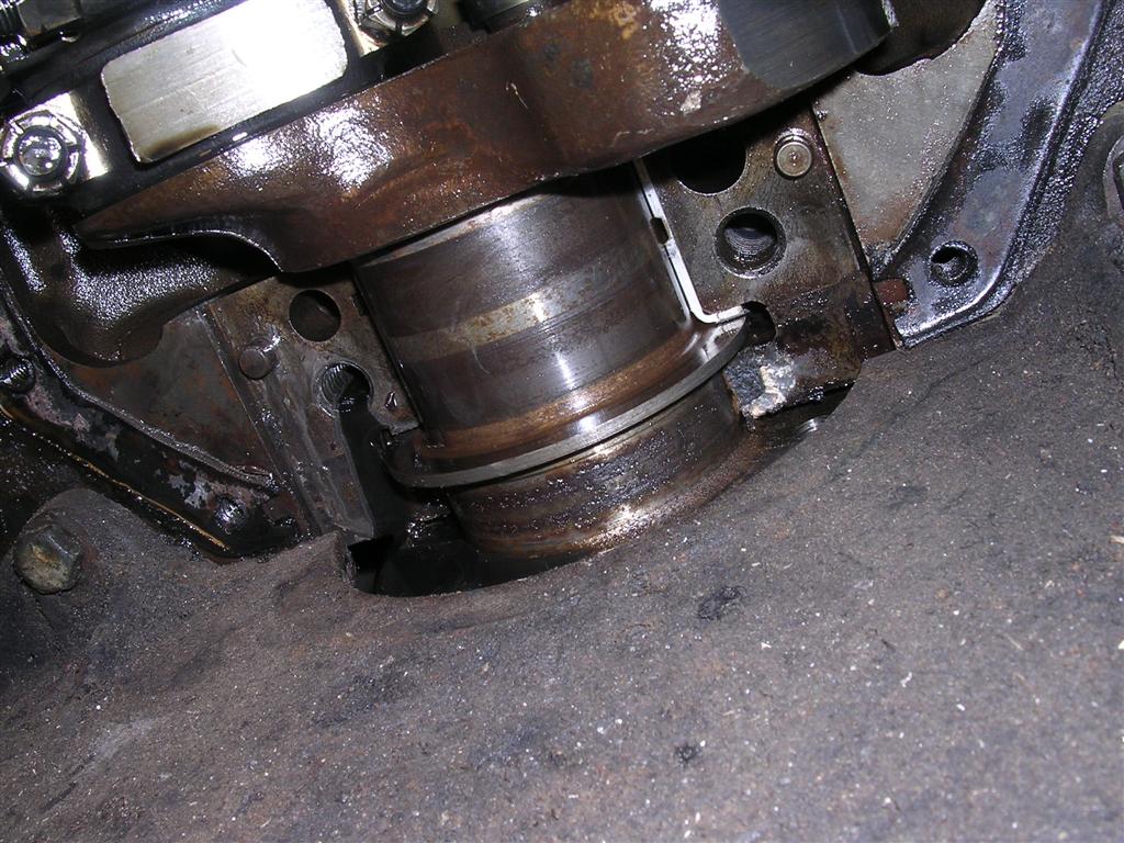

  21. Can you give a better. desc as to where these go. I've looked at some spare caps and have no idea
  22. GOATROPER02
    Joined: Mar 22, 2006
    Posts: 2,059
    GOATROPER02
    from OHIO
    Cork squares go here on each side.....leave them out and watch the oil pond form under your car.
    Tony
  23. F&J
    Joined: Apr 5, 2007
    Posts: 13,281
    F&J
    I don't have a pic with the rear main cap, or showing the piece. Take a look right next to the very end point of the pan rail gasket. That's where it sits. Not "on" the gasket, but right next to it.
    But this pic is useless without the cap. Sorry, It's all I have, and no motors here, are apart.
    Tony got it whilst I was a typin' :)
