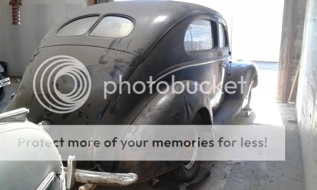

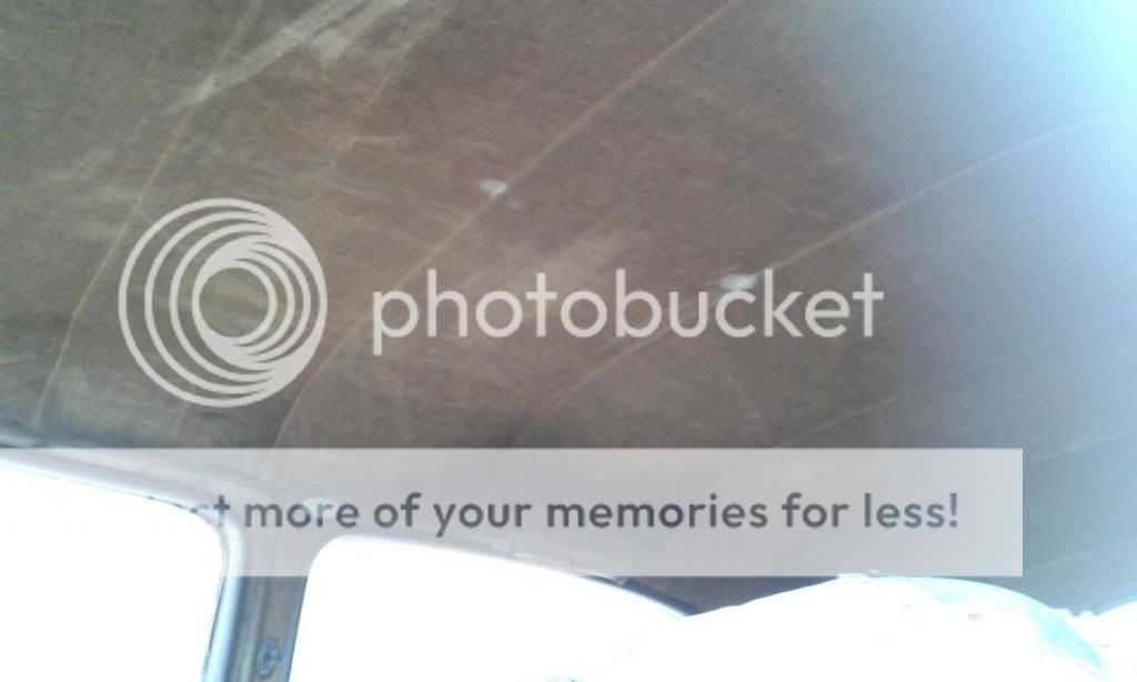

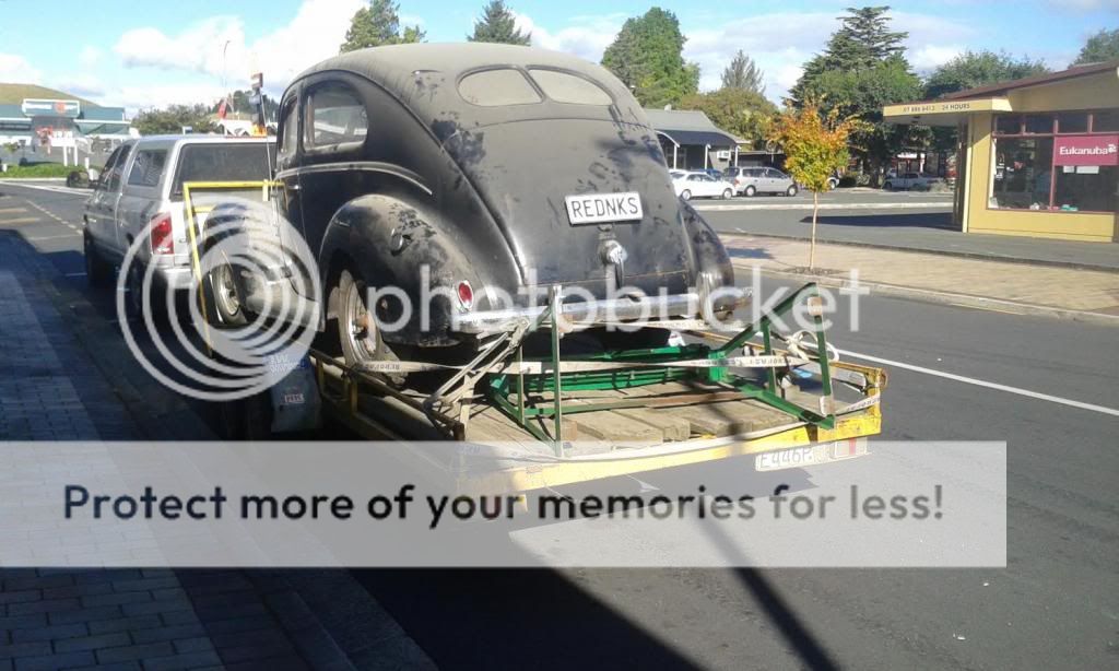

  1. A kiwi Friend of mine who lives and works in the USA Found this old darling. He purchased it from the original owner a few years back and shipped it home to New Zealand for "One Day" .
    It is a '39 Standard , V8-60 car with 89,000 miles on it. Still wearing what's left of the factory black paint!
    I had never seen it in the flesh but have known he had it tucked away safely for the past couple years . So early in January I called him and asked if he would part with it. Well there was a deal done that involved Fresh Crayfish, a quantity of beer and a couple good lumps of cash!
    At the point the deal was done I had still not seen the car , just one photo! But I knew my friend would not have shipped it all the way home if it wasn't worth saving.
    So a fortnight ago my friend was out here in NZ for business/family commitments so that meant it was the right time to go and collect the new toy. YeeHaa !
    It was a 5 hour drive each way to go collect it , the following are a few photos showing it coming out of storage and heading home.

  27. Nice and nice !! Hey did I chat with you at the Nats in Masterton? I get this feeling I may have. JW
  28. What happened to the rear fender? It wasn't that bent on the trailer. JW
  29. Nope , I wasn't there . Could well have been one of my Clubmates though .
    It's just the light/reflection in the photo , I havn't beat it up yet ! :eek:
