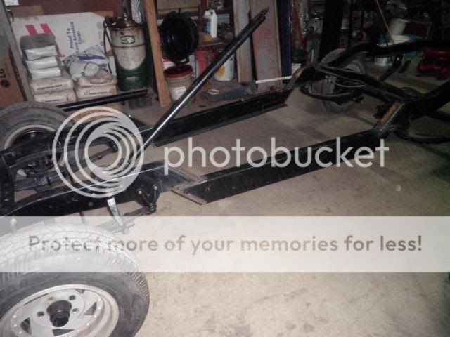

    Put the original frame up on some sawhorses and started putting pieces on it. Frame had been sand blasted painted. Another plus. Sorry for the clutter, dang shop gets small quick when you take a car apart in it.

    I wanted to lower this truck with out sacrificing leg room or suspension travel so instead of channeling or removing leafs I decided to go the Zee route. It sits pretty high in its stock form.
    So got out the combo square and soap stone and drew some lines on it.
    Hot knife time. A little snip ship here, a little snip snip there
    Get out the mig and put it all back together
    6 inches closer to the ground now.
