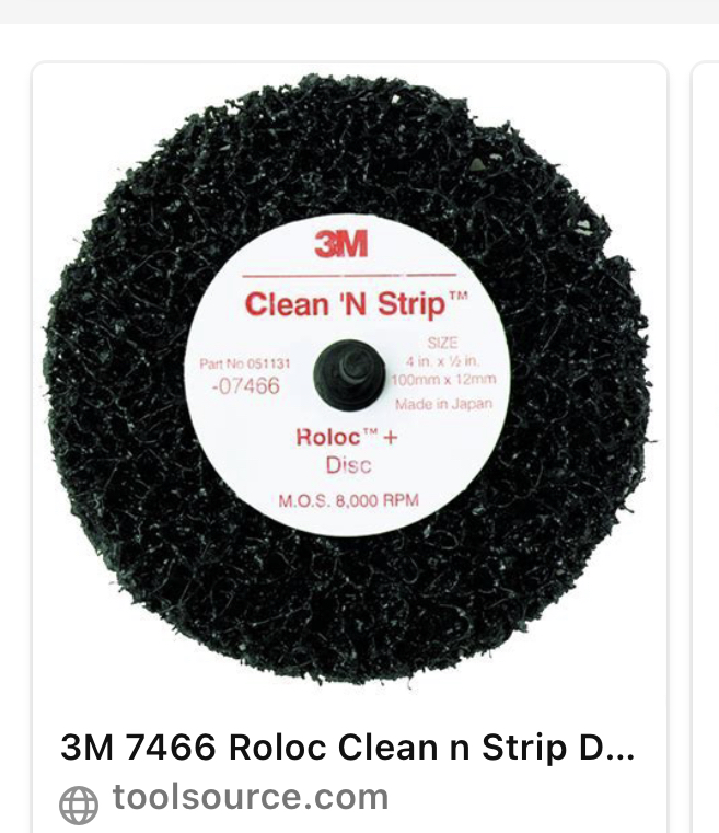

  12. ronzmtrwrx
    Joined: Sep 9, 2008
    Posts: 1,421
    ronzmtrwrx
    These will do the job better than the 36 grit grinding disc, in my opinion. They will not remove any metal in the process either.

    1. Hydro Tech
    I like the big version of the Scotch Roloc discs, fit in my angle grinder. Very very effective and don't produce as much heat as flap wheels or flat sanding discs, as the air can flow through the fibers of the disc.
    However, any method you employ with rapidly spinning abrasives will fill your neighborhood with white dust.
    Phil
