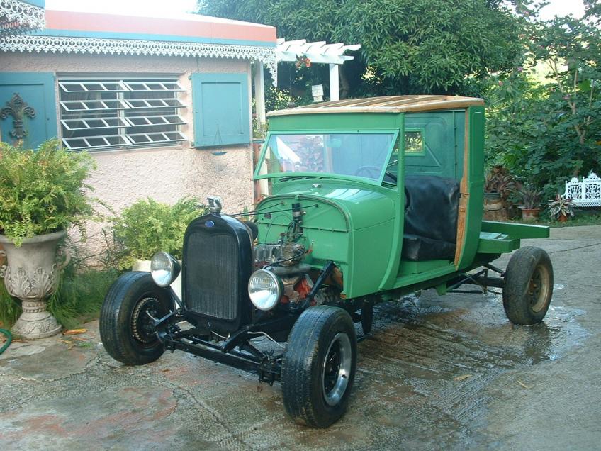

    Just got my 29 running. Was given a wrecked 2001 Jeep with a 2.5 4 banger/5 sp. Had a spare frame and said WHY NOT. Made a log manifold, mounted a 2 barrel Rochester, had FS Ignition re work the dizzy so it now has mechanical advance, a pick upand a coil. No sensors, no computer, and it runs sweet. Now I need to finish her and get it on the road. Ice man
