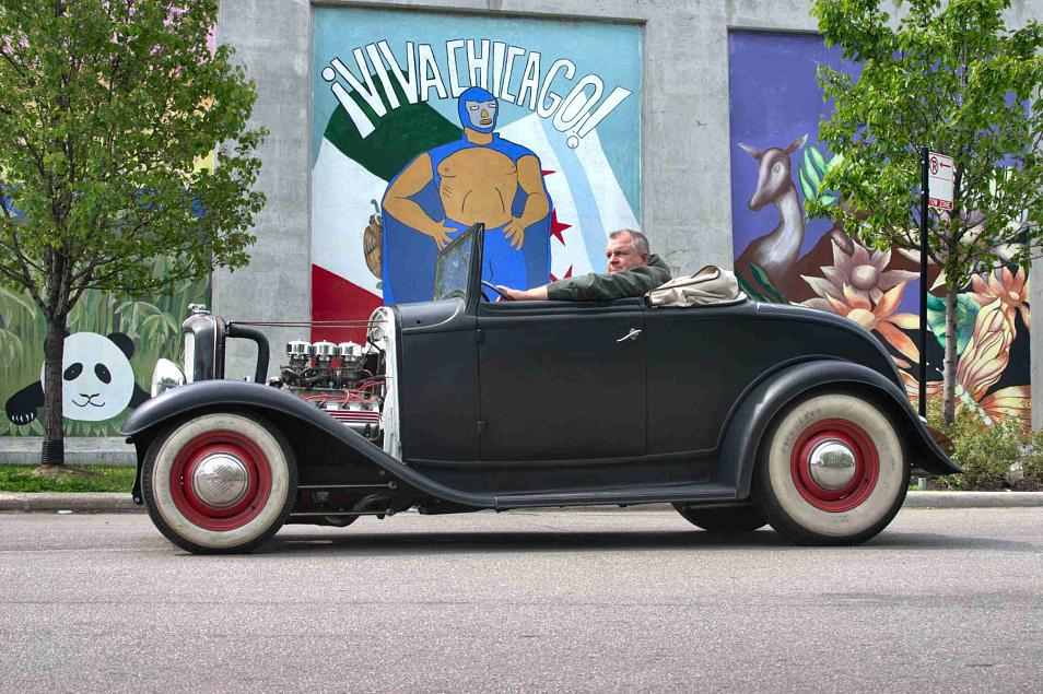

    E90EB8FD-6860-4028-8E82-D517C259EE64.jpeg Great little motor and I have Sanderson headers with straight pipes . We ran a 3x2 intake with 94s and ran off the center with a progressive linkage and it kicked butt.
    osage orange likes this.
