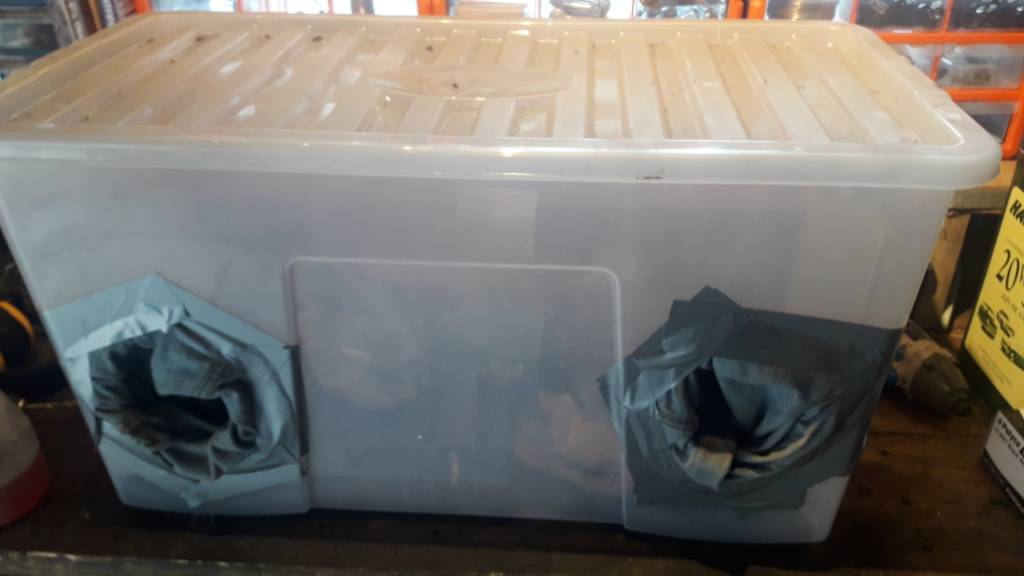

    How about a clear box, the legs from some old jeans and a pair of gardening gloves?
    Works a treat for what I need![​IMG][​IMG]
