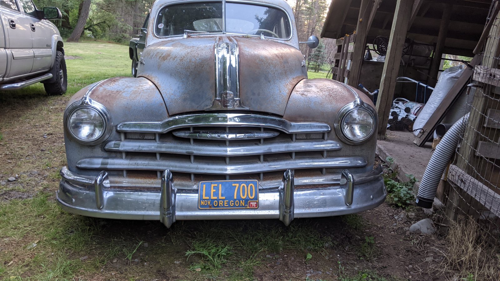

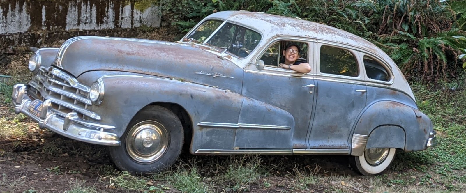

    We already have a few classics, all major projects, but my wife was driving through her old hometown for a cousin's birthday and spotted something she loved. She sent me a couple terrible nighttime pics and beat around the bush saying things like, "don't you think it'd be cool to have an older car like this?"
    I was coy for a bit, but could tell she wanted the car, but didn't think it reasonable or justified to ask for it, but hey, we only live once! Plus, if she has her own classic project, then she won't be able to call the kettle black quite so easily. Win-win. We(I) talked to the owner on the phone for a while to get a sense of its condition. He had apparently been preparing it for a 350/350 swap (I shuddered on the inside, but he's been a hot-rodder for a long time so I guess that's pretty normal). They had removed the driveshaft and crossmember, and a chain was holding up the tranny. An inline 8 still hung inside by a couple bolts with a dangling starter (a new starter, actually). He says he had the head off a couple years back, had everything oiled up, bores were smooth, and it turned freely. He had just lost interest in the project after considering his phase in life and his number of other projects that he was more invested in.
    We went back down the following weekend for one of my nephews' baptism. We set up a time with the owner just down the road, and were able to check it out. There were a number for pieces missing (speaker grill, headlight bezels, horn ring/center cap, glovebox latch, all three wiper arms, radiator, and fuel tank) but the car was otherwise original and complete. The seats had been recovered, but that was it. I crawled under and checked the rockers and floor pans--nary a pinhole to be found. There wasn't even any rust scale on this thing.
    I couldn't get the engine to turn by hand, or with a ratchet. Hmm...
    Further inspection revealed a firm brake pedal, and brand new rubber lines. I liked that a lot. The doors opened and closed like a dream, and all the windows rolled up and down easily. The trunk latch was disabled, something about the key not working and having a hard time getting it open the first time. He'd purchased a long 8V battery for it as well, though likely dead by now. All the hubcaps were present, and the tires held air for a week at a time. There was surface rust on some of the chrome, and pits in the pot-metal. The patina isn't objectionable though, and it doesn't sound like the wife wants to paint it in the near future, and I'm OK with that!
    I started running numbers for the missing pieces, and the owner and my wife chatted and discovered that my wife went to school with his daughter. Very small town, so it was no surprise. He was very gracious and agreed to a generous price reduction, so we had a deal.
    We came back the next weekend with the Silverado and a friend's tilt trailer and loaded it up. The owner was going to be out of town, so we said we'd leave a check in the mailbox. We ended up meeting his son, who hoped to work the old Ranger into the deal--no thanks. Great folks though, it was all a pretty pleasant experience, and I got to see some of their other projects in the shop. We swung by the wife's family's place on the way home, and one of the nephews was taken by the car, and compelled to pose for a pic. He'd just gotten his learner's permit, and I think the wheels were turning in his mind.
    Back at home, I encouraged the wife to step out of her comfort zone and back it off the trailer. It was her first "ride" on a tilt-deck, so there was much "encouragement" and a considerable departure from the comfort zone.
    Once that tail end landed, the concerns faded, and the ATF gushed out of the tailhousing sans driveshaft. Ah, right, the slip yoke. Whoops.
    Even the wildlife have now accepted it as part of the yard. We'll have to get a carport for it ASAP.

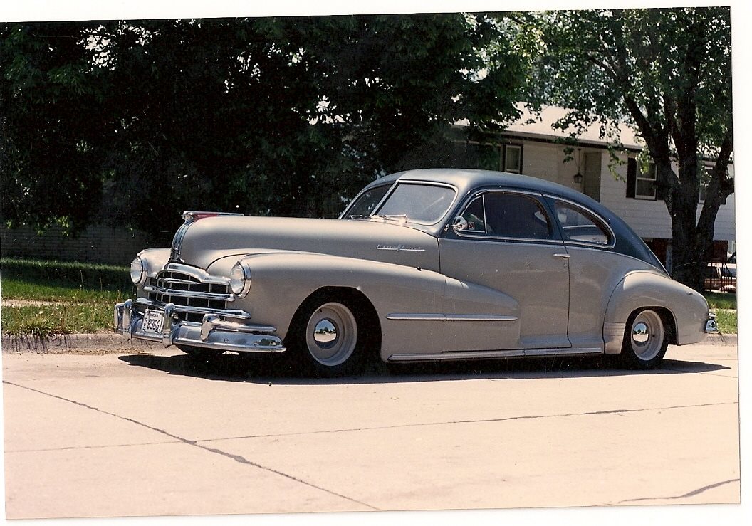

  2. Hey! It's the same colors [Blue Lake blue and Oyster gray] my 48 Pontiac was! 48poncho.jpg 48PONCHONSCOTTY.jpg 48pontiacropped.jpg

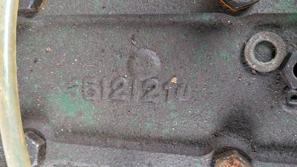

    I spotted some casting numbers, I'm not sure how informative they'll be. Hopefully I can find an engine stamping. The car sits at around 60k original miles, having not been on the road since 1976! It'd be neat to find out if it was a numbers matching engine.

    I might've found the engine serial, still haven't found the block casting number. I'm having trouble looking for a place to decode pre-1955 Pontiac motors. Anyone have a resource? PXL_20210528_051226672.jpg PXL_20210528_051334026.jpg

    I'm not able to decipher the prefix before 34121

    Thanks so much for the info! Do you think 34121 could be the engine serial? It was stamped instead of cast...
    Do you have a good source for the engine serials? I read somewhere that they didn't match engine serials to VINs in 48, but I don't know if that's true. If it is true, then there's no such thing as a numbers matching 1948 Pontiac. If there are numbers matching 48 Pontiacs, then perhaps our engine is already swapped. If so, maybe we've got the bigger 268 instead of the 249! Fingers crossed...

    Quick question, what is the difference between First Serial Number and First Engine Number? I'm unsure what they signify.
    I think it says 58-34121 on that stamping, which is on a raised pad at the rear left of the engine block. The formatting seems all wrong though.

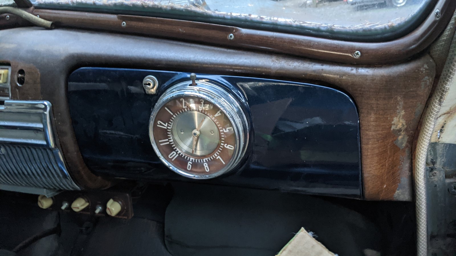

    We finally got a few minutes tonight to put some of the new parts on the car. I had to scrounge for some screws to mount the headlight bezels. Ended up finding some stainless oval head 10-32 that were 2" long, so I had to cut them down quite a bit. They appeared to be a good fit though.
    The bezels aren't perfect, but they're better than nothing.
    The wiper arms will need some work. One of the front ones has a busted rivet the seller didn't mention. Oh well, that's doable. I'm not sure what kind of wiper blades attach, how they mount, and what they're supposed to look like, but at least we have arms now.
    The shaft for our rear wiper seems tweaked--or at least the knurled knob that's on the shaft. I'm not sure how that's put together.
    I fished the radio up out of its abyss and was able to get it in place, though it won't stay. We got the speaker grille popped into place. Much better than the void that was there. Even got one with the appropriate 8 on it. Judging by the sun fade marks, the radio is missing a significant trim piece. And knobs and nuts of course. Anyone know what nuts those are, or where to get some? It'd be nice enough for now just to keep the radio from falling down.
    We got the new emblem mounted on the hood as well. The new one came without studs. Luckily I was able to extract the 73 year old 10-24 studs from the old emblem for reuse. Amazing.
    The wife swapped out the latch on the glovebox. We don't have a key for it, but I won't ever see the need to lock it. It has a pushbutton, it latches and keeps the glovebox closed, and now we get to see the lovely clock. I'm happy with that.

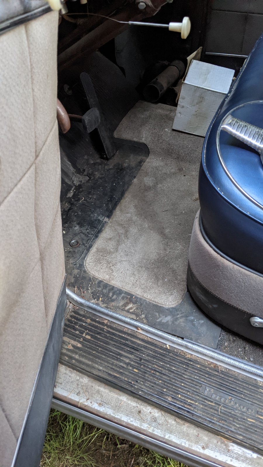

    And a shot of the floors, just to make some folks jealous. These should clean up nicely. Car shows 50K on the clock. I might just believe it.
