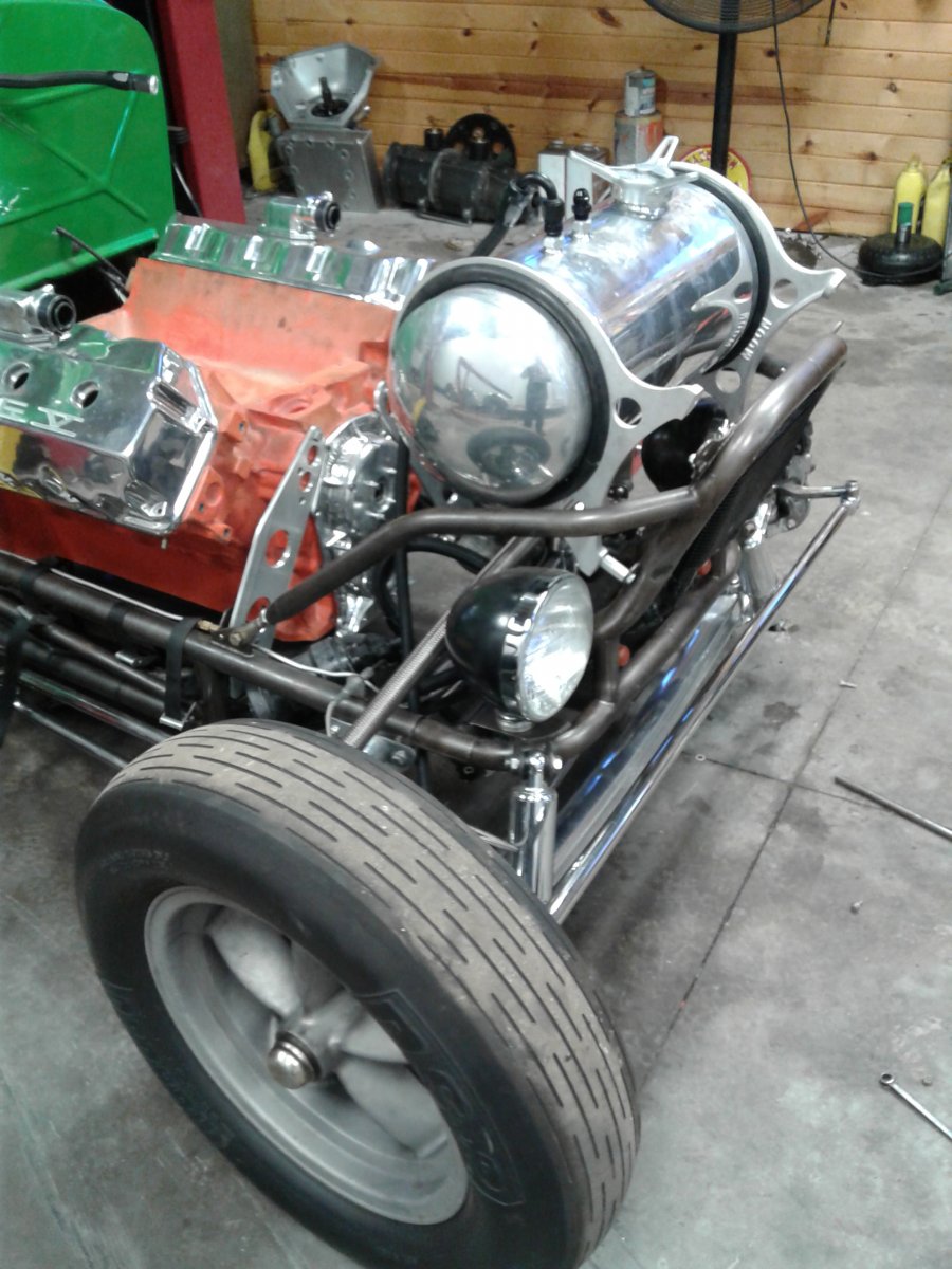

  6. The 19.6 gallon pump will place some stress on the delivery side feeding it. I upgraded the outlet on the tank and the inlet on the pump to number 16 fittings. I previously had number 12. The 16s are a inch on the inside diameter. I up sized the vent from a 6 to a 8. The tank is the same length but the width went from 8 inches to 10 inches. New hoops were purchased to acomodate the bigger tank. The new tank gives me 7 gallons now up from 5. Its a real possibility this still might not be enough capacity. New mounts need to be made due to the bigger diameter. Im playing with a few ideas this weekend. Theres alot to consider trying to get the tank mounted. The ideal location puts the tank outlet higher than the pump inlet. Its kind of busy at the front end of the car. I think i need to look at it some more before i start cutting and welding. It cant be stressed enough how important the fuel delivery is to the cars over all success. 20180310_174706.jpg 20180310_174825.jpg 20180310_174843.jpg

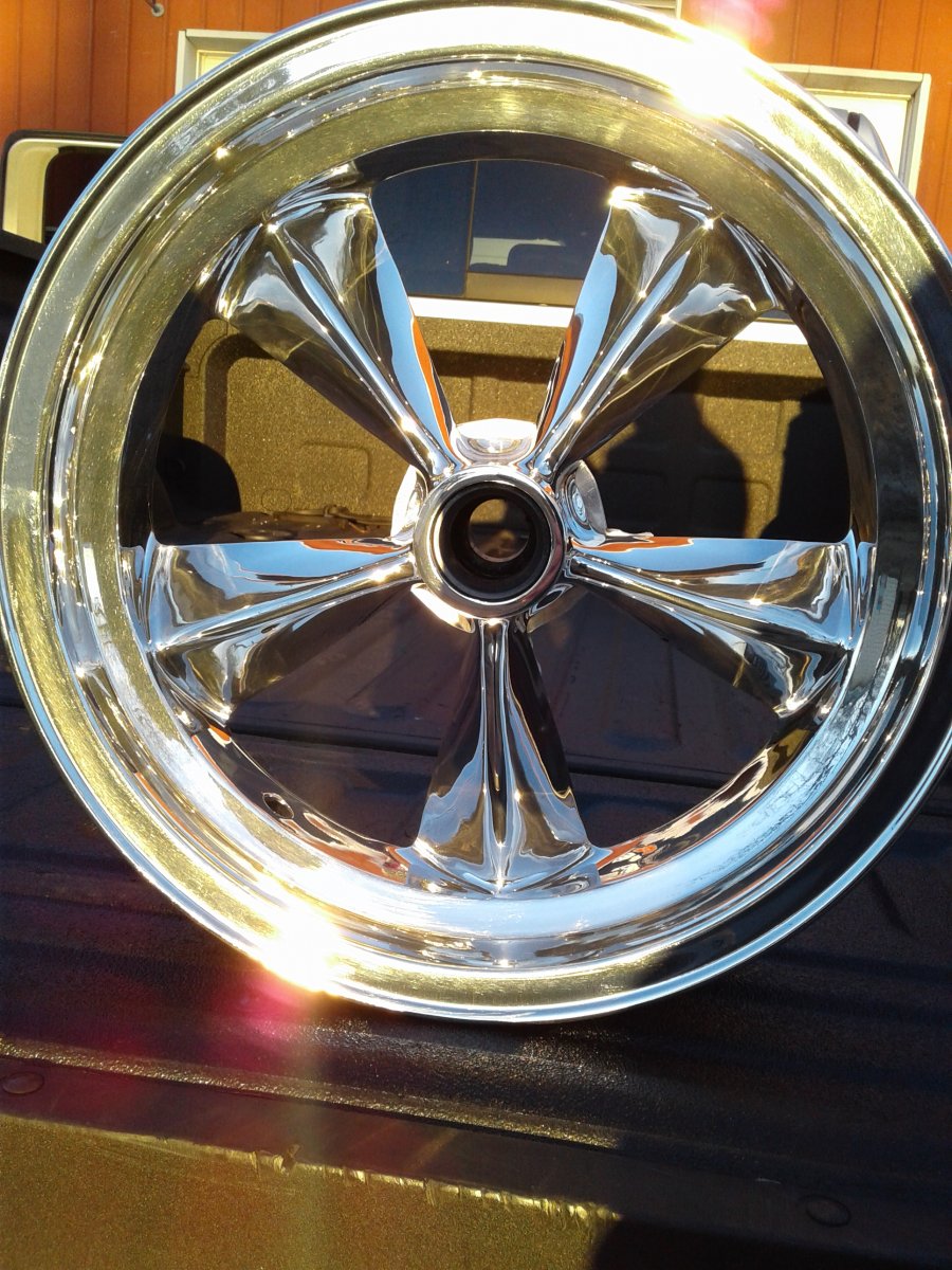

    All the wheels are now polished. The last one was dropped off yesterday. I like the look of natural magnesium. On my car i think the polished look is better. The polisher does outstanding work. 20180317_184107.jpg 20180317_184134.jpg

  20. All the wheels look good in the sun. The light was just right when i took the pic. These wheels twinkle like diamonds when they are spinning. Its a cool look. These are my all time favorite front wheels.

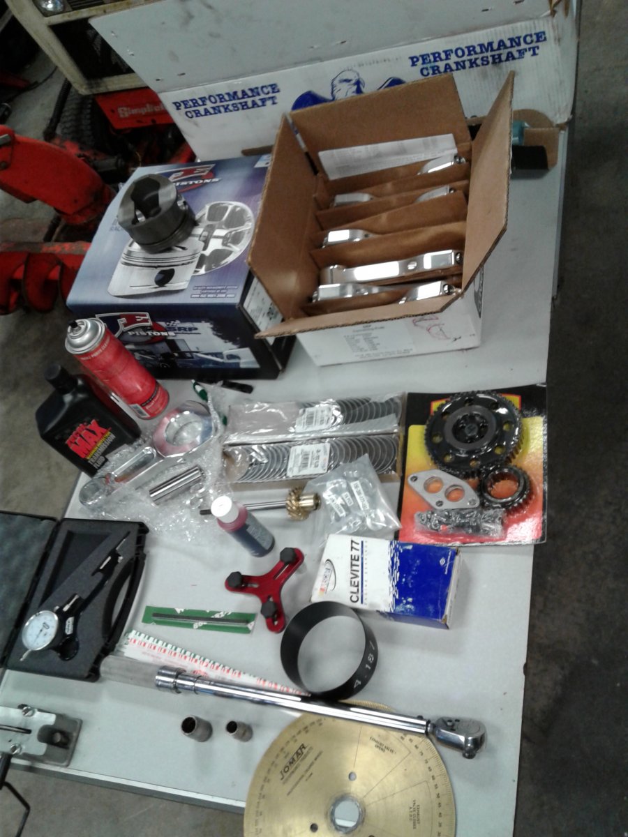

  22. Between call ins back to the hospital i was able to start putting some things together. It all started out good with the crank fitting perfect. Billet nitro cranks are ground with more clearance than stock cranks. Its right at .0035 on the mains and 8.5 on the thrust. It spins nice and smooth without any tight spots. The large radiuses on the journals can cause a problem sometimes depending on the bearings used. I use slightly narrower bearings to avoid that problem.
    I put a rod and piston in to set tdc. The rods hit the bottom of the sleeves. They dont have enough clearance. The pic of the rod shows a scratch on it were its hitting. The crank needs to come out so i can get at the sleeves with a rotary file.
    The gear drive cover is also not fitting. Its hitting the drive spud. I need a different cover or i need to make some modifications to it. Before i make a pile of chips i want to think on it tonight as to how im going to fix it. 20180318_170428.jpg 20180318_170451.jpg 20180318_201018.jpg 20180318_201051.jpg 20180318_201126.jpg

    Do the sleeves have to come out for that relieving? And, will you be relieving the spare sleeves the same? Earlier you mentioned being able to change them between passes if needed.
  24. No. They will stay in the block. I can reach the spot that needs attention. Its a lot of grinding and checking on the first one. The crank will be in and out several times. After i get one to fit then its just a matter repetition for the other seven. A wire is used thats .050 thick to reach the area i cant see. The spare sleeves will get relieved as well.
